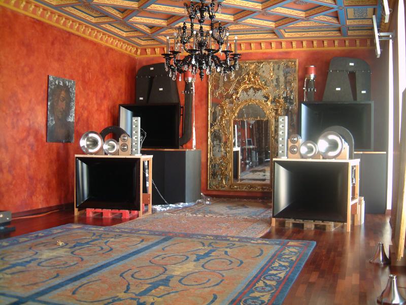

Check out John's paper mache horns:
inlowsound.com
We had small listening session few months ago and they were quite phenomenal. The most realistic vocals I've ever heard. They had a palpable quality... felt like you could get up and touch the singer.
John's system is quite big. The horns were big, the woofers were big and the subs were even bigger. The horns were being crossed around 400 Hz. He uses the JBL2445s which is a 2inch CD. It goes all the way to 16 kHz.
Anyway, just wanted to point out that this is being done a lot. A big CD coupled to a large horn can you down to where a large chunk can be covered by a single driver.
