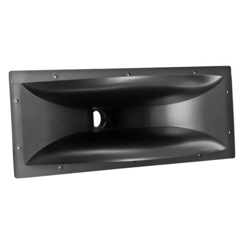

How would one calculate this given an unknown horn/cd waveguide with access to REW for example.
The reason I ask is I took a punt on some cheap wave guides from ebay £6.95 each including postage/shipping
but without frequency specification,
they are knockoffs but of what i am not sure of as of yet
33305 Plastic Screw Horn Flare Speaker Speaker DJ Music 420x160x210 mm | eBay
maniac sound system

Measure the horn/driver raw response, you will see a point where the frequency dips very rapidly, that is Fc, the horn cutoff frequency. Excursion will rise rapidly below Fc.How would one calculate this given an unknown horn/cd waveguide with access to REW for example.
cheers Weltersys
here is the waveguide in the link earlier
mounted to JBL 2426 RAW NO EQ
Black 500hz LR 48dB
RED 400HZ LR 48DB
about 650hz cut off I think
with phase at 400hz lr 48dB RAW
Looks like 600 Hz Fc to me.cheers Weltersys

By "raw" I meant no crossover filter (perfectly safe at 2.83 volts for an 8 ohm, 4 volts for 16 ohm, though a fraction of a volt is plenty to test response), but the 400 Hz steep filter is low enough to see that the horn/driver response has gone south below 600 Hz.
The driver should be safe with a 1200 Hz crossover of 12 dB per octave or more, but the horn's vertical pattern that low will be a lot wider than the 15", but polar response is another issue entirely 😉.
The multiple phase wraps in your last post are due to an incorrect delay time.
