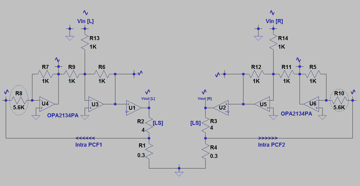

THRESHOLD S/150 Using Positive Current Feedback
The attached is a simple schematic for the subject amp. I no longer call it a compound amp. Because it lacks the power transformer [see past 2 posts] which enabled cross-talk between the two power amps, and further embodies Intra PCF instead of Inter PCF.
Here is the method to determine the value of the encircled resistors [5.6 K]. This resistor determines the extent of acceptable/safe PCF; meaning to prevent each amp from oscilllating. A resistor value of 3.3 K caused oscillation!
1. I replaced the 5 Amp Fast Blow output fuse in each channel with a 1/2 Amp Fast Blow.
2. I progressively lowered the value of the encircled resistors starting with 100 K. I used the standard values of [82K, 68K, 56K, 47K etc ] down to 3.3K. At this point the 1/2 Amp fuses blew.
3. Each amp was stable with an encircled resistor value of 4.7K. I chose 5.6K for added precaution when I restored the original 5 Amp output fuse.
This is a great sounding system.
I experimented with the following variables:
1. No transformer, a 115Vac:115Vac transformer [VPT230-110], and a 24Vac:24Vac transformer [VPT48-520]. I used VPT48 normal secondaries for this function. Bass loudness followed the trend VPT48>VPT230>no transformer.
2. Intra PCF versus Inter PCF with the variables of #1. I favored Intra PCF
3. PCF versus none. I favored Intra PCF or Inter PCF over no PCF. Bass was tight and detailed with either PCF.
With the exception of the subjective results of #3, the circuit variations due to #1 and #2 gave fully acceptable subjectives.
