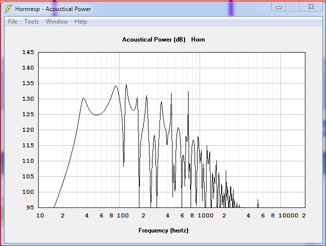

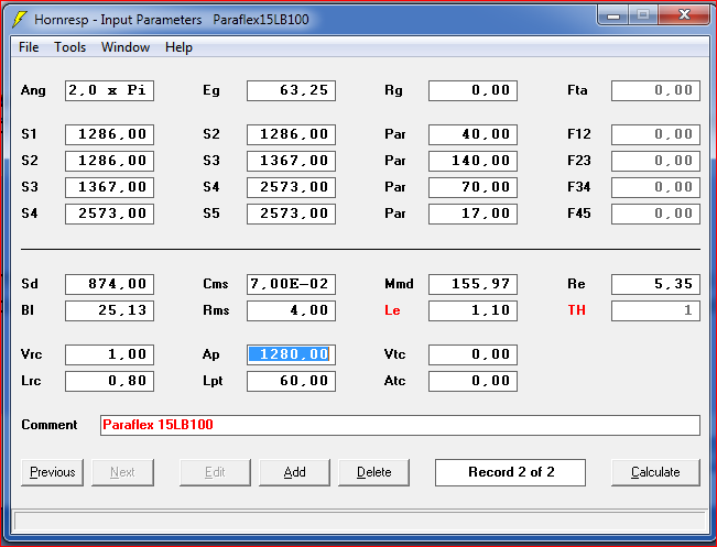

I tried to sim it with x=43,6cm from your first sketch and came up with this (see attachment).
And no, this sub isn't intended for PA, it's, as you said, to be used muli-purpose: for my living room/office, for small parties in my favourite watering hole, ...
You are welcome Gerald! :happy2:
The Hornresp inputs shown are for the 84cm width cabinet .... Your CSAs are all 51.25% of the CSA figures shown in those inputs .... So just multiply the S1 through S5 CSAs by .5125 to get the right figures for your cabinet =) Also be sure to activate "Lossy Le" mode for more realistic results ..
