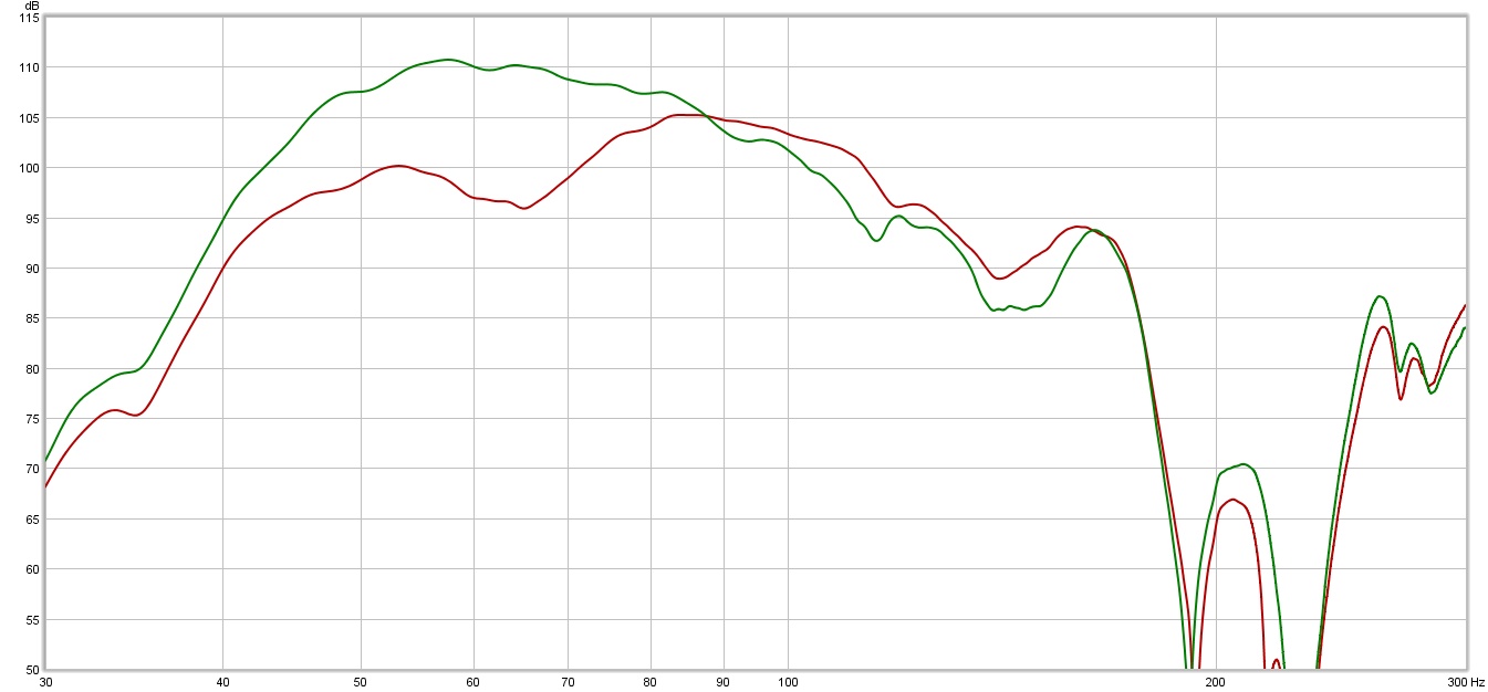

![2X4mätibilstol-framme.jpg 2X4mätibilstol-framme.jpg](https://www.diyaudio.com/community/data/attachments/592/592945-e3d4c9de5c3c4ef1f8a4536a5c7ef423.jpg)
Here is some measurements inside my car (Hyundai Getz) with the ROAR12 laying facing backwards.
The red line is with the microphone where my head usually is.
The green line is with the microphone near the front window on top of the dashboard.
Since your 8th order Super Planar shares many attributes with the ROAR design I would guess they both behave and sound quite similar in a car cabin.

he says the useful response seems to be extending lower than our simulated graph would lead us to believe, and the big hump seen up in the 60hz to 90hz range isn't as obnoxious as you might think... He says it is very musical
This mirrors my experience quite well. I can't see any "extending lower than our simulated graph would lead us to believe" in my measurements. I believe the sheer unhindered power these devices produce tricks us that there is more extension then what we measure. Many people have commented on the "deeper then the sim" extension of my ROAR, even though my measurements does not support this. Normal continuously expanding tapped horns tuned to the same low frequency response does not sound the same.
Something strange is going on here and I am very curious what it is.
I hope you can post measurements from this build so we can compare with the Hornresp sims.
I believe you will find the same perplexing disparity between the measurements and the subjective experience.
Johannes
I'm guessing there is a 40hz high pass in this graph?

USRFobiwan and Johannes,
I believe that when Mario was speaking about this subjective presence below Fb he is making a comparison in reference to the simple old cabinet (the one which the Super Planar 8th replaced), it was loaded with the same 15" driver ....
Perhaps just some illusory effect as Johannes is suggesting....... An in-vehicle response measurement may just show a curve that looks a lot like what the simulation produced with very little going on below 30hz, we shall see, but we have no reason to expect anything different than that ..........
As fantastic as it would be to discover that there is some mysterious minor loading going on below Fb , we just don't have enough evidence of anything like that happening, at least not yet ............................. Although, with that said, i have observed something strange along those lines years ago, but that was a completely different multi-resonant design (i posted about it earlier in this discussion) ...... So i am not going to say that it is impossible, just unlikely.![tongue :tongue: :tongue:](https://files.diyaudio.com/forums/images/smilies/tongue.gif)
