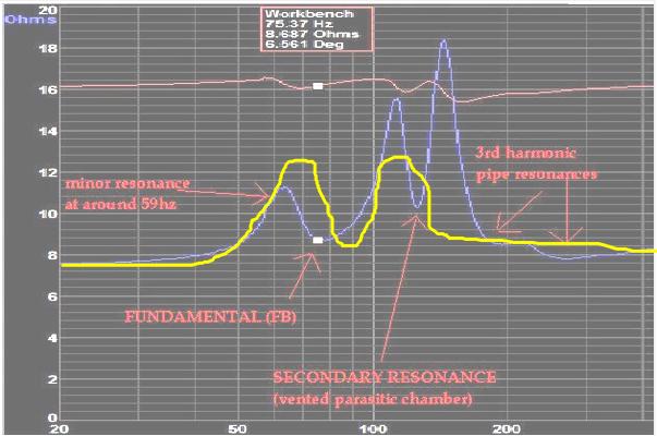

Originally Posted by Matthew Morgan J
Imagine the two impedance peaks as you would see in a bass reflex (single Helmholtz) except that the upper peak is split in two by our parasitic resonance so that we end up with three peaks now
Yeah i realise that 😉
But i was wondering about why the f-Low impedance peak is as low as it is, inspite of the design goals "front box" fb being higher than shown ? Without the extra DCR volume, eg BR/TL etc, the f-Low impedance peak should be higher. That's why i thought the fb of the "back box" might be influencing/dragging the "front box" f-High impedance higher ?
If you see what i mean ? If not i'll try to expand on it 😉

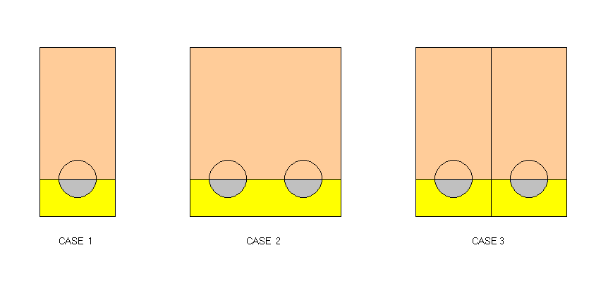

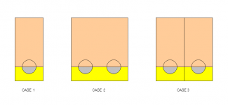

Hi guys,
one question to this drawing:
Does the round front part have any acoustical effect like, say, forming some wave guide?

To "wave guide" waves, the guide must be acoustically large, the pictured "wave guide" could reduce turbulence, but little else, and the reduced area, dead space, would reduce SPL.Hi guys,

Yeah i know about the "60hz with the upper peak at 130hz" stuff, Thanx 😛
Sorry, but i'm still not being able to get you to understand what i meant !
Unless i'm mistaken, who me ? LOL, i'm sure you said that you planned for a higher fb in the front box. But it turned out to be lower than expected ? That's why i wondered if the DCR fb was affecting the front box tuning in some way. If it has, then that "might" account for the far left hand peak being lower in height & frequency than i would have expected to see, & the dip straight after that lower in frequency than i would have expected to see

Pondering the Mysteries
Zero D , we are going to get through this! hehehehe
The Fb wasn't the shocker so much ..
The thing that REALLY astounded us was the fact that the bass extension was reaching much lower than we had expected (underneath Fb)...
The Fb itself ended up being not too far off from what we were shooting for (just slightly higher than our target which must have had something to do with the DCR inspired section of the cabinet) ........
Nevertheless we experienced an intriguing amount of extension below Fb , but why? Did this also have something to do with the parasitic resonator section?? ...Perhaps.......
The roll-off was also expected to be very sharp, but it wasn't at all, instead it was rather shallow and musical , and yes it was all AS IF the Fb landed much lower , but it didn't, it was actually just a few hertz higher than our target... .
So there were definitely some mysterious surprises, but at least they were pleasant mysterious surprises of the highly fortunate type 🙂
The little squiggly anomaly that can be seen riding along the western slope of the lowest impedance peak (easier to see in the second screenshot that i posted in #186) indicates that something strange was going on, and considering the bonus bass extension that we were getting (along with well controlled cones) it makes me wonder if we had (by mistake) somehow generated a kind of lesser resonance down below, as in a weak or "mild" phantom resonance around the 56hz to 59hz range ....... It is just a guess of course, highly speculative stuff, but this is currently the best theory i could muster up to explain the weirdness that we observed
If i could have known about the amount of bonus extension that we were going to get below Fb i would have made those MTM-DC-MLQWP towers several inches shorter in order to tune them higher .. ... No need for so much overlap with the subwoofer in my friend's Home Theater system .....

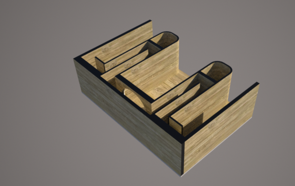

A modification to the layout
GKH, Samuel, BP1Fan , and Johannes,
We are working on a modification to the B&C cabinet's layout in order to maximize the use of internal volume here (no more wasted space) .....
I am posting a few rough sketches (below) so you guys can see where we are going with this.....There are a few different ways that this design can be adapted for different path lengths while remaining efficient in it's usage of volume 😀.... ....
and here again (below) when less path length is required .... The 8th order cabinet for the B&C will look more similar to this example....... The small CSA section of the main path on the 32hz tuned cabinet only needs to be in the 190cm to 200cm-ish range ...
Dustin is working on the 3D drawing ... He does such lovely work
