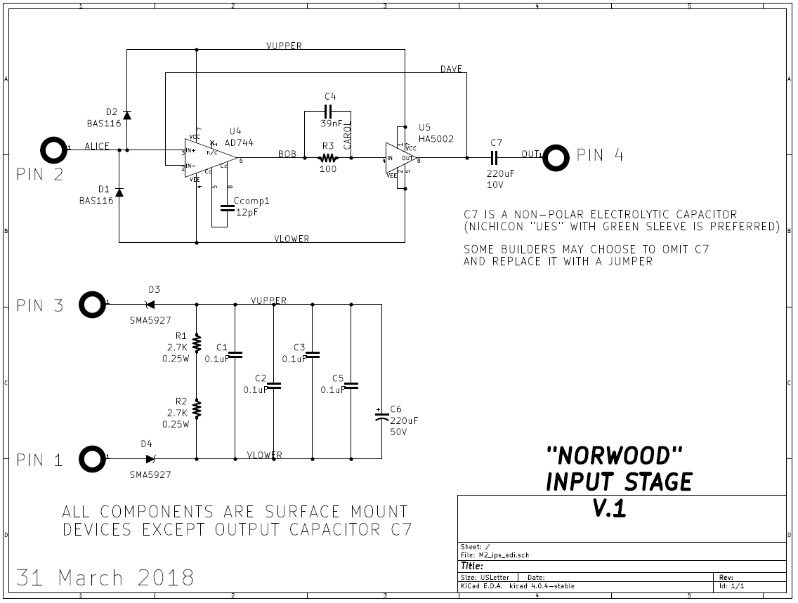

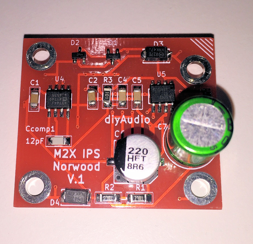

The diyAudio Store sells PCBs for a 25W Class-A power amp designed by Nelson Pass; it's called "M2x". The PCB features removable, interchangeable daughter cards which implement the input stage of the power amp. One of those interchangeable cards, called Norwood, is a composite amplifier. It consists of an AD744 (externally compensated, JFET-input opamp) followed by an HA5002 video buffer. Schematic below. People who have built and listened to the amplifier, appear to find the sound of Norwood very pleasing. In plenty of cases, more pleasing than any of the other daughter card circuit designs.

Yes Mark, id like to try that combo in the near future coupled with the input upgradability of the ne5534. A nice combo would be the buffer, smd signetics 5534 and a super pair bjt in soic package. The footprint would end up being only as big as the buffer is, or as small.
I wonder how 5002 will behave if i take the output from pin 5 of the 5534 which i believe has 2v offset?
