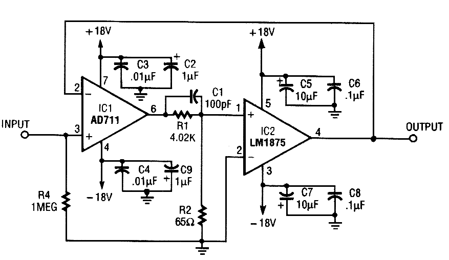

I’m no expert in composite amps but here are some thoughts:
  • multiple stages with one feedback loop will be very sensitive to phase shift in the loop, perhaps an opamp wih more gain bandwidth is necessary
  • the LM1875 is stable at gains >10 but this apears to be at unity
  • what’s up with the R1 and R2 divider?
This isn’t configured like any of the other composite amps I’ve seen tried. You may be too far off the beaten path.
You really need a higher closed loop gain, say 20 or even 40. You probably also have another undesired pole in the response with that 1M input bias resistor working against the input capacitance. Reduce that to under 10k. You may also need to experiememt with C1.
Each amp is introducing phase shift, the total will usually be more than enough to oscillate unless you compensate or arange that the LF and HF feedback paths are different, keeping HF feedback as local to each stage.
You attempt to add a low pass into the feedback path increased the phase shift even more round the loop!

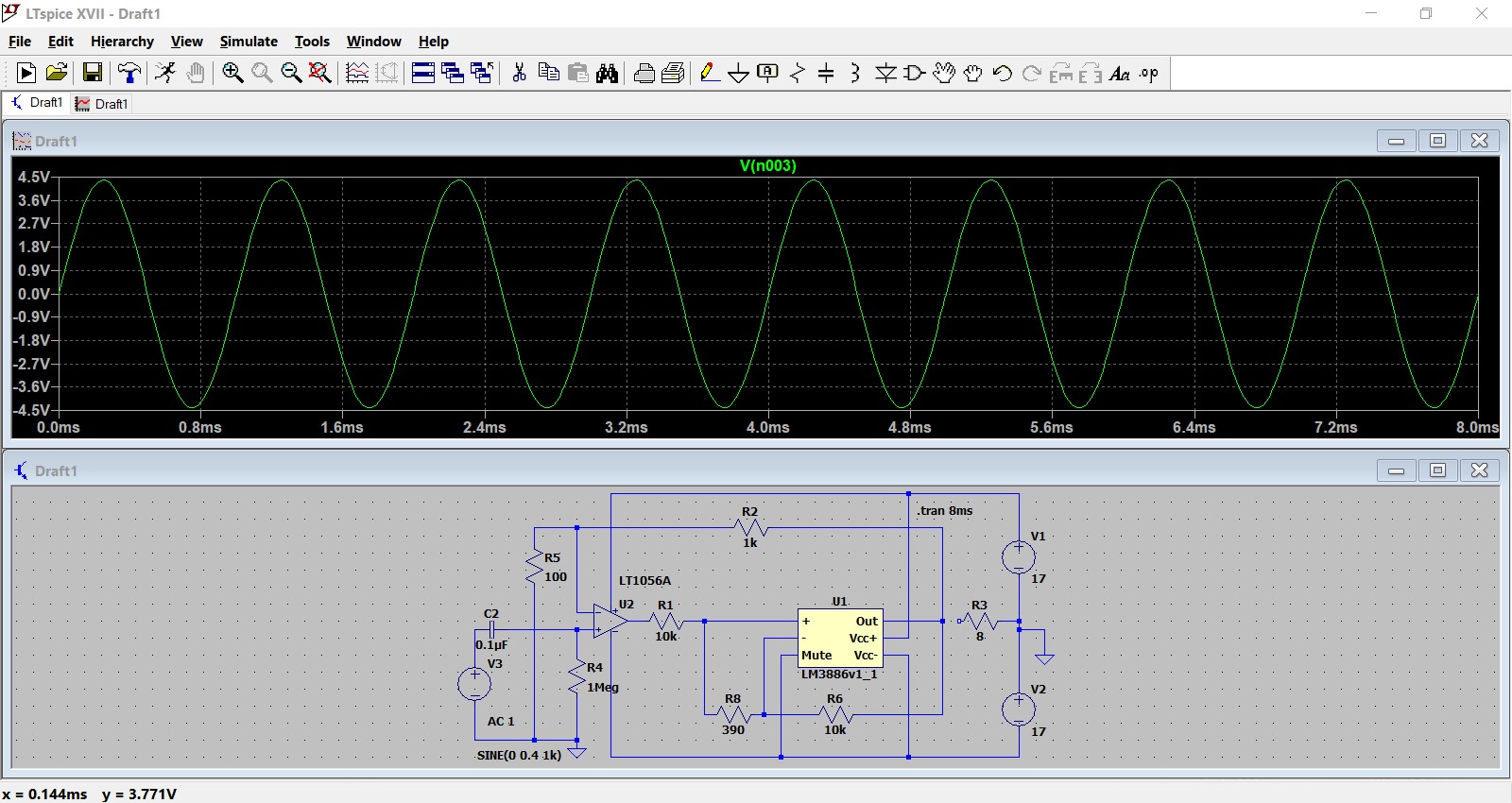

The inverting input of the LM1875 is connected to ground. How is that supposed to work?
It just looks all wrong somehow.

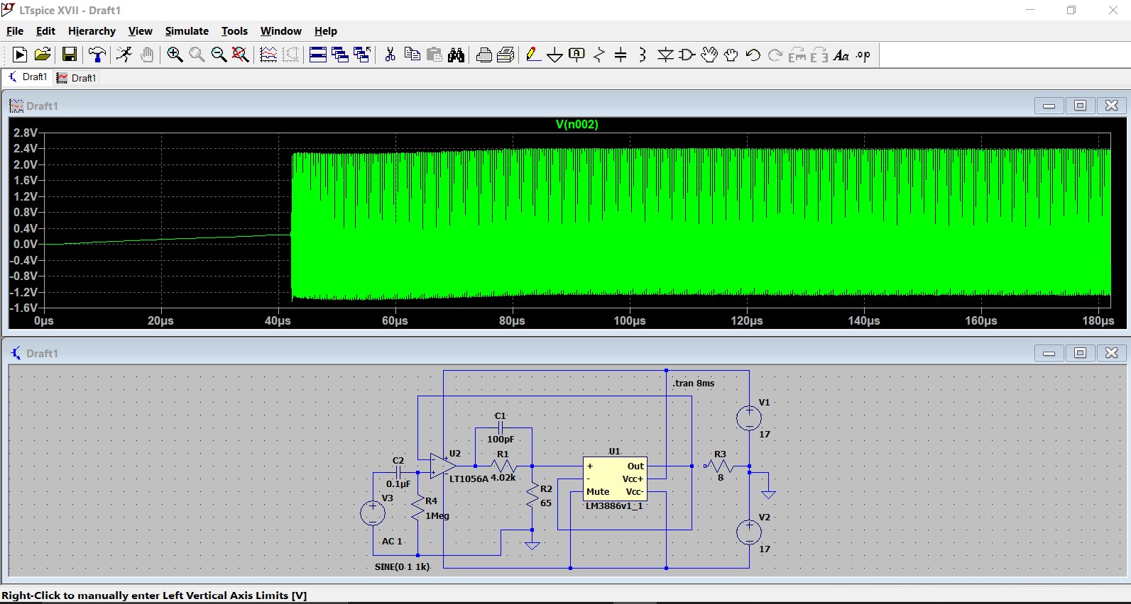

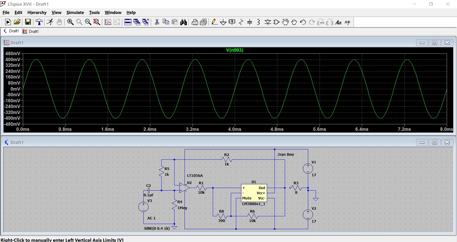

If you want to run the LM1875 at unity gain then you have to fool it into thinking its still running at a higher gain by increasing the 'noise gain' of the stage. Look how the feedback is connected in my example.
The output chip is now running at unity gain as far as the signal is concerned.
Wrapping another opamp around it all complicates it yet again and you would have to see how it behaved with real components, however the simulation works OK.
If you want the whole stage to have voltage gain then alter the values and configuration around the opamp as shown in the last image.
