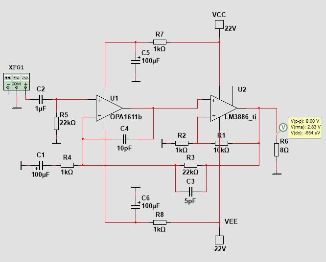

Composite amplifier: LM3886 + LME49710

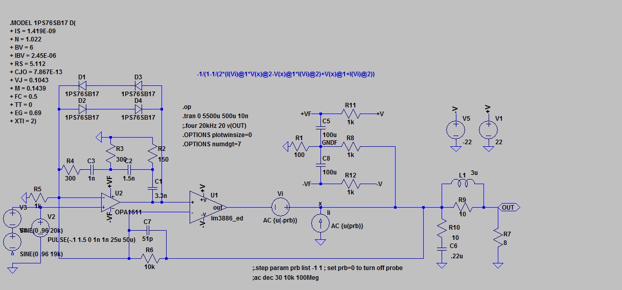

well, the neurochrome presentation tries to show the best possible result, while the presenter here dares to show the worst case result.
Presenting in the same way, that is a full spectral display of the performance of the modulus amp at 19+20kHz --could surprise some here.
Showing here the most difficult case is just courtesy to the reader, directly cutting through to the heart of the problems.
The same for the time response plot.
having applied a 1nsec rise/fall time excitation without any input RF filters to a band limited composit loop -- needs courage & self confidance.
In that response one can observe as the system enters/ exit slew rate limit, and picks up the control with relative smoothness.

But, it is like trying a Ferrari on a landing strip..
Tom could have serious reasons of having decreased max possible performance in exchange for robust stability in real life. And a robustly stable system could sound much better at home than a finicky, but brilliant lab performer..
Why +_22V power supply? that's a serious limitation for an lm3886 amp..
also, ~18Vpp performance is nice to see, but max power lies around 60Vpp..
Then, I did not open yet the lm3886-ed spice model - what is the confidance level, are there real life tests validating, is it derived from the official model?

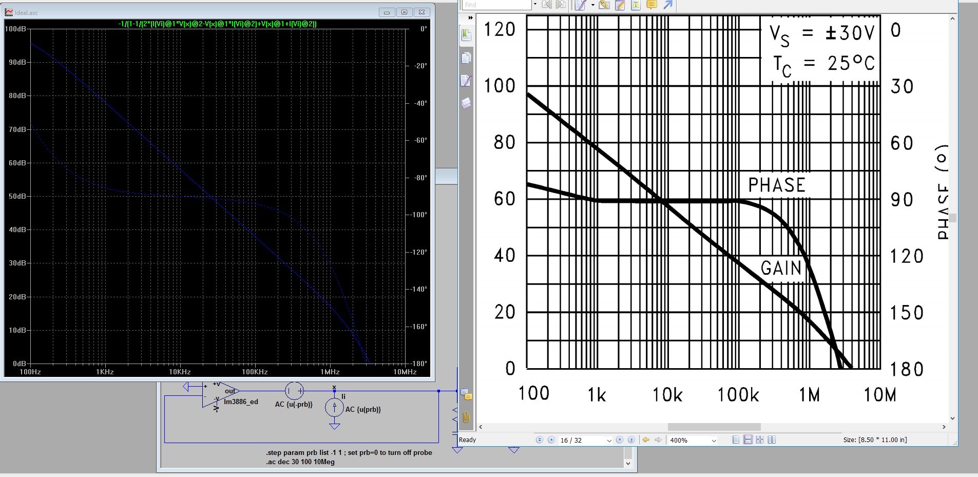

the official models L1875 and LM3886 are complete crap
