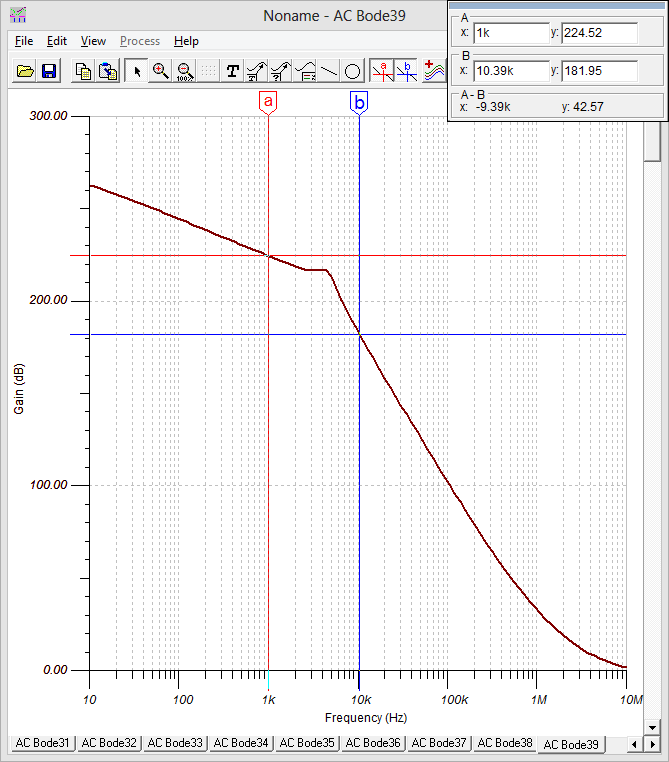

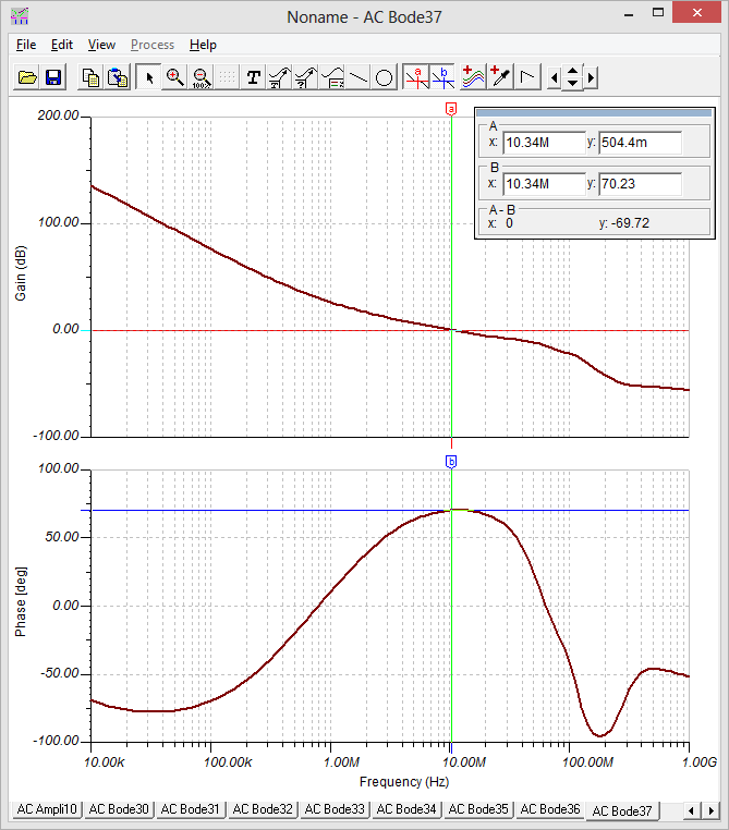

Schematic shown below represents my vision of this device. Values, and schematic itself are not optimized yet. Output stage is quite a simplistic one, but at the same time this simplicity allows to use inclusive compensation up to quite high frequencies.
Bode plots show phase margin of the guy and total depth of negative feedback around output stage.
Will be interesting to hear if anyone has similar thought, and potential suggestion how to improve it.
