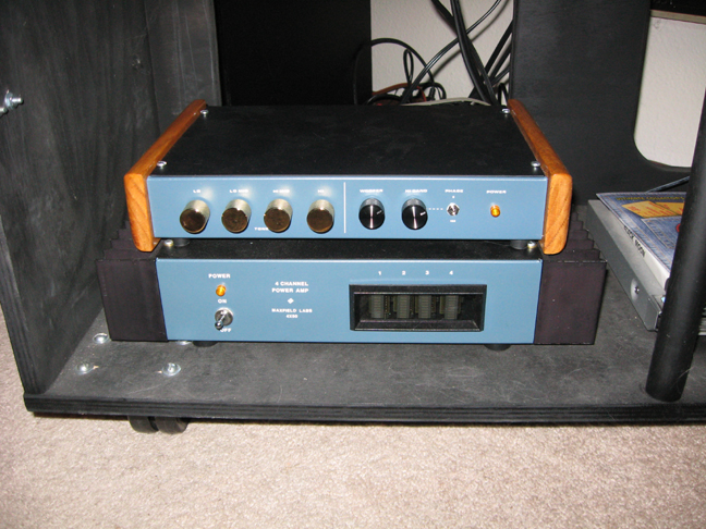

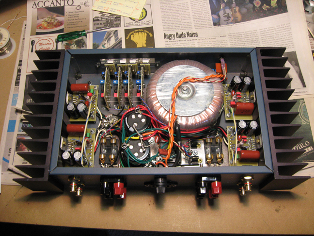

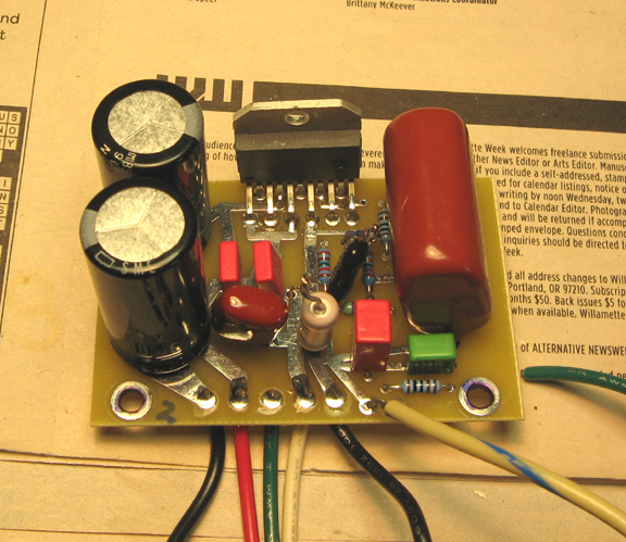

I built a 4 channel LM3886 poweramp and am very happy with it. Especially the no transient feature when you turn it on or off, so direct connection to a tweeter in a bi-amp arrangement is no problem (as it is with most other amps). It's about as simple as a power amp project gets. Phase margin/stability is an issue with any high gain negative feedback amp circuit. If your time is worth much, realize that you will be investing quite a bit of time into this, so build something that you will really appreciate for years to come. My 3886 amp delivers 50 watts rms into 8 ohms, with a +/- 32 volt power supply, which in my opinion is the least that I would want. You can squeak by on 10-20 watts if you never want to turn it up above "room volume" (just loud enough to hear everything well), or if you have very efficient speakers. Just remember that the reason low efficiency speaker drivers are so popular is because they sound better. Otherwise they wouldn't sell. There may be some rare exceptions to this, but there will be tradeoffs (such as price).
