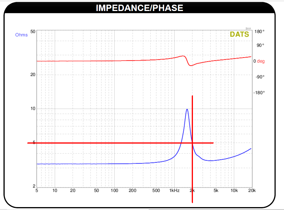

not to hijack a thread but i can't find a straight answer on this. i see a lot of people installing a tweeter in parallel with a midbass speaker, using "bass blockers" (capacitors) in series between the tweeter and mid bass. both speakers are 4 ohm. my question is, since the mid bass does not have a crossover on it, wouldn't the impedance of that "component" setup produce some odd values at frequencies above the bass blocker? trying to determine the what impedance the amp would see for wattage calculations. thanks in advance for your response.
Speaker impedances are always at odd values, it changes with frequency.
I know it's hard to do so, but let go of the notion that a speaker is either 4 ohms, or 8 ohms, etc. It's dynamic, and the impedance will change with frequency. That's why you're not getting a "straight" answer. The beginning of a straight answer is buried in that long winded, boring post post you quoted. Impedance and power calculations are much more involved than a single number.
Assuming the numbers quoted above are accurate, think about the 2000 Hz example. The tweeter + capacitor have a combined impedance of 12 ohms, right? Your midbass has an impedance of "4 ohms", so the parallel combination *should* present a 3 ohm load to the amp. I think that's the straight answer you're looking for, but it's not that simple...
Look at the impedance plot below. This is a typical midbass driver impedance plot. Look at the impedance at 2000 Hz. It's not 4 ohms, it's more like 5½ ohms there. So, with this driver, we're now looking like 12 ohms in parallel with 5½ ohms, which is ~3.77 ohms.
But wait, we're not done... the tweeter has a similar impedance curve... again, here's a typical impedance plot for a 1" or so dome. We were looking at 2000 Hz, so looking there, the tweeter is 5 ohms at that point. OK, so now it's 5 ohms in series with the cap that's 8 ohms, for a series total of 13 ohms, which is in parallel with the 5½ ohm woofer impedance. Net impedance to the amp is still going to be just under 4 ohms, but you see that all of these values are constantly changing.
You mentioned frequencies above the bass blocker... Go up to 8kHz and the cap is 2 ohms, the tweeter is about 3.75, but the woofer is about 12 ohms. Net result is around 3.9 ohms there. The good thing is these values tend to move in opposite directions and the result can be reasonably consistent.
So the point of this long winded answer is to yes, this produces odd impedance values, but that's totally normal in the world of audio. If the speaker manufacturer or distributor provides data files, you should be able to load them into a simulator and get accurate Z plots to see the changes graphically.
