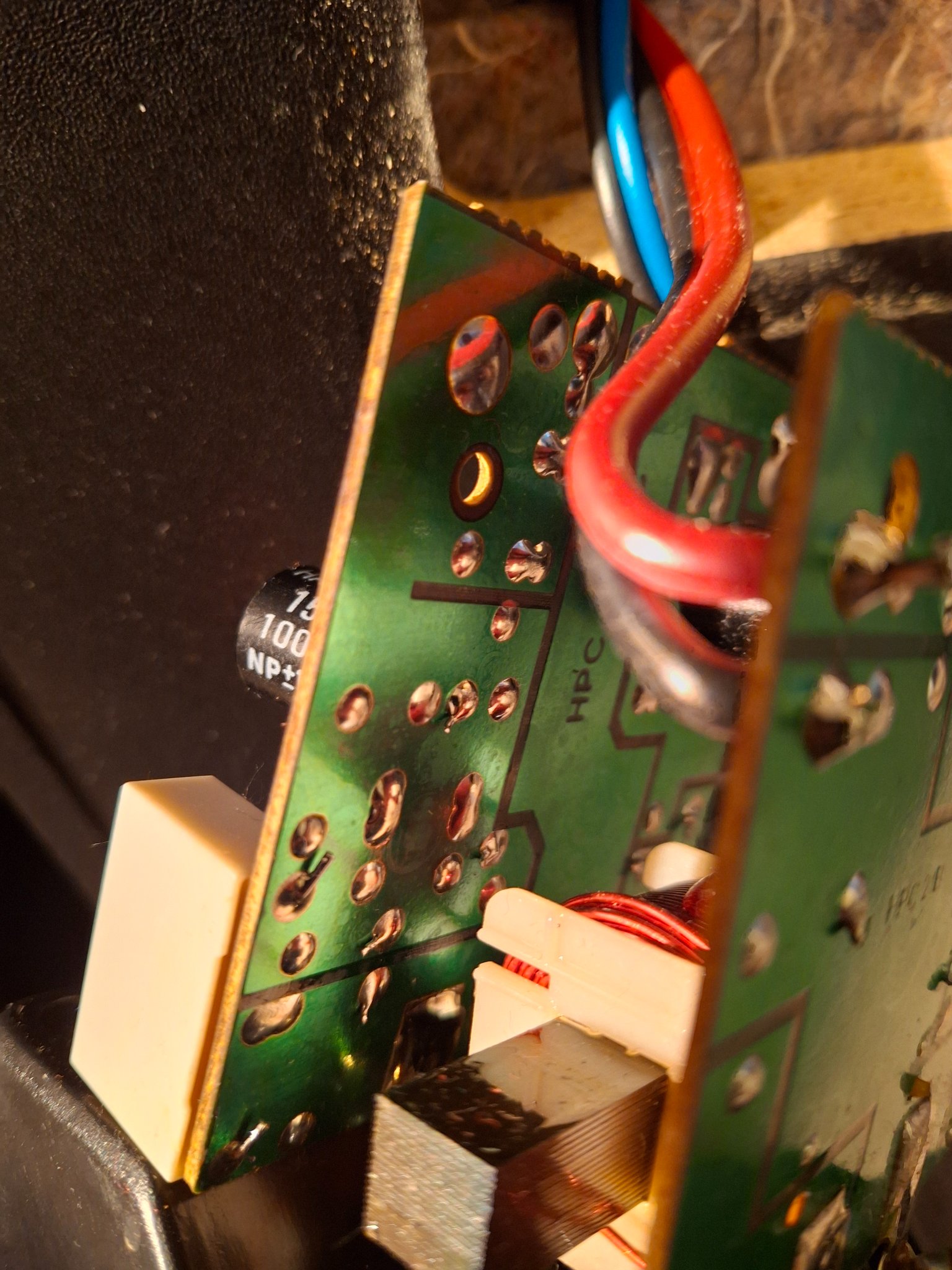

I need help identifying a component in a Mirage M-290is crossover.
The component in question is the white block in the right bottom corner (first pic).
Anybody having the crossover schematics, by any chance?
I would like to upgrade the crossovers, to what extent should I go?
Caps are 4.7, 15 and 22..., currently Hanlan.
(will replace the steel nuts on the terminals, but the steel strips will remain, unless there is ingenious way to replace/bypass them )
Thx

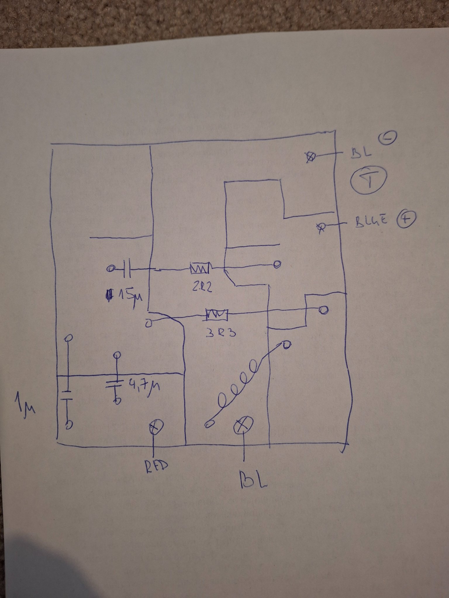

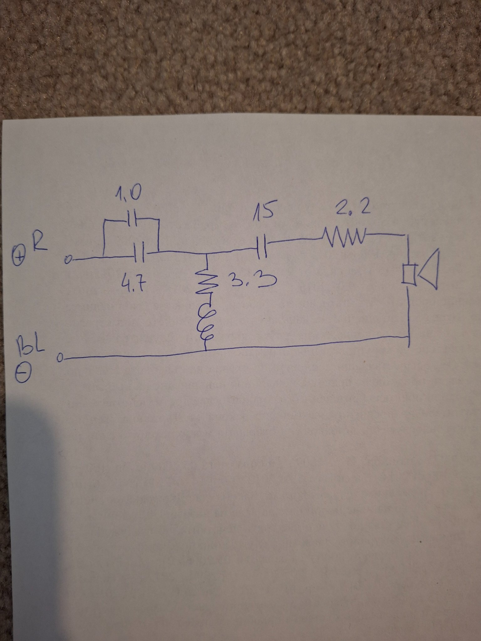

Tweeter board layout (pic1)and my interpretation(pic2)?
I'm assuming , I could replace both 1uF and 4.7uf with one cap 5.6uF?
The 15uF would be a challenge due to the size of equivalent polycap. Resistors will be replaced.
The terminals have some attraction to magnet, negligible to the strips.
Thx
