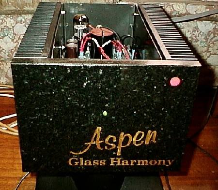

The Zout of my Glass Harmony SE stage using a bipolar/mosfet CFP is 38 milliohms, measured at 1KHz, 40Vpp into 8R. Up to clip, the sensation of power on just about any speaker is monomental. My AKSA 100W Class AB struggles to give an impression of power like the Glass Harmony, and the AKSA is often said to sound like a 200W amplifier in this regard.
I believe the Zout is dominated by the Rds(on) of the mosfets, the limiting factor. The reduction of open loop Zout to such low levels is largely the result of the huge local feedback around the CFP. I run a parallel pair from a 50V rail, 1.4A continuously through each. Output is capacitively coupled, through a carefully configured electro/film cap. With the tweeter directly supplied from the output rail (which sits at around 25V) via its crossover cap, this really is one of the best amps in the world, but I am appalled by its inefficiency, and have withdrawn it from the market. I have attached a photo of a monoblock.
