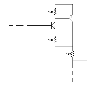

Anyway, the reason because I wrote that I need some help regarding this
complex emitter follower I found in JLH's amplifier design book. I wasn't
seelpingThe first BJP is a simple emitter follower I understand this. The DC offset
between its base and emitter is around 0.6 Volts or so and I can bias the
output by implementing a proper voltage across the 0.22 resistor. So the
bias would be lets say for 1A*0.22Ohms + 0.6 V = 820 mVolts. But what is the
function of the other transistor? In the book it was meantioned as an
alternate and superior version of the simple darlington structure, so I
assume the first transistor would take over the task of a first BJT in the
commercional darlington leaving the real work - providing the dissipation
for the 1A - to the second one. But how does this 1 Amp divide up between
the two transistors? The first transistor has a resistor between the power
supply and its colletor providing some voltage wich is - I think - definitly
0.6 Volts or so beacuse of the base-emitter drop voltage of the second
transistor, wich is paralell with this resistor. Also in the book both the
emitter and the collector resistance had the same 100 Ohms value. In this
way there should flow about 6mA (0.6/100) across the first BJT leaving 994
mA to the second BT. (Assuming that the emitter and collector current is
equal.)
to much last night beacuse I was wondering how this can work at
all, how does it the trick JLH meantioWhat I do not understand is:
This topology is implemented in many applications as the final stage wich
drives the speaker, so the whole signal voltage is apparent at the base of
both BJTs. I just can not see how could then the second BJT work with the
whole signal without any emitter voltage potential. (Emitter connected
directly to the power rail.) As I see it should cut one half of the signal.
Or the second BJT is not an emitter follower? Maybe they are grounded
emitters using each other as an active load? Anyway is it not class B? And
at least JLH meantioned that this type of topology provides less output
imedance as a simple emitter follower. (According to the book the output
impedance of the complex emitter follower equals the output impedance of a
simple emitter follower devided by the Hfe of the second BT.) Why and how?
So, please somebody tell me the working mechanism of this follower
structure...
Thanks anyway and sorry for the long mail.

The first transistor can be thought of as an error-amplifier. It responds to the potential difference between its base and emitter terminals.
You can think of the second transistor as a common-emitter stage, providing lots of gain.
So, you have an error amplifier, and a gain stage. A complete system employing negative feedback! Using only 4 components!
It works like this: Suppose you raise the input potential a bit... The first transistor will see an increased VBE, and will respond to this by increasing its collector-current. This collector-current will flow through the base-emitter junction of the second transistor - it also responds by increasing its collector-current.
Here's the clever bit: This increased collector current will raise the potential of the output of your circuit. However, if it raises it too much, what happens to the VBE of the first transistor?
That's right, the VBE seen by the first transistor shrinks, it stops passing current, the second transistor also stops passing current, and your output voltage will fall!
Of course, it won't fall far, because the first transistor will switch on again and cause the voltage to stabilise. In reality, you won't observe any "hunting", but I think it helps understanding if you break everything down and think in this simplistic way...
So, the circuit uses 100% negative feedback to achieve a gain of 1, a high input impedance, and low output impedance. It's neat 😉
Mark
Hmmm.... Thanks for the explanation mhennessy . I always have some problem when thinking about NFB circuits beacuse they are a bit unreal for me. (Modifying a signal wich have already passed through the network by coupling it back to the input...Somewhat not logical, even if all the elements are ultra fast in the circuit. If I try to imagine how such amplifiers work always some kind of oscillation falls into my mind and in the next minute I am completly confused about the whole theory. Anyway, it seems that I can not avoid using NFB and your post was a great help.
CFP
The circuit you show is a so called "complementary follower pair". It has a voltage gain of 1 (as emitter follower) and there is an additional current gain created by 2nd transistor (PNP). The circuit has strong local NFB, very good linearity and is better than Darlington pair. To see an example of amps with this circuit you might click on the www button below this message.

Hi PMA,
It's a pleasure! But I should confess that it has been a while since I've had a chance to do some solid practical work with output stages. I've read a lot and learned a great deal from this forum, and Doug Self's book (amongst others) in the last few years, and I'm looking forward to starting my monoblock projects in the new year...
I currently favour the CFP, but I am in a very fortunate position: I have salvaged 4 identical chassis that used to be 24V PSU's in a large mixing desk 🙂
These are the perfect shape and size for monoblocks, and I've already got quite a lot of the planning done. I will build 4 identical units, but will experiment with different configurations. I reckon that the front-end will be standard stuff, but I will try both EF and CFP output stages. Having 4 units will let me do proper AB testing, as I can have two different pairs in the listening room at any time...
More details to follow 😉

Maybe it will suprise some of you after what I questioned, but I'm an EE. So I learned the usual staff, and in theory I know how NFB works, but since as far no one could tell me exatly what is going on in an amplifier wich uses a strong global feedback loaded with a real speaker (including crossover network), nor I could figure out some details I'm a bit afraid of taking things easy and thinking like: this is a stage with great gain and we should utilize a feedback and it will be OK. (Just as if we were talking about OPAMPS.)
For example in this case after what I learned in this forum I would state the following question: (one out of many)
- The second BJT is a grounded emitter, wich has a lot of gain. Its emitter resistance (or impedance) is about 26mV / Ie assuming 25 celsius. (1A Ie means 0.0026 Ohms in theory). So, producing high gain the collector impedance must be very high. But how much? How can I calculate it. (The same question applies to every stage wich uses a current source as active load.)
In theory a current source or a symmetrical stage would mean infinite load and thus infinite open loop gain, wich is not the case. ( I mean "in theory" here the state where I am now.) At least I never saw any book in wich the open loop gain were calculated, (Including JLH's book.) But for me it would be very important, beacuse without knowing this I can just handle the situation if I think of the whole network as an OPAMP, and what I have to calculate is the feedback network. I fear with this knowledge it is better to use OPAMPS.
So please, do not misunderstood me, I am very graetful to everybody who is sharing knowledge in this forum. Maybe I'm just a stupid beginner asking trivial things...:xeye:
Eric,
I do have a very good experience with CFP output stage operated in a class A. The THD measurements show the result (without global NFB!) and listening tests are very successful, no problem mentioned by Hugh.
I also had encountered some stability problems in the beginning, but it was solved by B-C caps in the drivers and - especially - a return lead from the speaker terminal! It must be unconditionally connected to the 0V point on the power supply board, not on the amp board. Connecting return lead to amp board made amp to oscillate (for large output voltage swing) at some 30 MHz! Now the circuit is perfectly stable even with a capacitive load up to several uF.
Pavel
Pavel,
You raise the interesting issue of CFP stability in Class A.
I agree with you unreservedly. Some years ago I designed a Class A SE amp, the Glass Harmony, which uses a 6SL7 front end for voltage amplification, and a SE mosfet output stage for current amplification. This is a wonderful amplifier, sounds rich, satisfying, very powerful sounding for just 28W, but just slightly more efficiency than a Baldwin Steam Locomotive.......:bawling:
The output device is a pair of p type mosfets, an IRFP9140, and the bipolar driver is an 2N5551 in CFP (or more correctly, a Sziklai, a name you will doubtless recognise as Hungarian!! .😎 ).
There are no stability issues with any kind of load, even a 6" nail, but I admit earthing is critical.
So, to revise my earlier post slightly; CFPs are dynamite in Class AB, but quite OK in Class A. Use them freely for great performance, particularly a bipolar driving a mosfet. Works great! :redhot:
