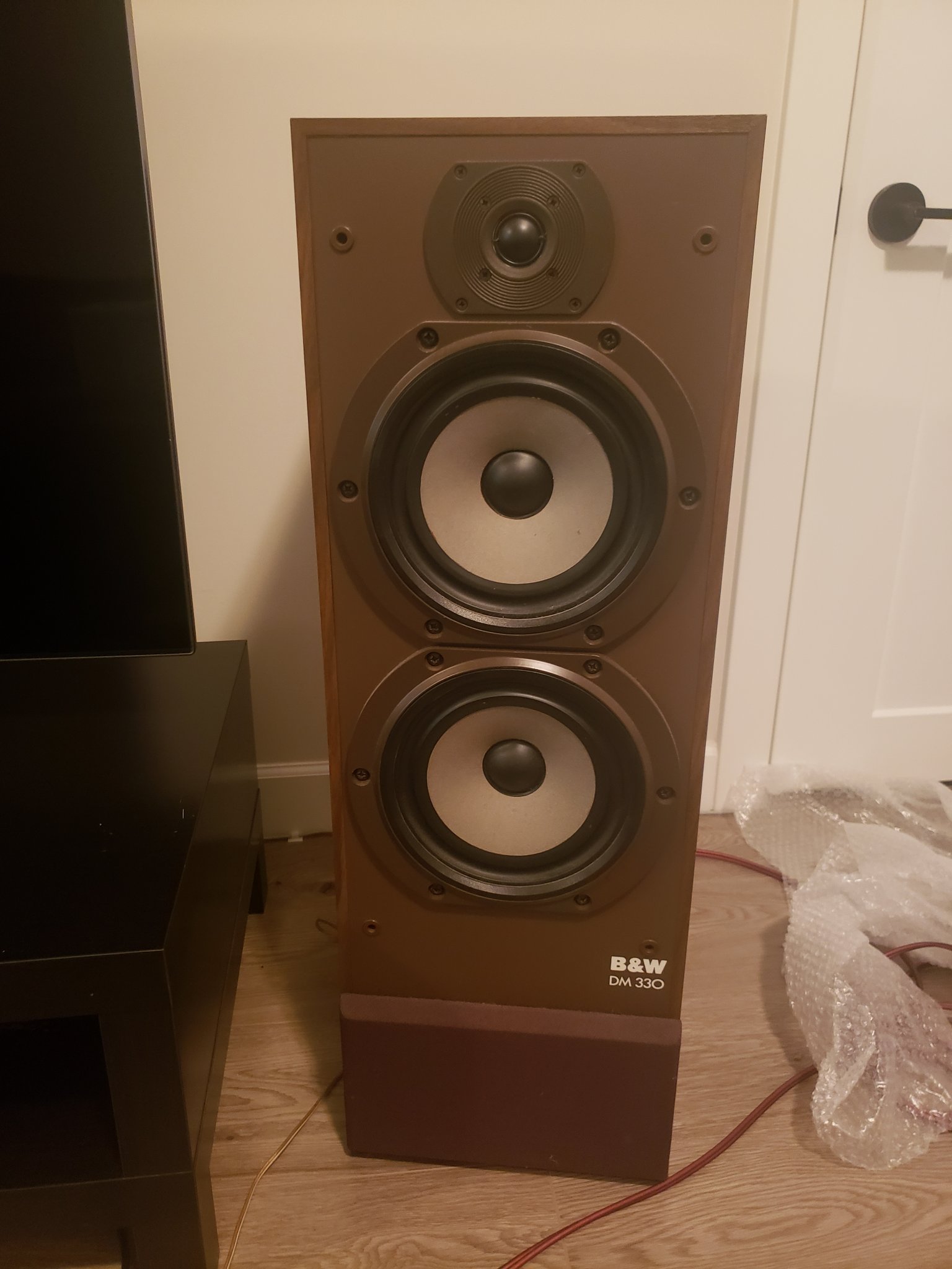

Speakers: B&W DM330 Towers

The Amiga is a 2 way using a 6" midwoofer and decent standard range drivers. The B&W a 2.5 way using 8" drivers and crossover components that are 30-40 years old (?). If the B&W is still performing reasonably close to spec then it will have better low frequency performance but this may be lost due to room boom. The Amiga may or may not have the edge in the midrange where 2 and 2.5 ways are pushed hard to perform well hence the use of a midrange driver in more expensive higher performance speakers. It might be more a question of which characteristic sound you prefer. Personally I rather like the "old fashioned" sound of a large efficient paper cone crossed fairly high to a tweeter plus clean percussion is also something I tend to weight so my preference would possibly be the B&W but I am not familiar with either speaker so this is speculation.
If the B&W are in decent condition then it is likely to be debatable which speaker is preferred. If you want to safely raise the sound quality I would look to a 3 way or possibly a good large 2 or 2.5 way with a waveguide. This will raise your budget significantly though.
It's hard to say if one is better than the other, they are different and with different plus points. If you want to upgrade for sure you need a 3-way.

Thanks for the response ill look into some more complex designs, I do enjoy the sound of the B&W's and have no real complaints they are a little veiled for Movies and TV but they sound nice for long music sessions.

1) Replace the electrolytic caps in your current crossover. If they're 30-40 years old, the caps might have degraded.
