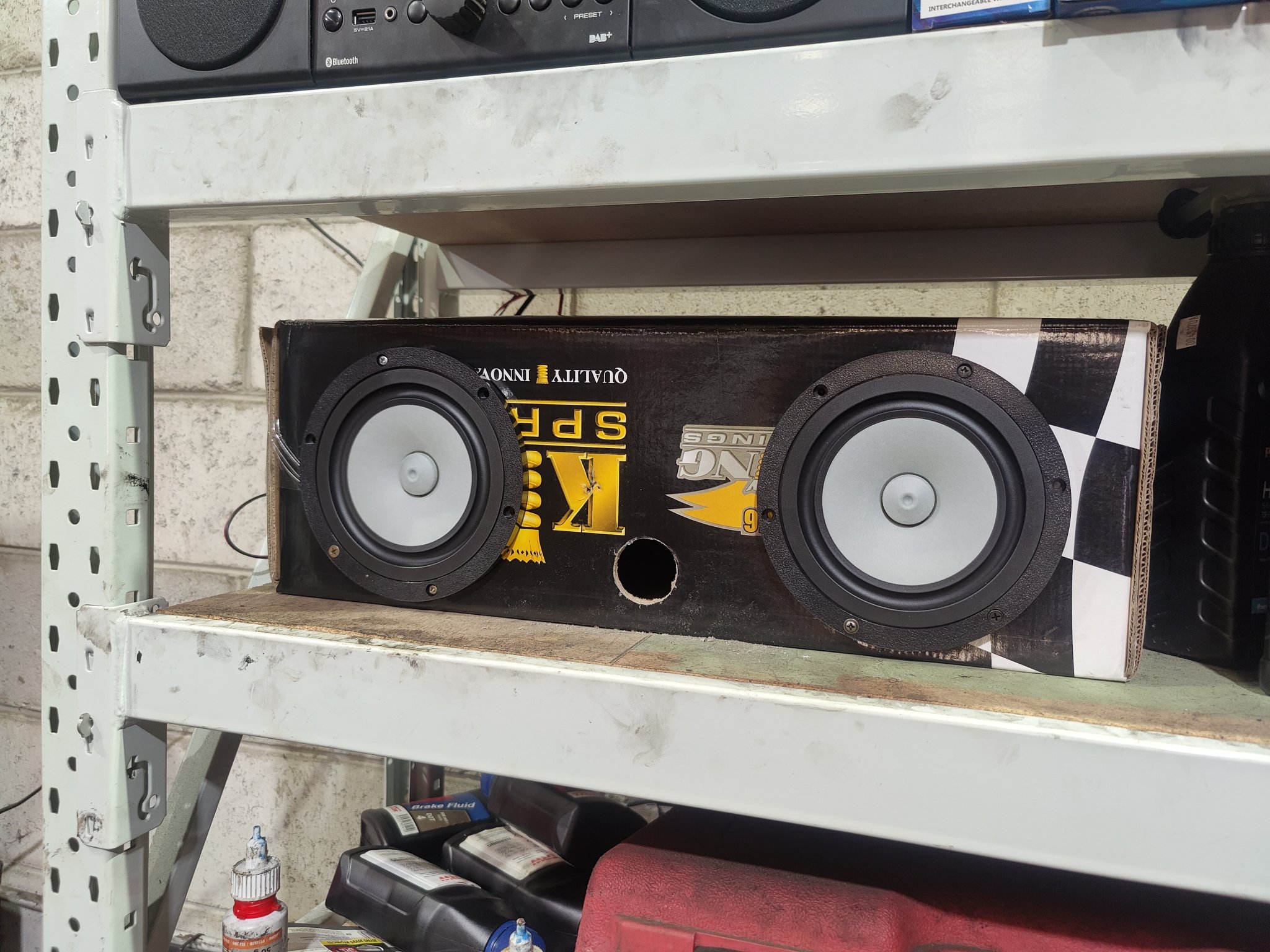

Jamesemucc,
Good that you have started to get some hours on the drivers.
Hope your temporary baffle is placed in such a way that there is no chance of the drivers falling over face first or even off the shelf? That would not be cool...
