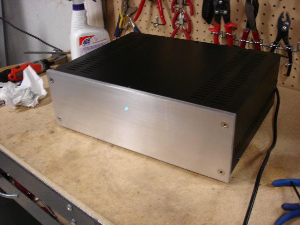

MikeW said:Well, It's about time.![]()

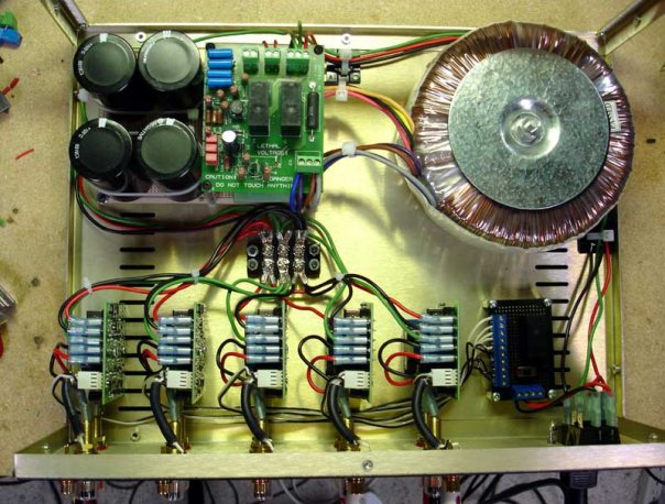

Very nice housing. Any pictures of the inside?![]()
its about time? this one only took me 2 months total. and a lot of that was waiting on parts and such 🙂
and you beat me to it! i always post inside pics!

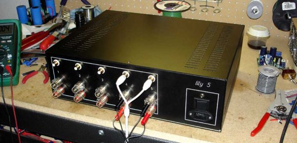

lanierb said:Is that a parmetal 20-series case?
yep! it was pretty cheap (under $50 i think). i got it without a faceplate and just made my own. the back panel was done by front panel express for around $20.

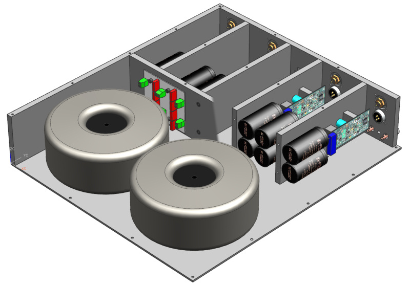

novec said:Hope you don't mind me adding a 3D model of my little monster, too. It's a stereo amp with four channels, which will be run with an active crossover. Each pair of amps share a 1300VA trafo and dual bridges, but they have their separate caps.
looks nice. 4 caps per channel? what size are the caps?

I'm using 15000 uF Jensen 4-pole caps, two pairs for each bass amp and a single pair for each high amp. By advice from Lars Claussen, I'm separating the treble amp and caps from the bass amp/caps with a 1 ohm resistor at the bridges.
