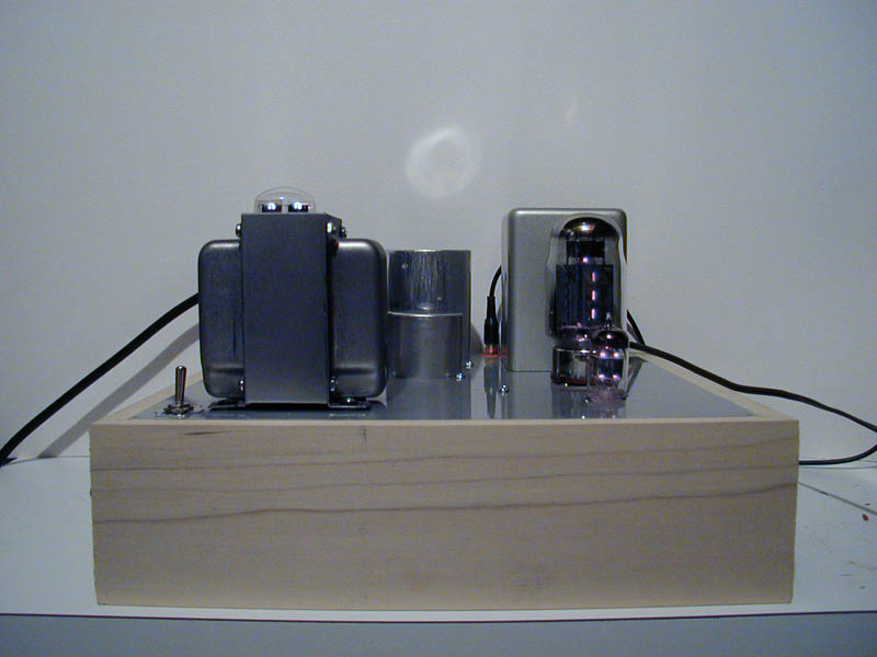

Here are some pics of my newly "complete" single ended KT88 monobloc. (Still have to build the other one.) Please ignore the ugly temporary base. It is something I threw together this morning from some poplar I had laying around.
First here is the amp in front view-
Sound?

First of all the amp is absolutely quiet. No hum or buzz whatsoever from the speaker, even with my ear inches away. Second the sound, even with my cheap test speaker is pretty amazing. Bass extension is excellent, highs are crisp and the midrange is very good. Diana Krall, even in mono sounds great.

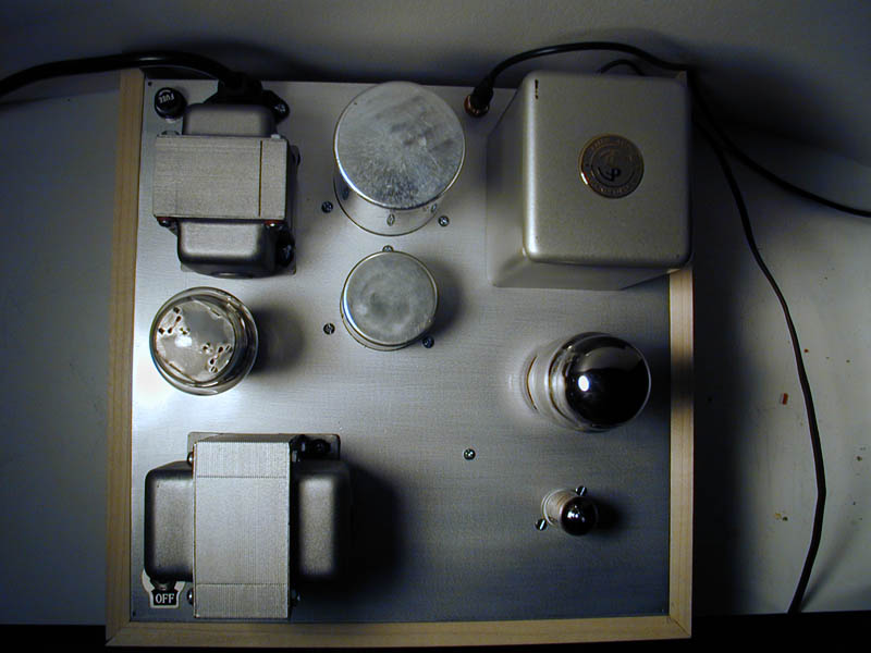

Nothing exotic in the construction. 1/8" aluminum top plate sanded with 320 grit wet/dry sandpaper and sprayed with a couple coats of clear gloss acrylic. Power iron is a Hammond 273BX and a Hammond choke (8 henry) filtered with ASC oil caps. A .22uF Auricap coupling cap between the Svetlana 6N1P driver and the Valve Art KT88. Rectification courtesy of a 5U4-G (which looks great too).
The best part may well be the James 6123HS output transformer. I had a difficult time deciding between the James and a Hammond 1628SE but I am very happy I went with the James, even though it meant painting the Hammond iron to get some sort of match.
I'm anxious to get started on the twin so I can listen in stereo!

The Hammonds I received had a very poor level of finish with some spots and runs. The bolts holding the bells on appeared to have been cut to length with wire cutters. Even if I had gotten black James transformers I probably would have repainted the Hammond iron.
You are right about the James units. The quality of the finish is superb and based on my limited listening so far the guts must be equally well done.

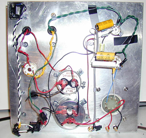

What kind of wire are you using from the input RCA to first tube?
It's a shielded but brand?
resident said:...Why you didn't post it to photo gallery?
I didn't want to post it in the photo gallery until I have the other one done and real bases built. 😀
Yes, I used 2 conductor shielded wire from the input jack to the first tube. It is just a spool I picked up at Radio Shack. I like it because the shield is stranded copper instead of foil like some brands. It is easy to twist the shield into a thin wire and to solder.

I also put the scope on the completed one for some preliminary testing. At 1 KHz it appears to be making about 8 watts before clipping! That's a bit more than I expected. I haven't yet tested output at other frequencies.
