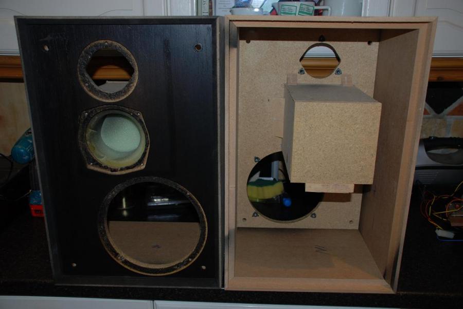

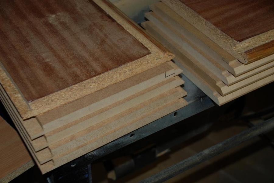

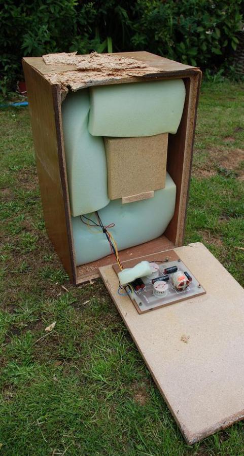

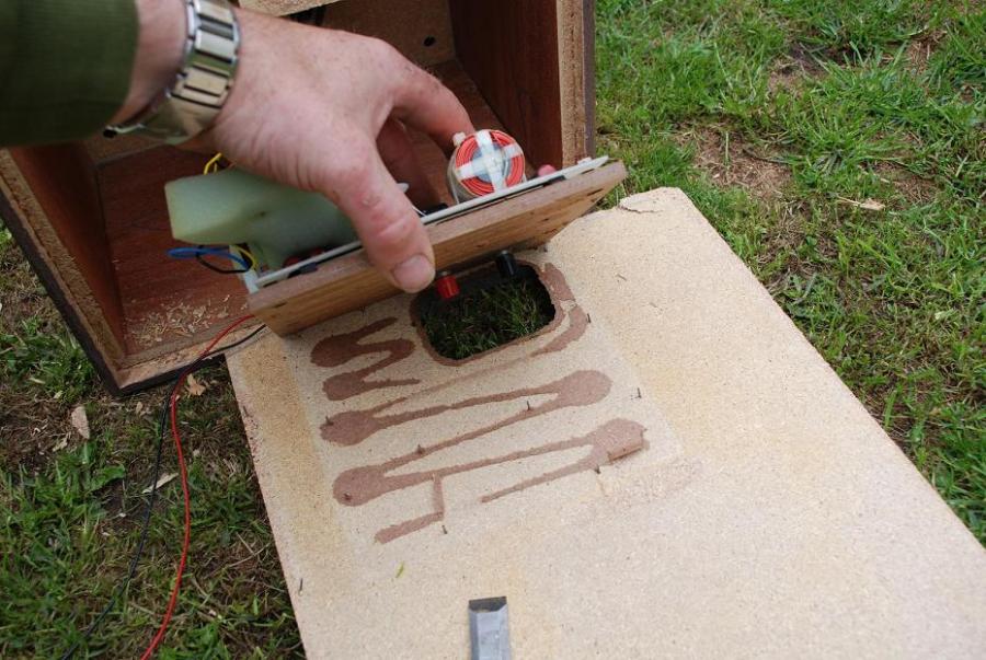

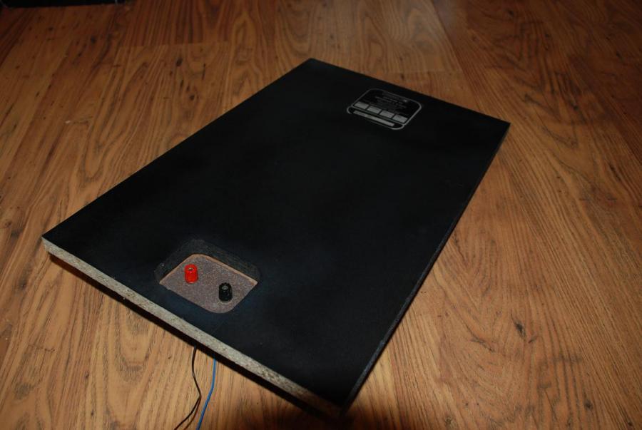

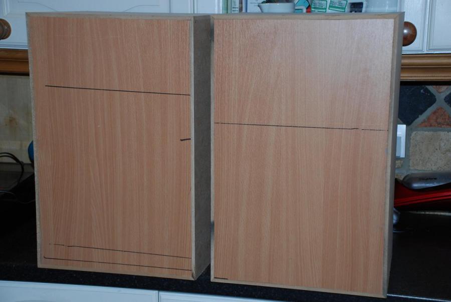

Another project im on with at the moment if anyone is interested is a pair of celestion ditton 22 speakers that had terrible water damaged cabinets so i built some brand new cabinets only i used thicker material than the chipboard they used, they are an exact replica to the original, i did manage to save the front baffles with the speaker cutouts which saved me some time, anyway seing as the speaker units are in mint condition i thought it would be worth the trouble to bring em back to lif
More up to date work done showing new cabinets.

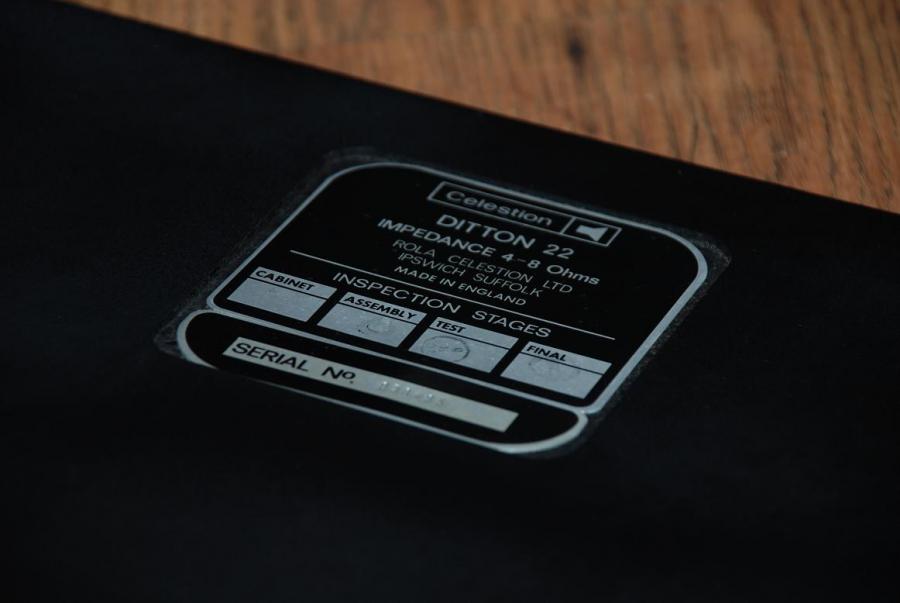

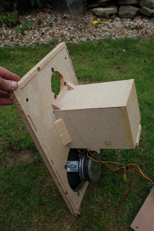

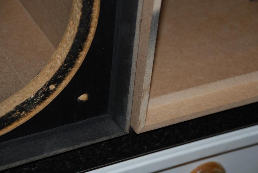

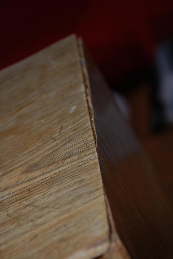

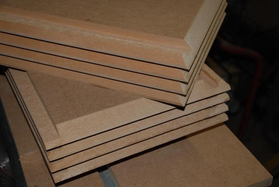

Some later photos of the progress from over a year ago, shortly after these were taken i had too much other stuff to do so they have been on the back burner ever since, this week i will continue to finish them now i have the workshop to do them.

MDF over chip board. That should help. I would dispense with the protruding front edge and do a large radius. On my 44's I used a 1/2 inch felt pad to reduce diffraction problems and it was behind the grill.
I seriously would add some bracing. The 44's had a neat trick, the mid chamber was a cardboard tube that connected to the rear wall.
This is terrific, Mr AudioFreeeek! Very nice work indeed. I see the interwebs is quite short of detail on the crossover, which is a thing I always enjoy seeing. Celestion always used very good components, but a schematic is as rare as hen's teeth for the Celestion Ditton 22.
