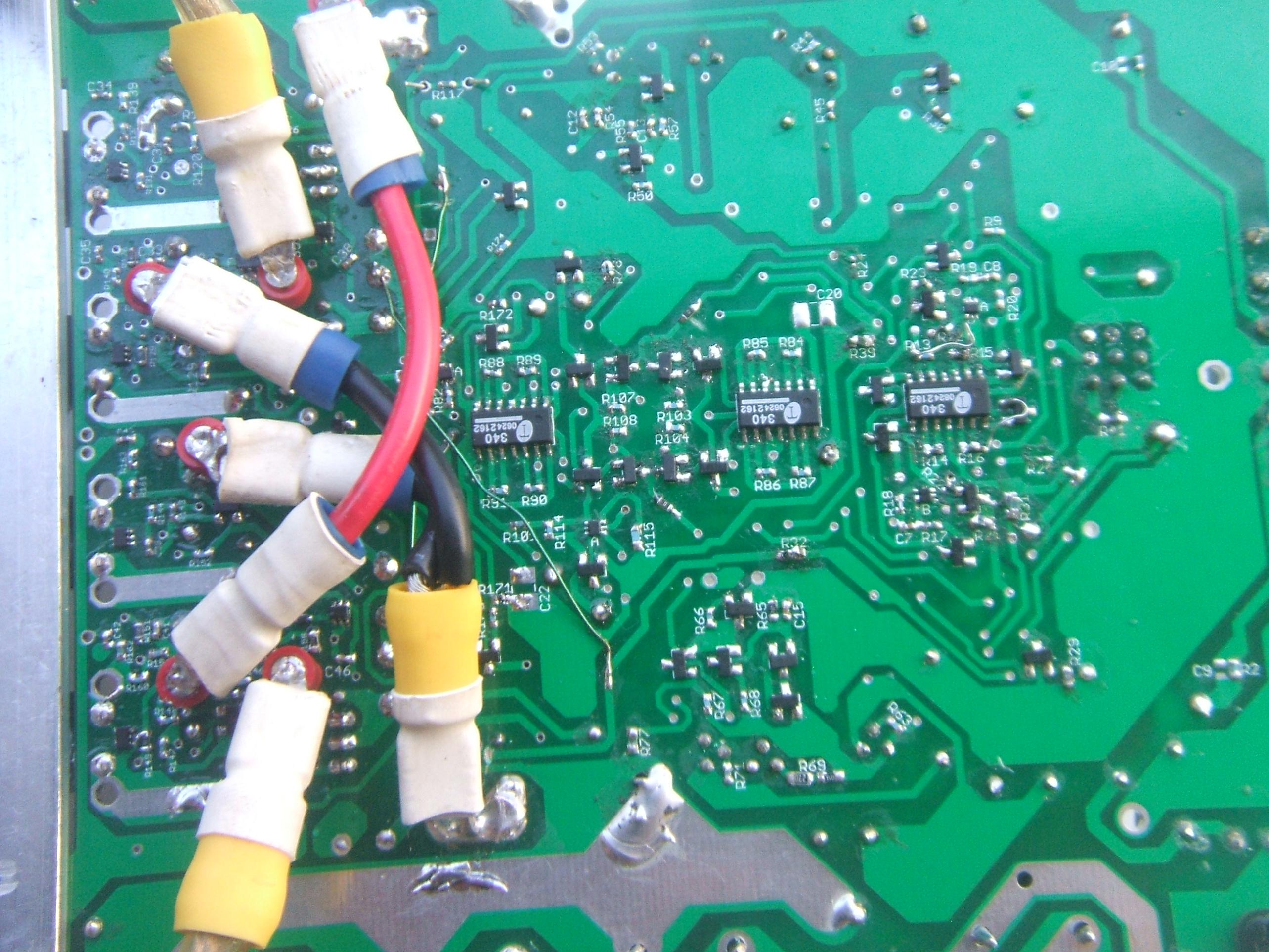

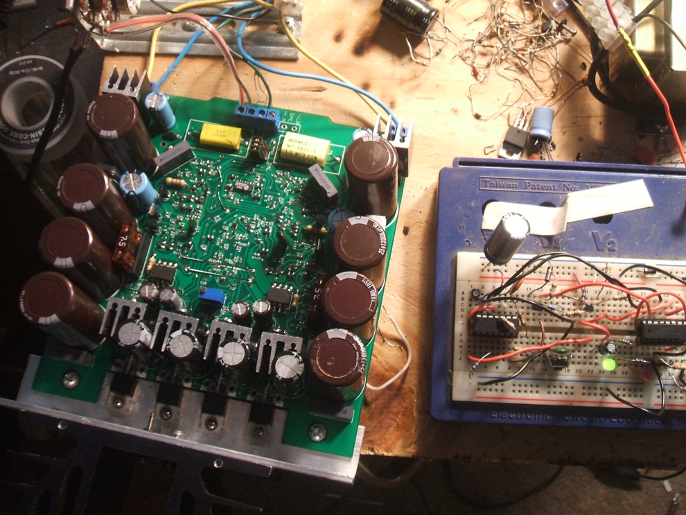

Oh, whoa....Nice bit of PCB work there. Has this been posted with schematic etc. before, CBS, or is that not the plan? Thanks for posting the spec sheets too. All I need now is new close up specs to check it out and maybe think about some more SMT myself!
If your going to go SMT, you might as well go with SMD resistors, and caps too. The SMD metal film resistors are nice in terms of noise and the small COG pf caps are great for compensation duty, and they're cheap. I'm going to use some 0201 size resistors in the next model. For resistors that have uW to a few mW of power, why not? I do know that if you intend to have to hand solder 0201's, you should leave a bit longer solder mask pads in the PCB and never bury any pads within large copper fills.
Oh, and that amp is the latest version of my modular bridge amp but I have not posted all the schematics, just a couple of sections. There's a thread somewhere I will have to look it up.
