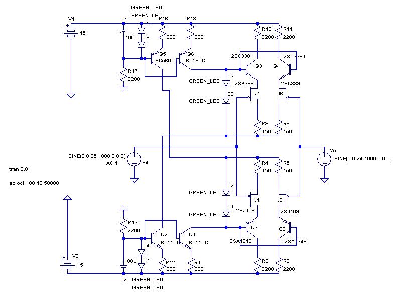

Please, give me some remarqs off this circuit.
I've always used BJT's but many off you made me curious about using JFET's.
Jfet's should be cascoded to minimize the voltage differences between drain and source to keep the input capacitance relative low.
But I've seen many circuit's where the Jfet is cascoded with another Jfet. This way you'll have about 0.7V as VDS for the Jfet. When I see in the datasheets, I will have then pretty hich input capacitance. So I wanted to cascode the Jfet with a BJT, this way I could have a VDS for the Jfet off about 3.5 to 4 volts when using 2 LED's.
What do you guys think off this differential input circuit? Or should I just use two Jfet's instead of Jfet + BJT.

I've got the idea off the SERVO 50 amplifier off Borbely.
And Mr. Curl has me convinced to use complemantary diff input instead of single diff, while he is using this in his Halo JC1 amp.

LineSource,
Yes, I had read that thread already, but for a non EE is it pretty hard to understand sometimes. But in post#18, Forr is explaining a circuit that for me looks like the one I've drawn.
Is in my circuit the CCS for the diff pair exually needed, I use a regulated power supply for the diff pair. And can I than connect the four resistors with each other? ...Oh wait, than I have the Borbely amp 😀
This should make things a bit more easier.
I used two LED's in series for biasing the cascode BJT, is a simple resistor or zener maybe better? Noise? Osscilation?

Hi Benson,
One of the good things about the FET/BJT cascode as in your pic is that it doesn't need the CCs's for biassing and a simple R tail between the two halves can set the bias.
The best CCS is no CCS. You still need to bias the cascode though.

Hi Bensen,
I too have read Borbely and agree that the logic for connecting the cascode to the LTP tail is well founded.
I think you have made the correct decision to cascode this way rather than using ground for the cascode reference.
The two current sources (& two sinks) do seem a little complicated and maybe Guru is right to remove the tail sink/source and just keep the cascode source. But with a regulated PSU even a resistor here should be adequate to feed the two LED string.
However, keep the PCB as you have drawn and compare the four versions;- all ccs, all resistor, ccs to cascode and resistor to LTP, ccs to LTP and resistor to cascode. Then you can publish the sound quality effect of your experiments. I will be waiting.

Hi Benson,
There could be an opportunity to bias the cascode from a modulated driver as in my latest design which not only eliminates the need for the CCs but benefits from a 3 times reduction in THD - why wouldn't you?

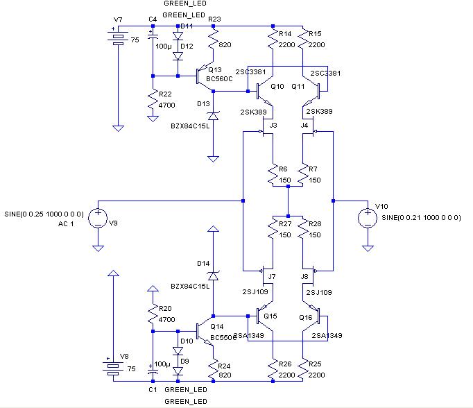

Hi AndrewT,
You mean by referencing to ground, something like in the attached pic I presume.
But, this gives me one very big advantage. Namely, this way I can supply the diff input pair with a regulated PS +-75V , without destroying the JFET's due to overvoltage, and have a large enouph output swing for the second stage. Otherwise I have to use some kind of circuit posted in the next post.
But this cascode give me more voltage variations over the Jfet --> input capacitance raises.

Bensen said:This is the topology I should use when I would supply the diff pair with only 15volts. Don't mind the resistor values....
I think always that: the less stages there are in an amp the better.
Hi Bensen,
why so many VAS's?

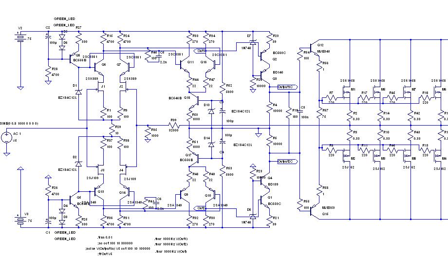

Well,
When I would connect the outputs off the diff pair directly to the Cascoded VAS (BC... +MJE...), there would be to much current taken away out off one leg off the diff pair.
I want to bias the cascoded VAS to about 30mA, and when I fet the diff pair with only 15volts, and the VAS with 75V, I would need many volts over the collector resistors from the diff pair to bias the VAS that way.
I can live with a current of max 50µA leaving out of one leg.
The first stage after the diff pair services as some kind of buffer to not source to many µA out off the diff pair AND also gives me a phaseshift of 180° degrees which I need. The following stage makes it possible to give a decent output voltage for the cascoded VAS. This one needs a signal with a DC offset off about 70 to 75V.
Well, I've said I'm not an electronic engineer. So this could be made probably much better and easier. But I'm still learning the art of amp designing.
This circuit is just a try to have an idea how an amp works, and what to do to get a "nice" output signal.
First a want to focus on the diff pair. For the VAS I will surely use a Casoded one and than lateral mosfet's.

Bensen,
ok I see, you have a "level shifting" issue here! 😀
I don't think there's any problem connect the diffpair collector resistors directly to the outputstages rail voltage as such.
It would be more important to have a "buffer" after VAS than before me thinks.
Oh, I think this should be risky, the max VCE is 80V for these devices. And with this circuit they would have about 70V.

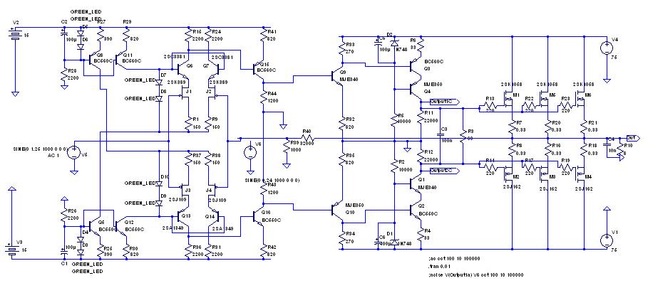

Thanks JCX,
I've redesigned the amp. And I've come to the following topology (see pic). But many off you guys are saying that a buffer after the VAS is an advantage, as the output devices seeing a much lower impedance.
What are you guys thinking of mine amp, does I really need that buffer, because it's giving oscilations. Don't look at the values of the resistors from this buffer, this pic is taking during simulations.
Or, do you think it would be better to definitely use this buffer. Or maybe I should design it different.
BTW: the gain is +-20000 X

I see that when I use a MJE150XX or the BD139/140 combination instead of the MJE340/350, I got ridd of the oscillations. But when I checked the datasheet of the MJE150xx serie, I see that these like to work on higher bias, but throught the buffer is running about 30mA.
1) Is 30mA enouph?
2) Which transistor combination looks the best fit to you?
3) Why is this (oscillaton dissappears)?
