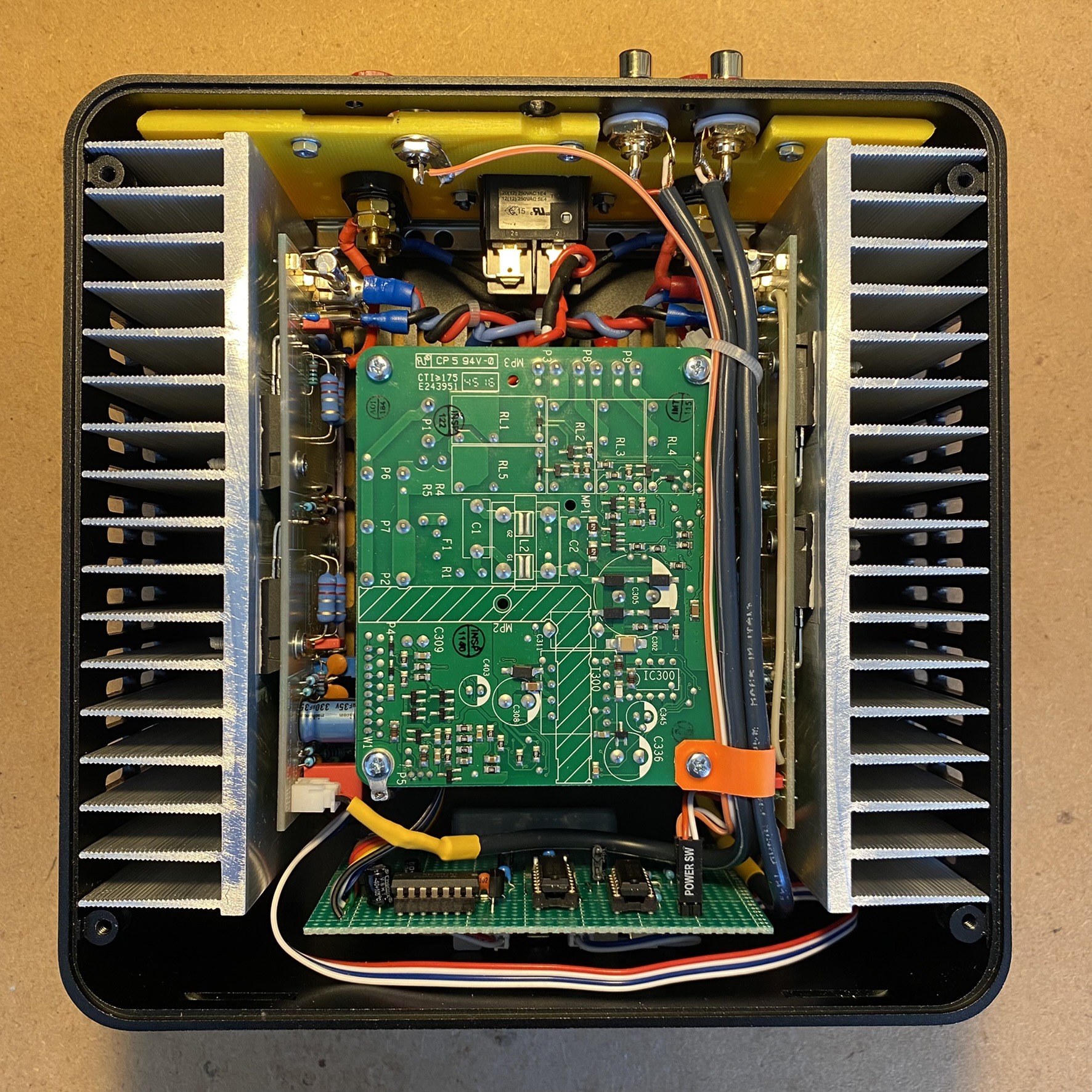

I was not concerned about clipping at all because of the hard current limitation of SMPS in my amp of 5.2A peak. If both channels are driven (which is usually the case) it leaves me with just 2.6A peak per channel or about 27W into 8R max in RMS terms. The probability of clipping is extremely low in normal use in stereo, the SMPS overcurrent protection would simply shut the thing down before the output approaches rails. It was a deliberate choice with 25W as desired power and constraints of the small enclosure and heatsinks.
