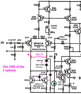

O.K. that was too rudimentary to just load the current mirror with a 20Meg resistor. Nevertheless, the improvement is just not marginal.
I struck on an idea today. {I am using the following buffer stage inbetween the LTP/Current Mirror and VAS stage. The transistor is a 2N5401. Emmiter resistor is 820E. Collector Zener is 16Volts and the limiting resistor value is 2K2. The top line you see is the 63volts +ve rail. The Base is driven from the LTP and drive to the VAS is from the Emmiter. (This is an adaptation of an idea given to me by Anthony Holton). I see a lot of noise in a simulator due to the zener but in practice I found the buffer to be very transparent sonically compared to a few other types I have tried.}
I will load the unloaded side of the Current Mirror with one more buffer as shown and ground the emmiter with a suitable resistor. At this point I have no idea what the value of that resistor should be but it should approximate the impedance presented to the emmiter of the buffer by the VAS. Any comments?
Yes, the input HF filter is formed by a 330pf cap and 27k resistor. I may be able to reduce the value of the cap to somewhere between 270pf and 220pf to increase the bandwidth.
The Miller cap right now is 39pf. It is made of a 27pf+12pf, both silver mica types. I may try to reduce this to 27pf; 22pf is another value that I have, but I am worried about stability with such a reduced Miller cap value.

Alex (sandyk) sent me few tips. I tried them and have reported my observations to him. In short, I was able to get my already modified Quasi Mosfet amp to perform very close to my Stochino amp, which is the best I have heard so far, including diy and commercial amp.
If Alex gives some details here, I will expand a bit more.

Have you fitted your regulated front end supply yet ?
This should give a further improvement, due to a further improvement in overall noise level.
(Samuel initially tried 2 x 10Megohm resistors in series between the collector of the differential pair on the unloaded side, and the adjacent supply rail for the current mirror In this case 20Megohms highlighted there was an improvement possible, as there was an emitter follower fitted. In cases where there is no emitter follower between the differential pair and the VAS, a lower value resistor could be tried. Perhaps, initially try 10 Megohm, or even 4.7Megohm)
Also, with the differential pair balancing, the soundstage and overall SQ will markedly improve when the difference voltage
between the collectors of the well matched differential pair is reduced below 5 millivolts, However, measures may need to be taken to stop drifting away from the optimum. These measures will depend on the actual circuit, but various options include 1. Replacing the tied B and E junction of the current mirror with a 1N4148 diode. 2.Cutting the PCB track between the collectors of the differential pair and current mirror, on the unloaded side of the current mirror and inserting a 1N4148 diode,and if needed a small schottky diode in series, to give the necessary voltage drop. In the case of my Class A amplifier , it was approx. 900mV.
.Fine tuning of the collector difference voltage may be performed by varying SLIGHTLY the value of the emitter follower,or VAS emitter resistor to achieve balance. If the loaded side has in effect the equivalent of 2 base emitter junctions in series loading it (1.2V) then 3. a series 1N4148 diode and resistor may be used. This diode will also give thermal compensation. The value of the resistor needed will be equal, in this case to half of the overall resistance equivalent of the loading of the base current of the EF/VAS stage. The bias current is approximately the collector current of the loading transistor divided by it's HFE. It may be possible to use a 10Megohm trimpot in place of this resistor to get perfect balance.
N.B. These techniques have worked well on RIAA phono preamplifiers, preamplifiers, and several power amplifiers , as regards a marked improvement in soundstage,and with suitable material, a 3D effect . Final results are completely dependent on the degree of matching of the differential pair.

The attached image should help to understand the differential circuit modifications for improving soundstage, as described in my previous post.Different amplifiers may require different methods.
If anybody wants a larger copy, please email me.

Yes, assuming that the differential pair is closely matched for HFE and VBE, try to adjust to <5mV difference between their collectors when warm.Only use minor adjustment of the VAS emitter resistor so as to not affect it's correct operation. If unable to achieve with only a small variation of the VAS emitter resistor . try the diode and resistor method instead. Using the 2 series diode method, you may be able to get closer by selecting a suitable 1N4148, as their forward voltage does vary a little between diodes.
BTW, it is adviseable to use matched 1% resistors in the emitters of the differential pair and current mirror. The actual measured value of these 1% resistors isn't as important as them being close in value.
