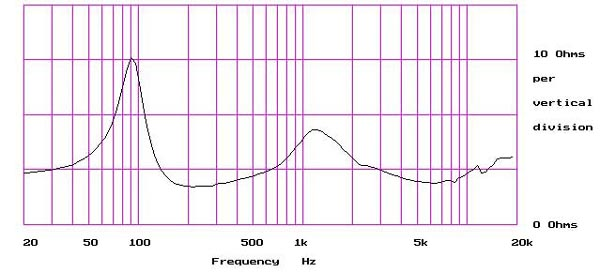

Right, the confusion is simply with the "nominal" rating that speaker manufacturers use. It's an "average". When you have a driver that has a sticker on it that says "8 ohms" it's most likely an average, as the impedance varies depending on the frequency that's being fed into it. Take a look at the picture I've attached.
The speaker you have might just be an 8 ohm nominal speaker, but at certain frequencies it's down at 4 ohms, or even lower - and has enough of it's operation take place at 4 ohms to warrant warning people who don't have a 4 ohm stable amplifier (or who have output transformers) to use the 4 ohm taps, just to be on the safe side.
