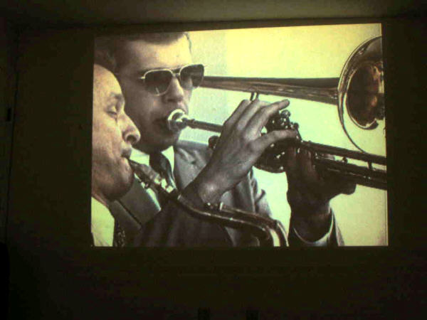

Anyhow, connected DVD player to the panel, nothing happened so I gave Video In from the DVD or VCR player. Finally, figured out how to reduced window xp screen display settings to 640 by 480 pixels to match up with the panel and got something displayed on the LCD.

Are you sure that the rca jack is bad? I originally thought mine on my 1750 was bad but the way to select inputs is to is to hold selct and press the up or down buttons. This will switch the inputs. I don't mean to insult you if you already know this, but I was burned on this before. Also, sometime the cable is not compatible with pc vga. I tried 5 different cables and adapters till I got picture.
Thank you so much. Your tip solve my problem."the way to select inputs is to is to hold selct and press the up and down arrow"
