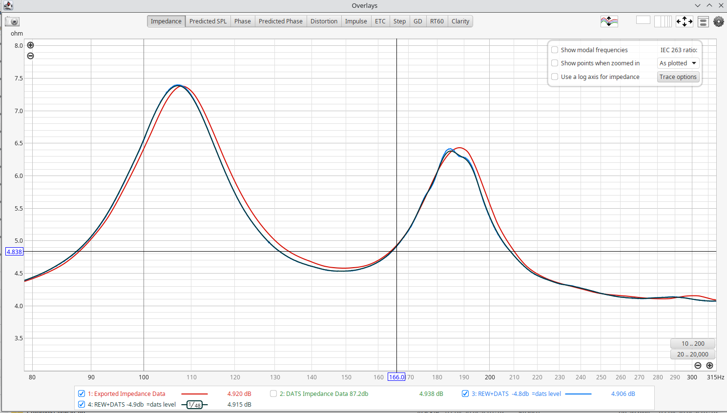

A 2.5 way basreflex loudspeaker floorstander with crossover was tested.
Multiple measurements are consistent and only differ at first impedance peak. 1 Ohm difference. ..Allways... what does this mean? Resister measurements outcomes between the 2 measure methods are the same.
Resister measurements that were done showed expected values and are within range for both methods.
Comparison measurement DATSv3 versus DATSv3 + REW
DATSv3 + REW Red
DATSv3 Purple

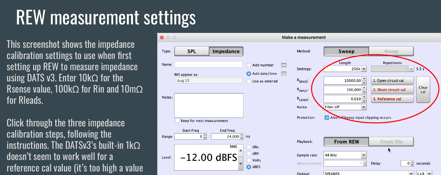

In REW all values except “the leads resitance value” for the impedance setup were take from the manual DATv3 on a Mac written by olen.
10kΩ for the Rsense value. (based on the value of output resistor) Don’t know my Dats R value
Set Rsense = 10kΩ
100kΩ for Rin (where is this value derived from?)
10mΩ for Rleads. I used 0.7399 Ohm Messured earlier with dats sofware.
For the reference cal I used a 4.952 ohm resistor..

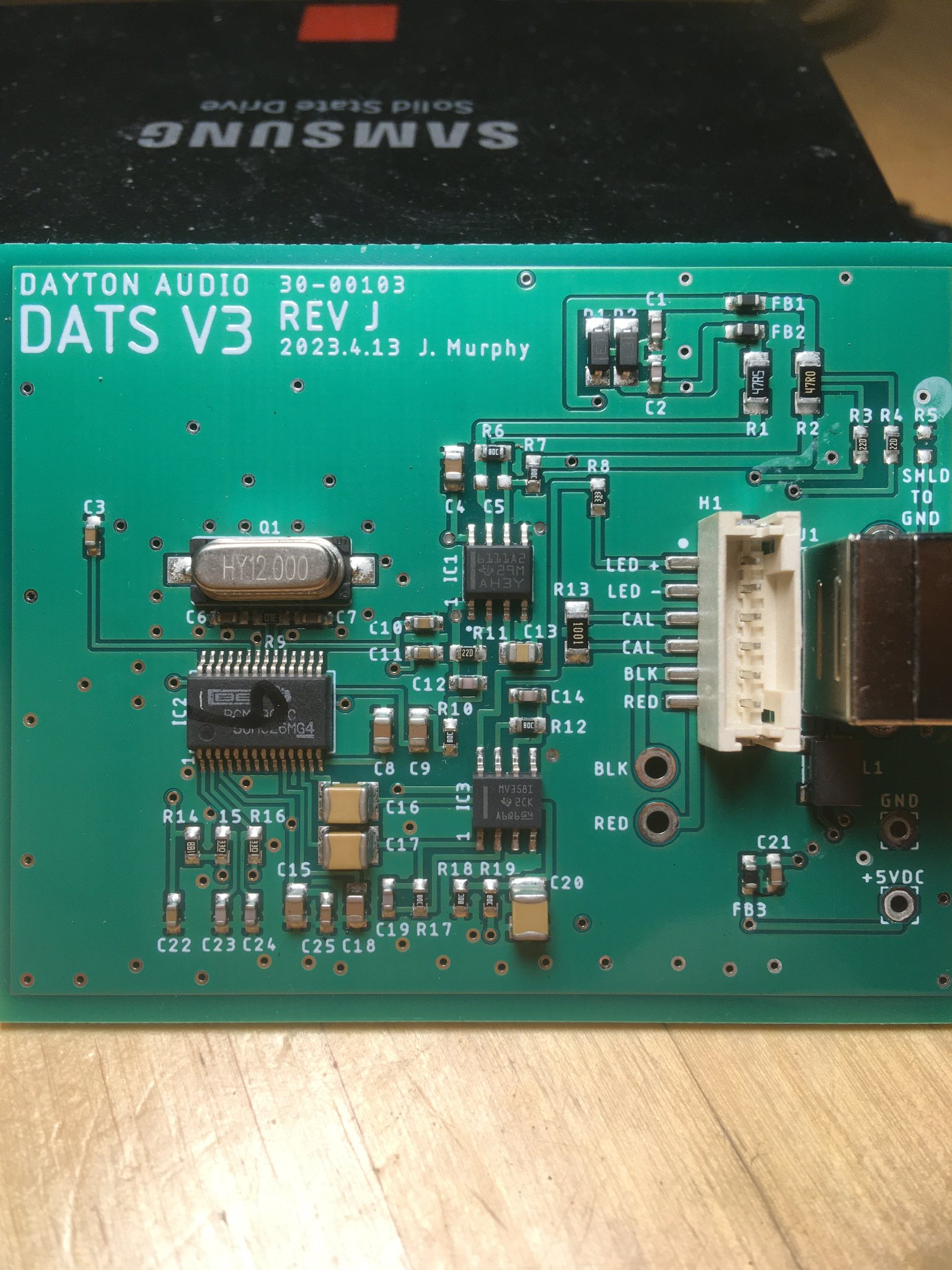

-- INFO -- My version of the DATSv3 is different from olen’s...See earlier post with picture...If my dats series output resistor value differs say 2000 Ohm from the 10000 in olens Manual could that alter the reponse, and then ONLY doing so in the left part of the graph we are seeing?

To verify that DATS worked correctly in linux Manjaro (without using REW) I ran same test in windows 7 where i could set speaker and line-in inputs and outputs for the AUDIO CODEC devices. Imported the DATS 'manjaro" and "W7" freshly made impedance zma files in REW (witch also is installed on windows 7) and they match! So thats ok...Then ran REW + DATS also in w7 and that shows same result as in Manjaro. The same Larger impedance peak at arround 28hz for REW. 1.2 Ohm higher than DATS....I'll try to recalibrate inpedance in REW with other values for Rsense and R-in and see what it does to the measurements. Since i have a different DATSv3 then the @olen manual shows it might be worth a try.

The impedance plot you show is characteristic of a ported speaker (or passive radiator), the magnitude of the first impedance peak can change with drive level or differences in air load on the port. Did you move the speaker between tests? Is the port partially blocked or near a wall? Were the drive levels consistent between test?
As an aside, one way to test port compression is to measure electrical impedance at increasing drive levels, you’ll see the first impedance peak start to flatten out. It might be difficult to see this with a DATS because it can’t provide enough output power to drive a speaker port into compression.

1) Do you use a beta version with even better built in cal steps?. I'm using REW 5.31.3. not shure if i can use the beta in linux tho, due to the not built-in Java.
2) are you still using the values Rsense 10k (thats the max in my REW) and Rin 100k ?

Here's the "cheap Speakers pics".Second pic zoomed in... DATS solo in red vs DATS+REW. Same level. The deviation second peak/top was constant...maybe due to noise...averaging doesnt really improve on peaktop, REW 1/48 smoothing. Perhaps REW sofware has higher resolution ha.
probably 128k / 256 length in rew and 64k in DATS....aaaarrggg Dont know yet if one can set sweep length in DATS.

1. Power rating should not make much of a difference at the levels DATS tests, to see if there’s any effect: after you complete calibration run multiple impedance sweeps and see if there is any change (thermal drift), technically a larger, higher rated should have more margin for thermal stability. The tests levels are so low that 0.6W or even lower should have plenty of thermal margin. DATS is intended to measure impedance for determining small signal parameters, so….
2.No, I use whatever value the calibration step determines, I only used the 10k back before the calibration step existed.
3. I’m using the stock leads, 0.737ohms does seem a bit high, as the output is a current source with series with a 10k resistor I guess an extra ohm doesn’t make a difference. If you have an extra set of test leads I would try them and see, you’ll need to recalibrate. I would expect less than 100 milliohms for a pair of shorted test leads.

2) In your manual 'dats on a mac' with rew, you used 10kΩ for the Rsense value based on the value of the output series resistor of the DATS.This was part of the calibration proces you did in the manual. Not shure when you now say 'i only used 10k back before the cal proces existed'
b) still have to enter a Rsense value for REW 5.31.3 during 3 step calibration.
Hope you saw the pic with detailed print-layout with components of my Dats..mine's is different.See below. Sinse i dont know the dats output series resister is there a way to find out (measure it) or doesnt it matter? .Perhaps all DATS output series resistance have a high value near 10k?
Hmm, sorry for the confusion, I found on more recent versions of REW if you use the built-in calibration procedure you don’t need to manually enter these values, I don’t remember exactly when the cal procedure changed. When I initially started using REW with my DATS the self cal procedure was not in place, it wasn’t until much later that I documented the steps. I continued using the manual method that had been working and didn’t try the self cal steps until later. I recommend using the self calibration, maybe try it both ways and compare the measurement using your reference resistors - my guess is using the built in cal procedure provides more accurate measurement results.

1) Unfortunately I don’t remember and didn’t note what it looked like previously. When I use the REW’s built in cal procedure I don’t enter any values other than the exact measured value of my reference resistor. For example 4.321 ohms. After the calibration process is complete I believe REW fills in these other values.
2) I don’t believe you need to enter any value for the leads, I believe this value is taken care of when you run the cal test with the leads shorted.
3) Yes that is correct. You want to use a reference resistor that is in the neighborhood of the values you are trying to measure. I use a reference resistor where it’s specific value was measured on a calibrated micro-ohm meter - in an attempt to achieve 4+ digits of precision.
