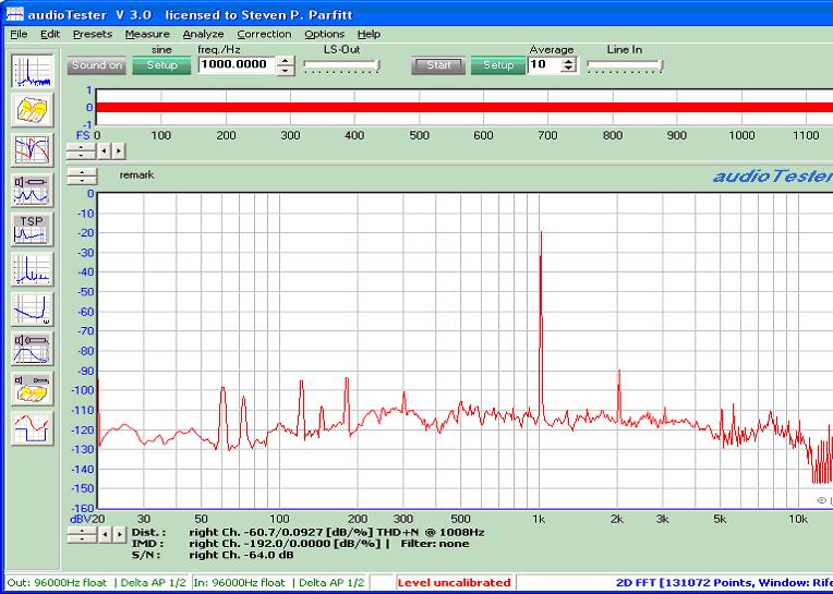

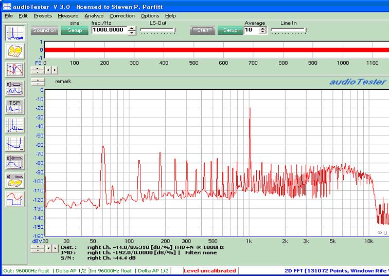

I accidentally left my heater resistor termination ungrounded and spent a day chasing noise.
I thought it would be interesting to post the comparison of floating heater and grounded resistor divider noise spectrum.
This graphically demonstrates why one should terminate the heater string with a pair of resistors and ground the center point of the pair.
First image is ungrounded heaters, second image is the same amp with the heater string terminated with two 220 ohm resistors with the center tap tied to ground.
Yes, it sounds as bad as it looks.

Yeah, been there, done that.. The pix really illustrate the point well. In some cases elevating the filament supplies even in a pa will result in some small, but significant improvement - would be interesting to see if that is the case here, although the results with the resistive divider grounded are quite good.
Any idea where that 70Hz tone is coming from, I'm assuming it is a radiated artifact from somewhere else? (Analog computer monitor??)

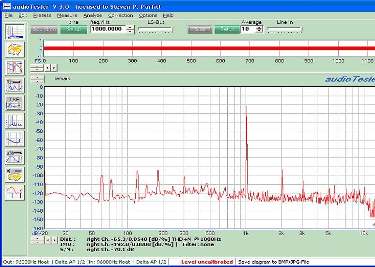

I tried elevating the resistor divider and it was actually worse than when grounded. Since the difference in s/n is greater than 3dB I consider it to be significant.

I did not bypass the lower resistor, and wonder if that would have made a difference. Elevation was 62V with a simple resistor divider.
I suspect cathode composition may effect how well a tube responds to elevated heater bias voltage. The 6N1P may just be a bad choice for elevating the heater.

Definitely need that bypass cap, that's why it was worse, that it wasn't much worse is something of a surprise actually. Since you've done the rest it would be interesting to see what happens with it properly bypassed. (It should be the same or even slightly better, but in any event the results are of interest..)
