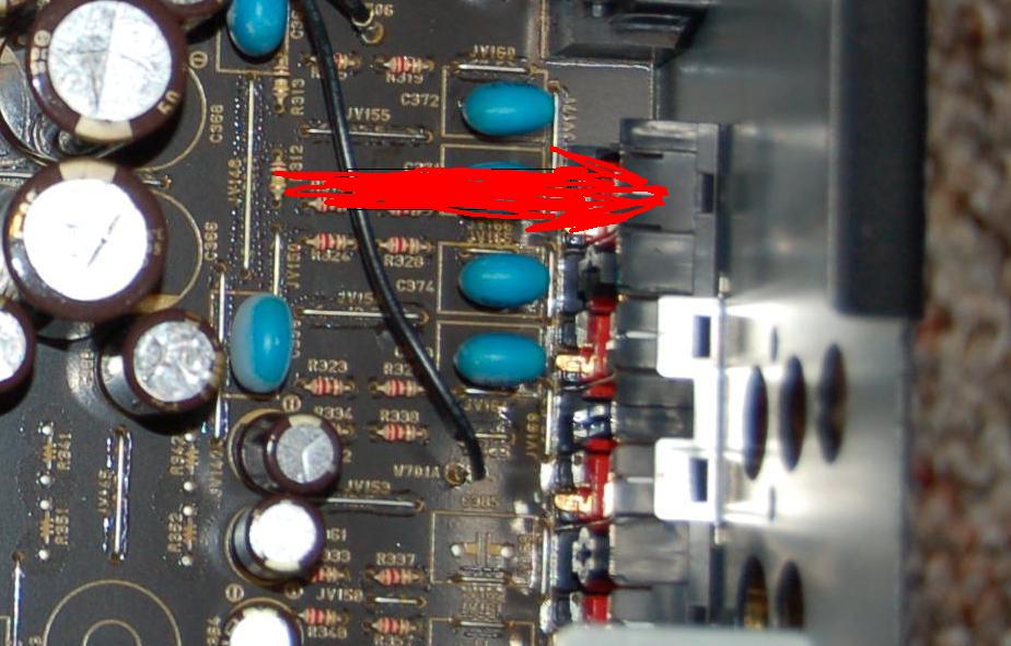

Changing RCA jacks
I didn't change mine.
If I did, I'd feel compelled to change the jacks on my preamp and power amp too (not to mention upgrading interconnects!)...
I've heard that some guys reported good results direct-soldering their right and left channel interconnects directly to the PCB, and used rubber grommets/strain relief through the panel. This eliminates the jacks and another set of contacts(the plugs)!
Sounds like a hassle, but I can see where it would sound better.
Attached pic shows the main R/L jacks, which can be de-soldered then seperated from the multichannel outs(which I'd leave stock).
Cheers
-Chas.
Do I have to de-solder all of the jacks to seperate the L/R?
I never attempted this and it's been a year since I had it apart so I can't remember exactly (and my photos weren't taken from the right angle to see this).
Take a close look at the pcb.
The jacks either seperate pcb jack modules or one big multiple unit, from which you'll have to desolder the leads and then cut off the L/R pair from the rest (at which point-if you're really OCD- you could replace all with "audiophile" quality jacks silver-wired to the pcb). :xeye: Depending upon the quality of your interconnects (and other components), you may decide to "go all the way".
The big improvements, sonically, seem (to me) to be from the improved I/V stage, Class-A biased outputs and power supply upgrades. My friends and I have favorably compared the modded player(with the stock jacks) to a few very high end CD players.
YMMV
-Chas
