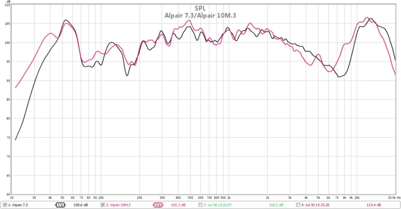

Got a couple of hours with the A10M.3 and A7.3. I'll tell you there isn't much to pick between these. The A7.3 is a bit softer in presentation and the A10M.3 is a bit more sibilant. I didn't find the huge hump centered around 10kHz objectionable. It sure makes cymbals ring!
I'll have to revisit this after a put a few more hours on the A10M's. I have a hunch that there will be so little to choose from in the mids and highs that the nod will go to the A10M because of the better bass.
The A7.3 is in my T7-A7 TL tuned to 43Hz and the A10M.3 is in what will be my B10-A10 BL -- currently tuned to 38Hz. Too low! The speakers are 2.25m apart and the mic 2.25m back. The speakers are toed to cross 15cm in front of the mic. Both channels driven and the amp set the same for both speakers. (REW decides on its own what the SPL level will show -- I set the amp to give 75dB with pick noise.

Weird that the off-axis behavior seems to be better with the A10 (smoother and not quite as much falloff) considering a larger driver should do worse (I'm looking at the official documentation here).
This would not only bode for better everyday/casual use but also get you better room integration.
Is this something you can hear in you setup too mr. Brines?
I think you read the traces wrong. The black trace is the A7, the red the A10M. The A10M recovers sooner from the treble roll-off that this accounts for the increased sibilance I notice in the A10M.
All of the Alpairs have very shallow cone contours, and this makes for better off-axis response. It also makes for a very smooth power response as one moves around the room.

No no, I wasn't looking at your curves but at the official documents an the MA site.
Even if they have the same angle og steepnes it is still remarkable that the larger driver performers so well off-axis (better in fact as it appeals?) and that your traces are so close save for a bit at both ends.

Looks very much one get A7.3+10hz at bottom in the 10M.3.
Have 10M.2 and always because of positive reviews of A7.3 had nearly bought myself a pair.
Now i think i go for 10M.3 in BR after your review, and get the mentioned beatifull top.
