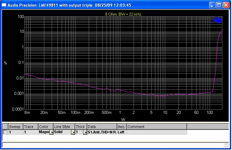

LME49811 Complete amplifier THD vs PWR

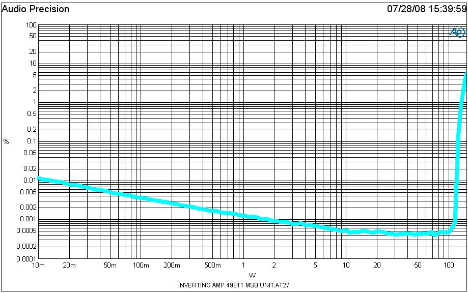

LME49811 amplifier with a compound Darlington output stage and 50VDC rails THD vs Power into an 8 ohm resistive load graph. Can anyone beat this?
Mark / Audioman54
Just posted this on the Class A thread
In my listening tests before I was laid off I felt inverting was better as did some others. Measured about the same though on all our standard tests (which did include FFT's-some else asked me if we looked at FFT's).
Have you posted your schematic (I have not looked back through all the threads).
I was running 50VDC rails on the graph what are you running on yours?

Are the THD graphs done at 1kHz?
jd
Yes, this is 1 kHz.

Here is measured data for 49810 with ThermalTrak. The idle current is set to 50 mA. One emitter resistor voltage drop was monitored. Output power varied from zero to 18 W, back to zero, and from zero to 72 W. The tracking is much faster compared to the previous data for Vbe multiplier for triple-EF output.

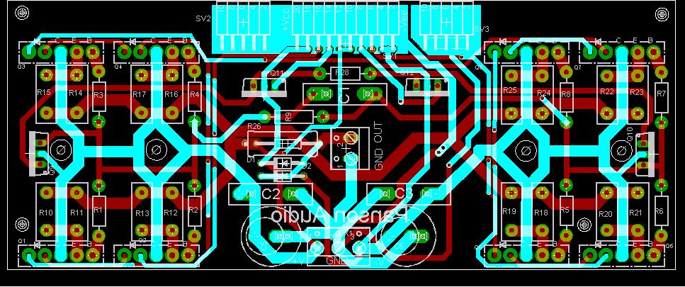

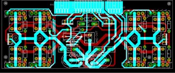

I am working on a new power board layout for four-pair ThermalTrak. Hopefully, it will be finished this week. I will do the same for 3-lead output devices. Here is a draft. Please comment.

I'm not an expert on this, but, I have a couple of thoughts.
If you used 90deg board to board connectors instead of the straight connectors, you could put the LME49811 board at the end of this board instead of at the top center. Let's say you put it at the left edge - just for the sake of clarity in my example. Then you could put the VCE, gnd and VEE at the right edge of the board. The PNP's could be along the top edge and the NPN's could be along the bottom edge of the board. the output trace could run down the middle. This would prevent the power from crossing the output and the low current drive signal traces.
The second thought is that your power and signal output traces look a little narrow. With all these devices, it would seem you are preparing to run pretty high current. I would think 5mm at 2oz would be a bare minimum and 6.5mm to 8mm would be better.

Panson,
you can count me in for a set of the 8 or even 12 output device boards for the mosfet devices when you get things together.
I like klewis ideas about the thick traces. Something that could carry 70+ volts on the rails would suit my purposes. I have always liked the board setups where they have the power supply capacitors mounted very close to the output devices, ie roenders pcb for the fci-100.
