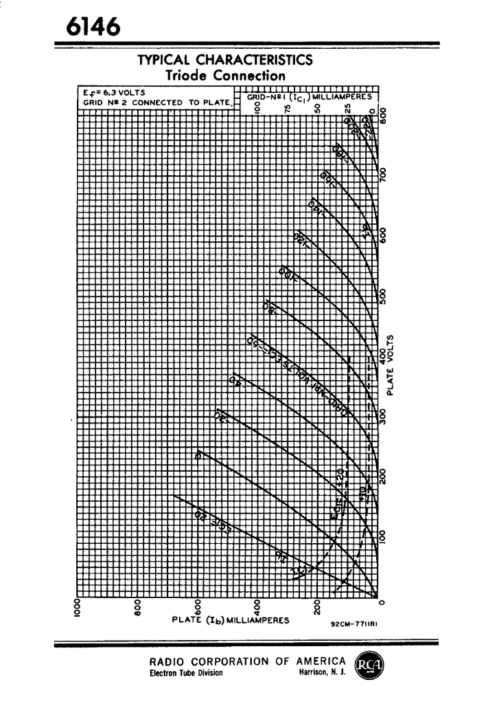

How would the 6894 go as a triode; I built an map using 6146 wired as triodes as in the RCA data 400 volts 8k out put transformer, but the tubes where very hard to drive peak Af grid voltage 200 volts. Would the 6894 be easier to drive.?

I have a SE 6146-based amp and drive it fine with a 6C4. I am running about 550VDC on the plates and 225VDC on the screen grid. Now this isn't so gainy that will will drive into distortion, but I build them that way to keep the kids from square-waving my system. Its plenty loud enough for me and my darling wife.

N4BBQ; thanks for your reply; my problem was the drivers were not capable of driving 200 volts; the amps sounded just like most commercial single ended 300B amps no dynamics and very dull sound. As a pentode the 6146 is easy to drive. Don't see why it is a bad audio tube.
Phil
Phil
Same here; I've built two audio amps using the 6146 as the final stage. They sound good to me. Maybe I'm missing something...?
So Bear, why is the 6146 a bad audio tube?
The 807 is the same as the 6146 difficult to drive as a triode, best to use an EL34 triode connected, the 807 is also very easy to drive as a pentode. There are circuits using the 6146 ultra linear but you need to have the ultra Linear windings wound separately with a separate supply, I can not see why the 6146 would be any worse than any other tube pentode with a regulated supply to the screen.
