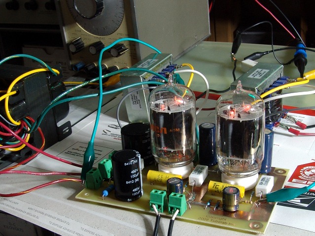

Tony's recent "like" on my 14 year old post reminded me that some info posted long ago is not valid. I realized long after this thread went silent that my 6LW6 in triode mode amp did not exactly work out as planned. The amp worked great, but it ate 4 tubes in less than two years. I wound up putting the EH KT88's back into the amp and ran them at a similar 80 to 100 mA bias point with just over 400 volts across the tube. The EH tubes are still alive and well but have lost their neat blue glow that danced around on the glass.
It seems that some older design sweep tubes can live with excess screen voltage, but the last of the big tubes don't like it. All died due to a runaway event while idling. The SSE amp was used to power my computer speakers for several years, so it saw a lot of idle time. After two tube failures I lowered the overall B+ voltage to about 350 volts and still had two failures. At idle, the output tube does not know if it is in triode, UL or pentode mode since all of the element voltages are constant and roughly the same.
Sometime after these failures I had a 6W6GT die by red plate runaway, again at idle. It was running well inside the published specs for TV vertical sweep use, yet it died. It was a crusty old tube, so I got five brand new 6W6GT's and wired them up to a power supply and let them cook. After about two months of steady state idle one began to run away. I stopped the test before it died and experimented on it, and it was exhibiting signs of excess control grid current probably due to "gas."
In a TV set the sweep circuits never idle. They run at full power all of the time. This lowers the average plate and screen dissipation compared to idle in a class A design. Some users have used big sweep tubes in triode wired push pull amps biased well into class AB1 without failure.
The 6W6GT is exactly the same tube as the 50L6GT used in countless AA5 radios except for the heater voltage. Those things can sit at idle or low output for years, but the screen grid sees about 120 volts.

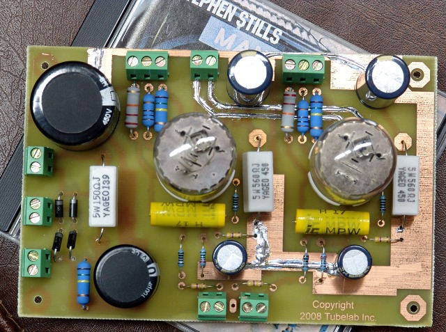

All my DQ5s are the IC “Made in Japan”. They seem to run fine with no increase in bias when running at 475V/25 mA. They made the basis for a 130W bass guitar amp using a quad. I’m thinking with an increase in bias and a little more B+ I could push that to ~150 ish for 2” compression drivers. If that fails, there are the 21LG6’s which I have about 3 dozen of.
The LU8/LR8 looked interesting - especially with a 12AT7 triode in there. But unfortunately, I found out just how poorly matched those triodes were between any 2 given tubes. Not an issue with running one as a gain stage and the other as a concertina, but trying to make an LTP phase splitter out of two just wasn’t happening. That design got reworked around the 10JA5, which is the same pentode. And 6BQ7’s which I could match. Not as nice as that 12AT7 triode, but two 40-mu‘s gives as much gain as a 60 and a 20. It’s sitting in a semi-working condition waiting on my new work facility, however long it takes.

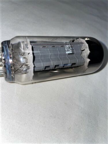

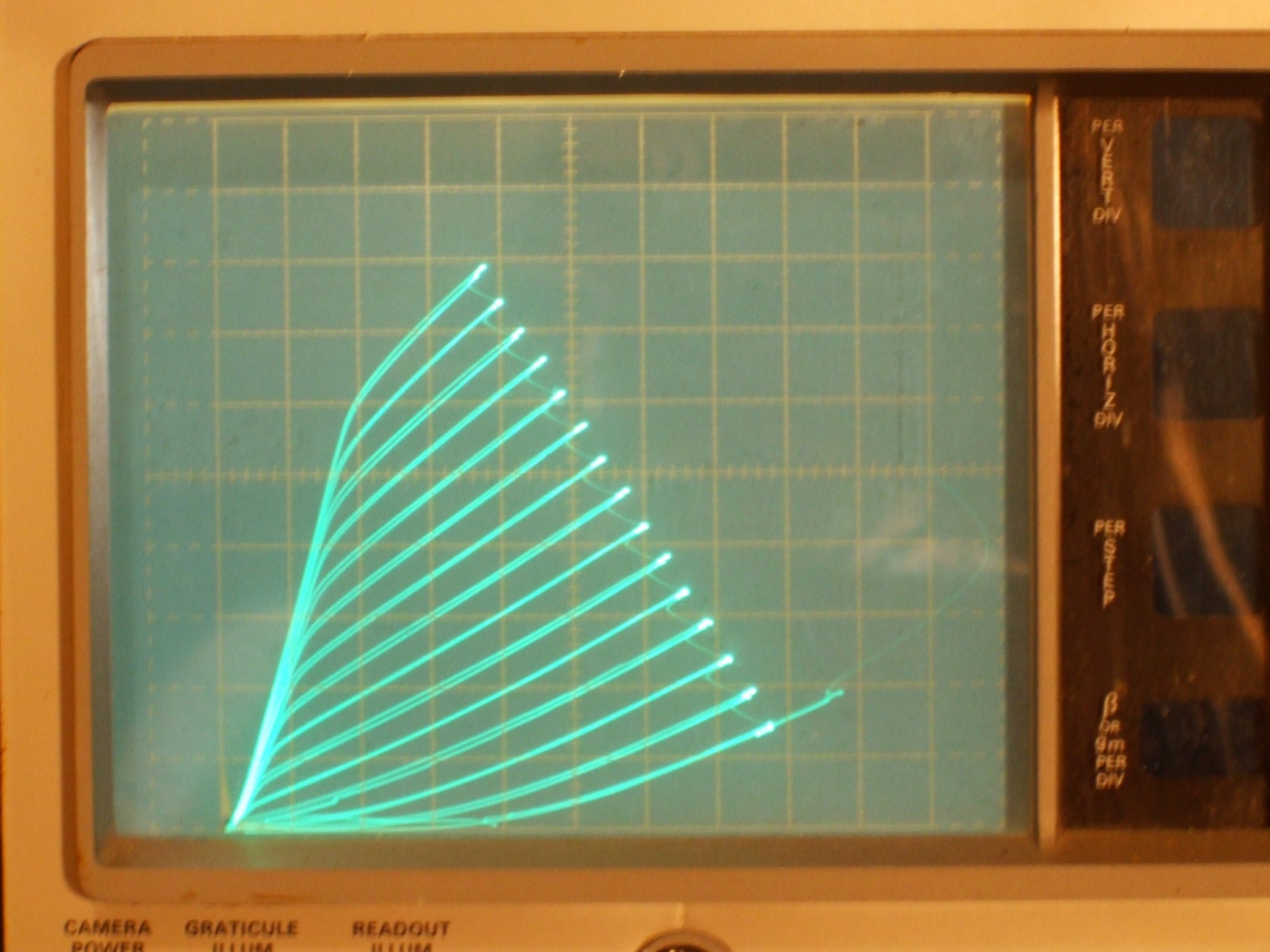

"New" 30 to 35 Watt COMPACTRON kids on the block for output tubes, 6JD5, 6HZ5, 6JH5, 6HV5, 6HS5, 6JK5 TV Beam Triodes with special "Flat Plates".
Most of the Beam Triodes around have traditionally been limited to Multi-KV use for Electro Static speaker Amps. But a select group of these tubes have a different plate structure that allows use at as low as 600V B+ (When using up to 6V positive grid drive). They have the bog standard old fashioned flat plate near to the beam plate.
While the multi-KV types have a long "boxlet" or "cavity" at the sheet metal joint facing the electron beam, next to the plate supports. Pics below. These "boxlets" or "cavities" normally have a couple of Barkhausen fins inside them to eliminate secondary electrons by multiple reflections within. Many Horiz. Sweep tubes have them. with resulting smaller kinks in their plate curves. Unfortunately, the Beam Triode tubes are missing the Barkhausen fins inside, leaving just the empty boxlet, placing the exposed plate (thru the beam plate slot) more than 2 or 3x as far away from the grid/cathode assembly, Leading to the multi-KV plate voltage requirement.
The "Flat Plate" Beam Triodes seem to be largely confined to RCA types, but NOT ALL RCA types are that way. A few Sylvania and Zenith tubes have the flat plates too. Oddly, all of them have round "ventilation" holes (ha-ha) in the skinny plate edges. (helpful for IDing them)
I have one odd case of a Zenith tube that has a "thin" boxlet/cavity (room for just -one- Barkhausen fin inside, but no fin present) that tests quite -near- to the flat plate tube curves. It has the more common square "ventilation" holes along the skinny plate edge.
Oh, another point to keep in mind with these is a typical 7500 Ohm Ri for the plate. (the 4600 Ohm Ri on the datasheets is at a pulsed 300 mA) I just got an 8K OT in to try these in a 2+2 parallel P-P class AB 100 Watt amp. Since the frame grid 1 is being used in positive territory, +6V, 200 mA, with 1.2 peak grid Watts, I plan to drop the heater power down by a Watt to compensate.
A) flat plate pic
B) usual Boxlet/Cavity plate

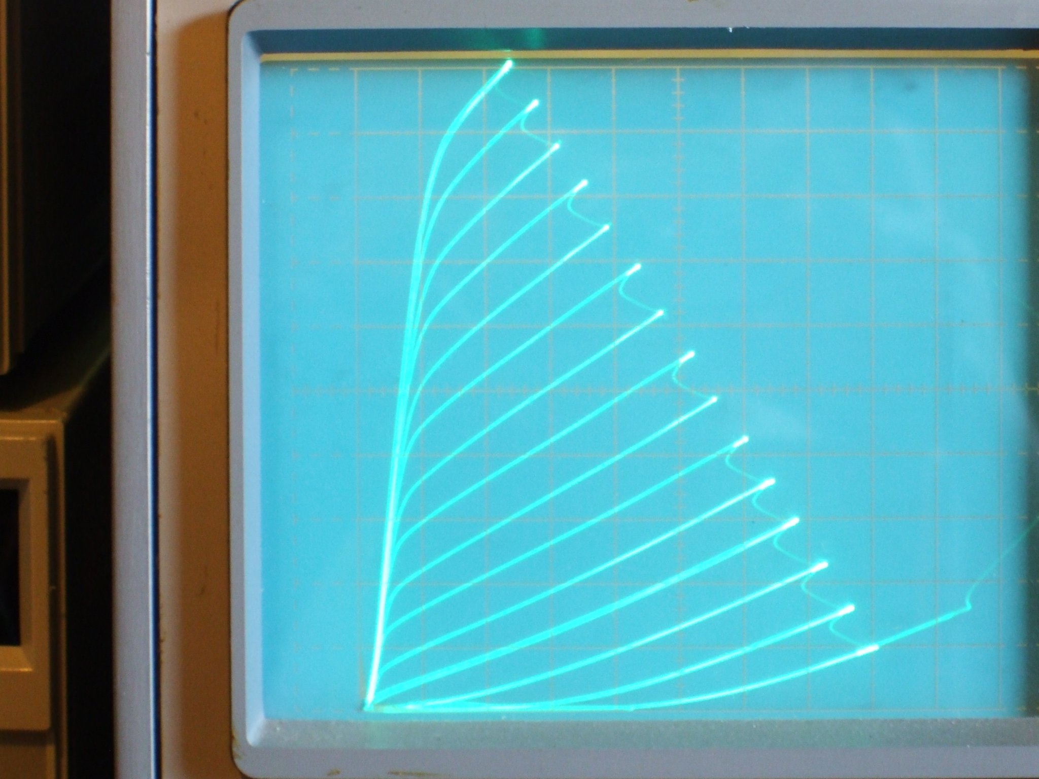

C) Flat Plate curves 20 mA/div Vert., 100V/div Horizontal, +0.5V grid steps, 4th curve up is 0V on grid 1
D) usual Boxlet/Cavity type plate curves, same 20 mA/div Vert., 100V/div Horizontal, +0.5V grid steps, 4th curve up is 0V on grid 1
E) Flat Plate curves with a HV Mosfet driver combining grid current with plate current for lower "knee" voltages. Excellent curves!

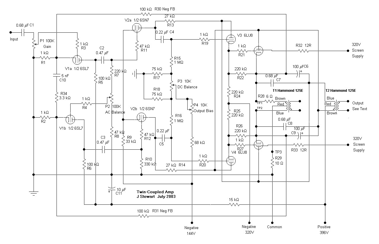

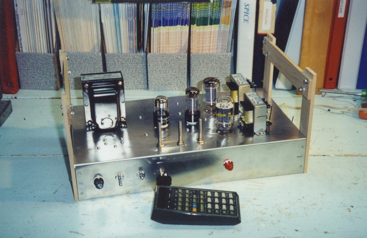

I did a version of Crowhurst's Twin Coupled Amp with a pair of 6LU8s.
~35W on 400V plates, 300V on G2s. So Unity Coupled just like a McIntosh,
but this one also partial UL. Very good measurement results on the bench.

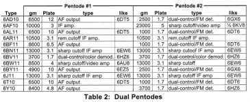

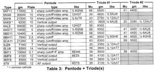

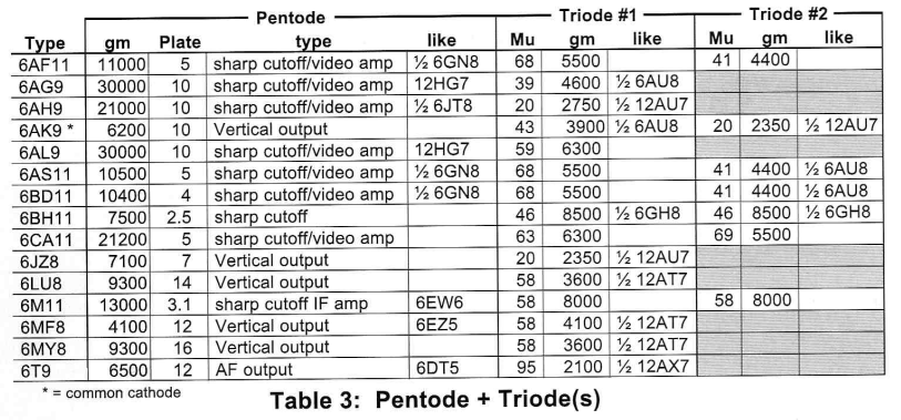

Somewhere I remember reading that the pentode in a 6LU8 / 6LR8 is a 6EZ5 ...
Not so, the pentode in 6LU8 has gm 9.3 mA/V while 6EZ5 is only half of that 4.1 mA/V ...
its the 6MF8 which contains a 6EZ5, though;

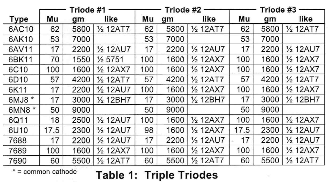

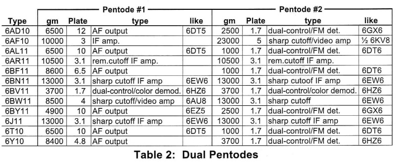

also, some more nice compactron tables ...
  • Compactron_Survey_v1-06.pdf
