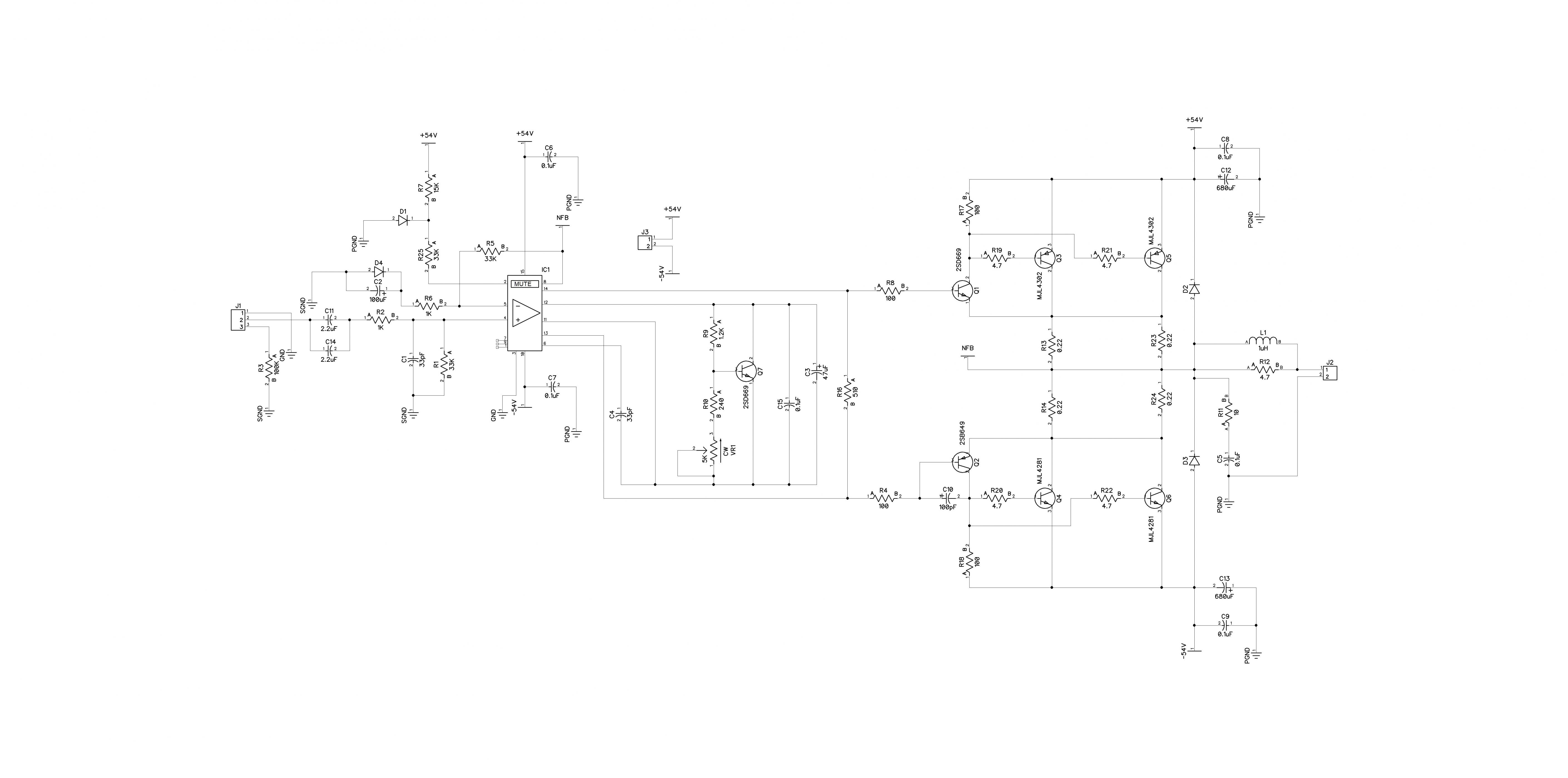

I want to make a 2nd generation of this amp board. A Baker clamp as shown in Fig. 17.2 of Bob's book is being considered for LME49811. A sketch is show below. Any comment?

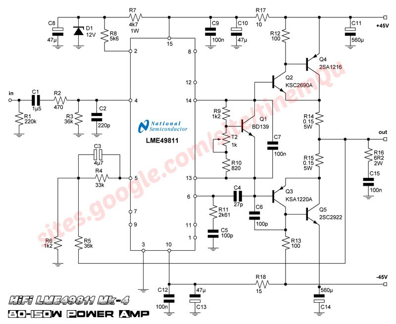

Hi Panson,
I just started considering building an amp based on LME49811 and ThermalTrack transistors and I saw that you have that already built for me 😉
However, there is one thing that I've noticed. Have you considered the difference between temperature coefficient of the junction voltage in MUR120 (the diode part) which is 1.7mV/C and NJL3281 which is 2.1mV/C ? I am not sure if that matters in the real life application, however Bob Cordell in his Designing Audio Power Ams, pg. 305 and after that thinks that it matters.
His suggestion is introducing compensator added to the bias transistor that involves (in one suggested setup) 4 resistors and 1 low-power transistor.

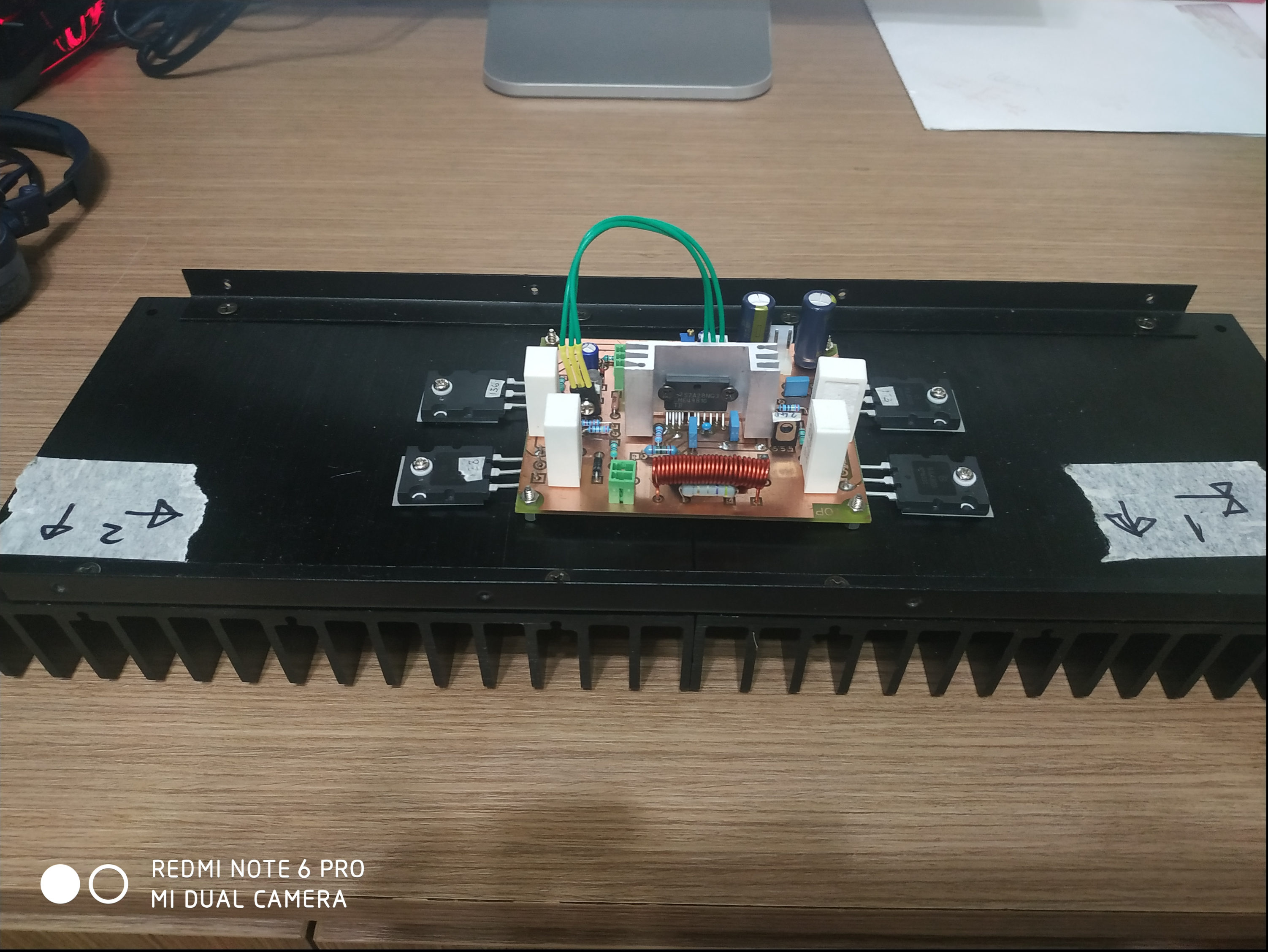

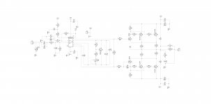

I am able to source some chips from taobao and build amps around them. I run into trouble with a CFP design with +/- 54 volts. The 49810 chip is hot to touch and the sound coming out from the amp is only bearable. Something is definitely wrong with the design. The chips are genuine, as I have built good sounding amps with the batch. I want to spice the thing before going any further. There used to be TINA-Ti models around but the link is now dead. Is there anyone with the SPICE file for either 49810 or 49811? Thank you.

Hi KK,
Honestly I would rely on the SPICE model of the chip. Do you have heatsink for the chip?
How about lower rail voltage? Do you have a scope to check the output?
Hi Panson,
There is a heat sink behind the 49810 chip. A while back I did a single pair version of this on +30v/-30v with no issues. This time I want more power to drive a 10" bass unit in a 2-way setup, so I go for the parallel. I have 8mv running between the outputs. The drivers and the outputs are stone cold. But the circuit is not stable. The voltage dropped from 108 rail to rail to 99 -101 rail to rail when the amp is connected. Somewhere there is a big drain of current. I want to sim the circuit so that I have voltage figures to check against the real thing. In the mean time, I will probe some more.
KK
