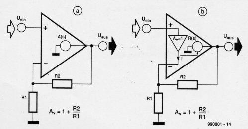

Picture is taken from an Elektor article about their high power amplifier. (a) is conventional, (b) is what they and what I call CFB, as implemented in the schematic from the first post and all current Accuphase gear.
AMT,
This is a nice picture of two VF amplifier circuits, one with a high impedance inverting input, the other with a low-Z ni input. Sorry. That's the decades-old definition. I cannot be made responsible for marketing ploys and ignorance of magazine editors.

The Elektor is a voltage amplifier where a sample of the output voltage used to generate an error current. Which is CFB to my mind.
The terms Voltage feedback and Current feedback are related to the output of the system, and not the way the feedback signal is represented (voltage or current)
I disagree. The FB signal may be represented as voltage (VFB) or current (CFB) to the input stage, depending on circuit topology. This goes for FB in both voltage and transconductance stages.
