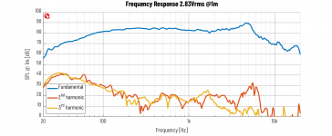

I'm still considering adding PRs, but as I'm currently getting response down to 30Hz in-room, it seems difficult to find PRs that would extend the response low enough. A single PTT4.0PR seems like the only choice, but for similar cost I could just get another Sub120 and have proper force-canceling etc.

Yeah I've modeled pretty much every 4" PR there is and relative to 100Hz, the max SPL at 40Hz is already down by 10dB or so in the ~2liters I have available, even with max added weight. Max SPL for some setups:
Blue: 2xSub120
Thin yellow: single PTT4PR
Bold yellow: SB12PFCR-00
Green: Vented Sub120 tuned to 35Hz (not a fair comparison as vent volume is not accounted for)
Blue: 2xSub120
