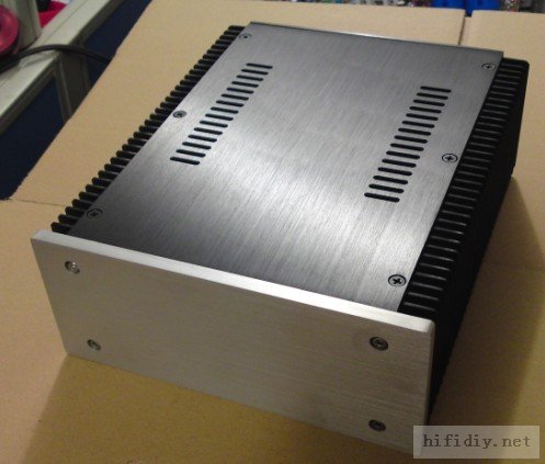

The constraint is height of the enclosure, using aluminum Chinese amp enclosures w/heatsinks.
Mid-sized are (2.5") 64mm and 3.3" (84mm) internal height (of the heatsinks) and seem popular.

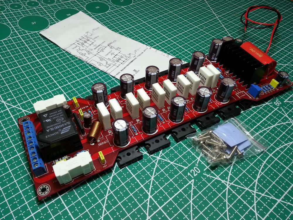

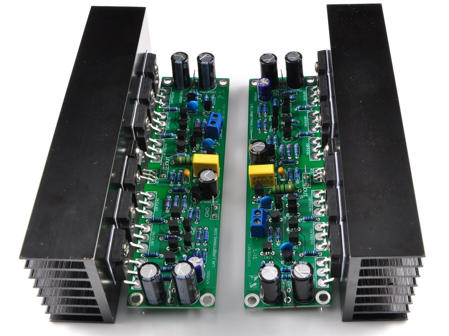

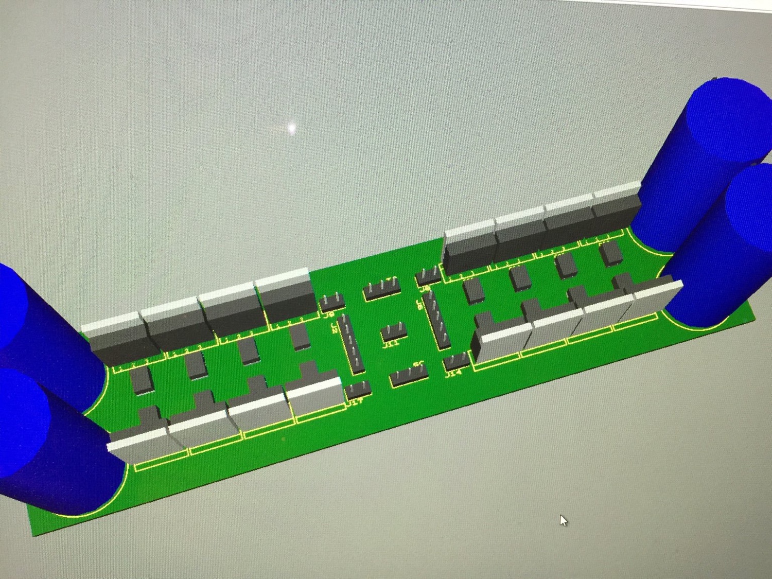

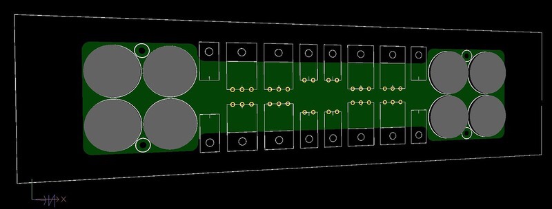

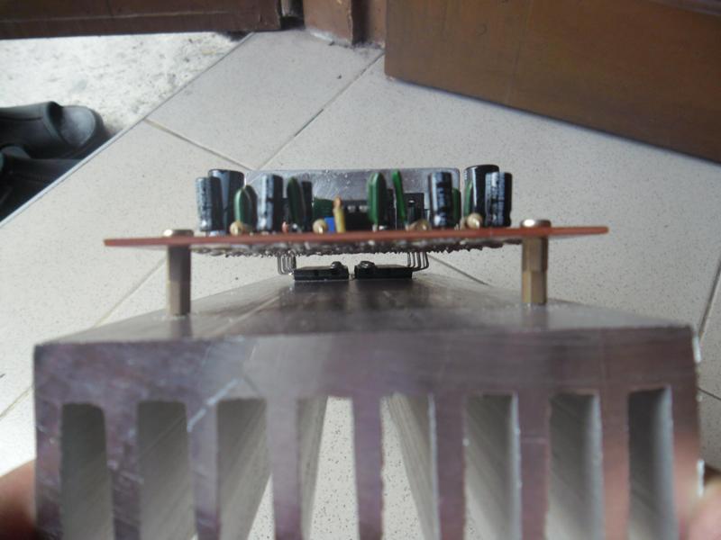

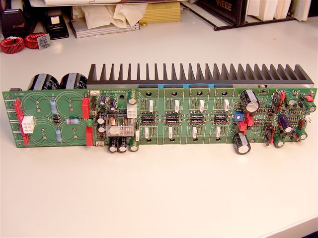

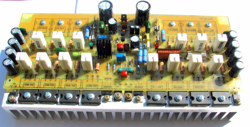

I was laying out a PC board and kept flipping between L-shaped and pancake configuration for output transistors and couldn't commit.
Almost all possibilities are hell mounting output transistors underneath the PC board. It looked hard to center the insulator and can't see replacing one without gutting the amp.
Possibilities could also be using TO-220 output transistors i.e FJP5200 or down-sizing to a single pair, for a reduced power version.
A SMT design did not offer much (aside from the joy of hand matching SOT-23's); the electrolytic capacitors, emitter resistors, VAS heatsinks eat up any height savings. Probably put the protection circuit on a separate PCB.
Here are pics of various amplifier PC boards just for looking at overall configuration and ideas.

  • alum enclosure external dimensions W211mm H90mm D257mm_Internal W161mm H84mm D246mm.jpg
Yes, with near 2U height you can route good OPS for around 80-130 Wt/8 Ohm.
Heatsink dissipation are proportional to square root from height, so it’s probably better to have 2U 400 mm depth case than 3U 300 mm depth.
Try similar layouts:
with TO-247
with TO-220
IPS/VAS could be done as mesonine board, and in case of bigger dissipation it could be heatsinked via bottom (or front) aluminium panel.
