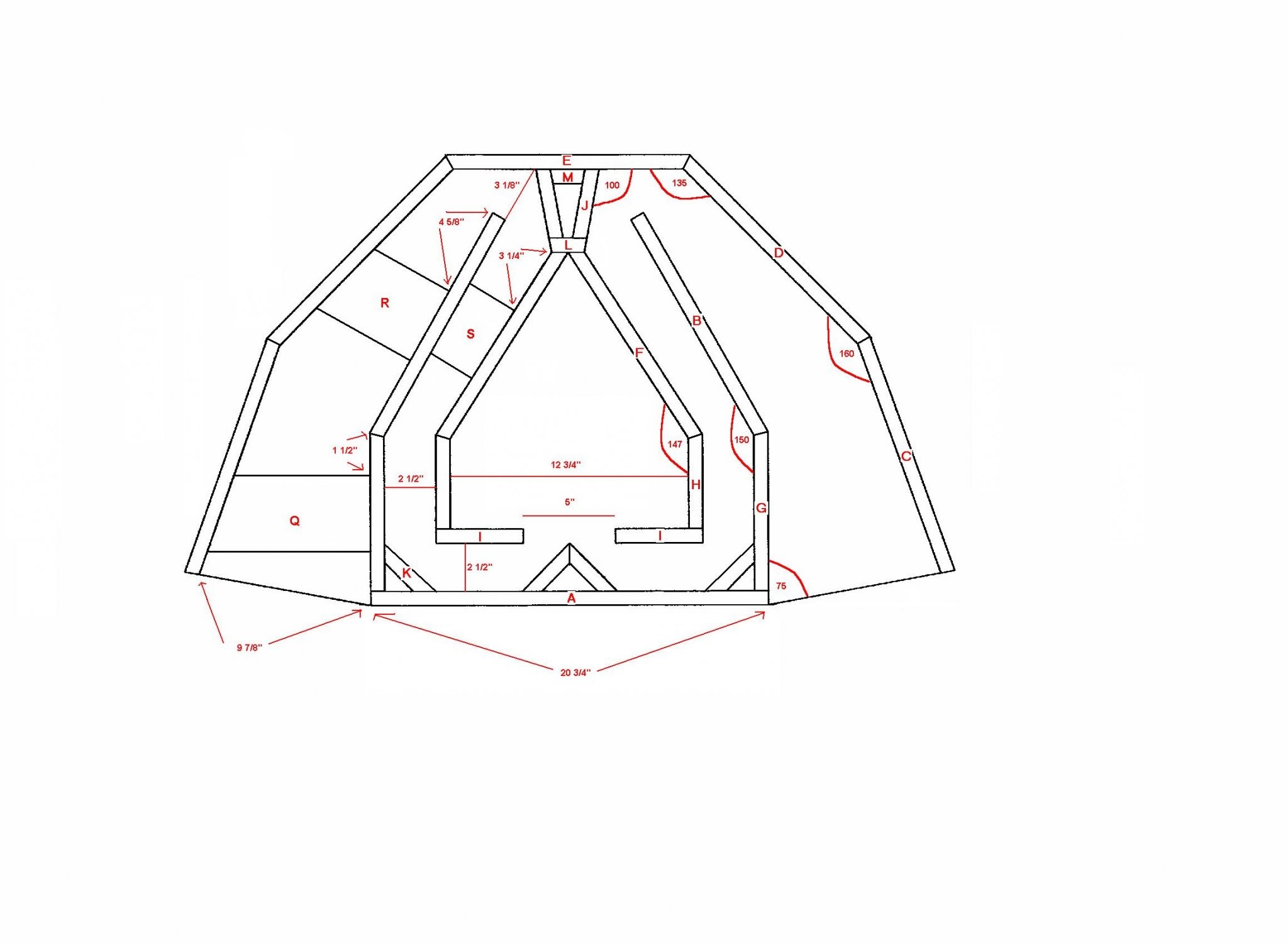

The Jubilee bass bins would fit in the same space as the Super Heresys. Actually less floor space, since they would be against the back wall, toed in slightly. You'd have to move the booze and lamp on the R and two wall framed photos on the L, but it would work. Keep in mind that the Jubilee does NOT need a corner to work well. With so much cone area, you can boost the bass below 30-40 Hz. to make up for the You can PM your Email, and I'll send both horn plans for you to study. The rewards are worth it, trust me. Besides you have the skills to do build those. I had mine in a 11.5 x 16 ft. room. They would work well against either side of your cabinet, no problem.
