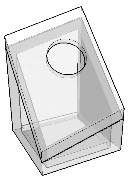

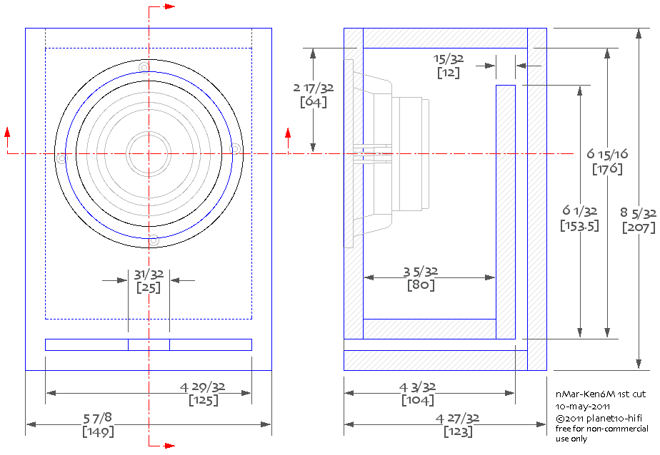

The goal for these was the smallest size enclosure possible with at least a modicom of bass. Sims suggest <80 Hz (volume limited by size/excursion).
Neither of these have been built yet, The slot port version is the 1st cut at a nMar-Ken6M. drawn with 12mm material, good multiply recommended.

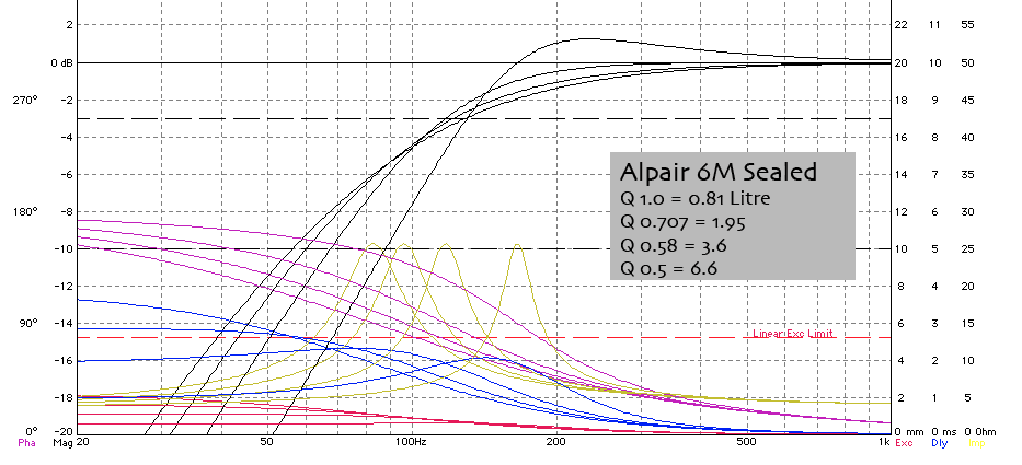

If it only goes to 80Hz, wouldn't it be better to leave it sealed and cross 1st order with a sub ?
Patrick
Patrick
Nice Dave! 80hz would make these excellent surrounds or even as mains in a smaller system. Very cool!
Looked at the sims again... 80 hz might be a bit optimistic, 70 Hz F10, slot port should get you a bit lower with a bit less bump than the round port. The uMar-Ken6 (which accomodates either A6P or A6M) is about 60% larger should get you to the magic 80. The full-size miniOnken for A6M looks like it will be based on 3.5-3.6 litre (still in development)

well, he's still looking at the drawing and brainstorming* the easiest way to fabricate an mirror imaged pair of enclosures with compound angles
I bet no nails and the 12" slider figure into it somehow
(*considering the remaining computational power, you'd only need a windbreaker )

We built the big enclosure (3.6L) for the A6M. Works well.
