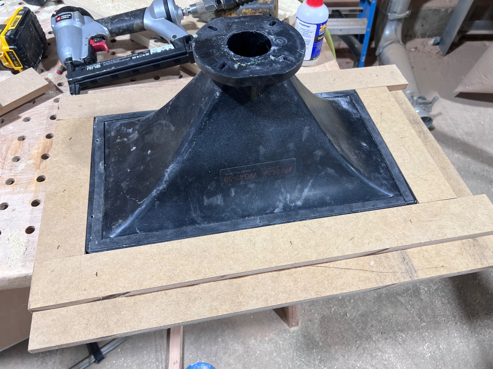

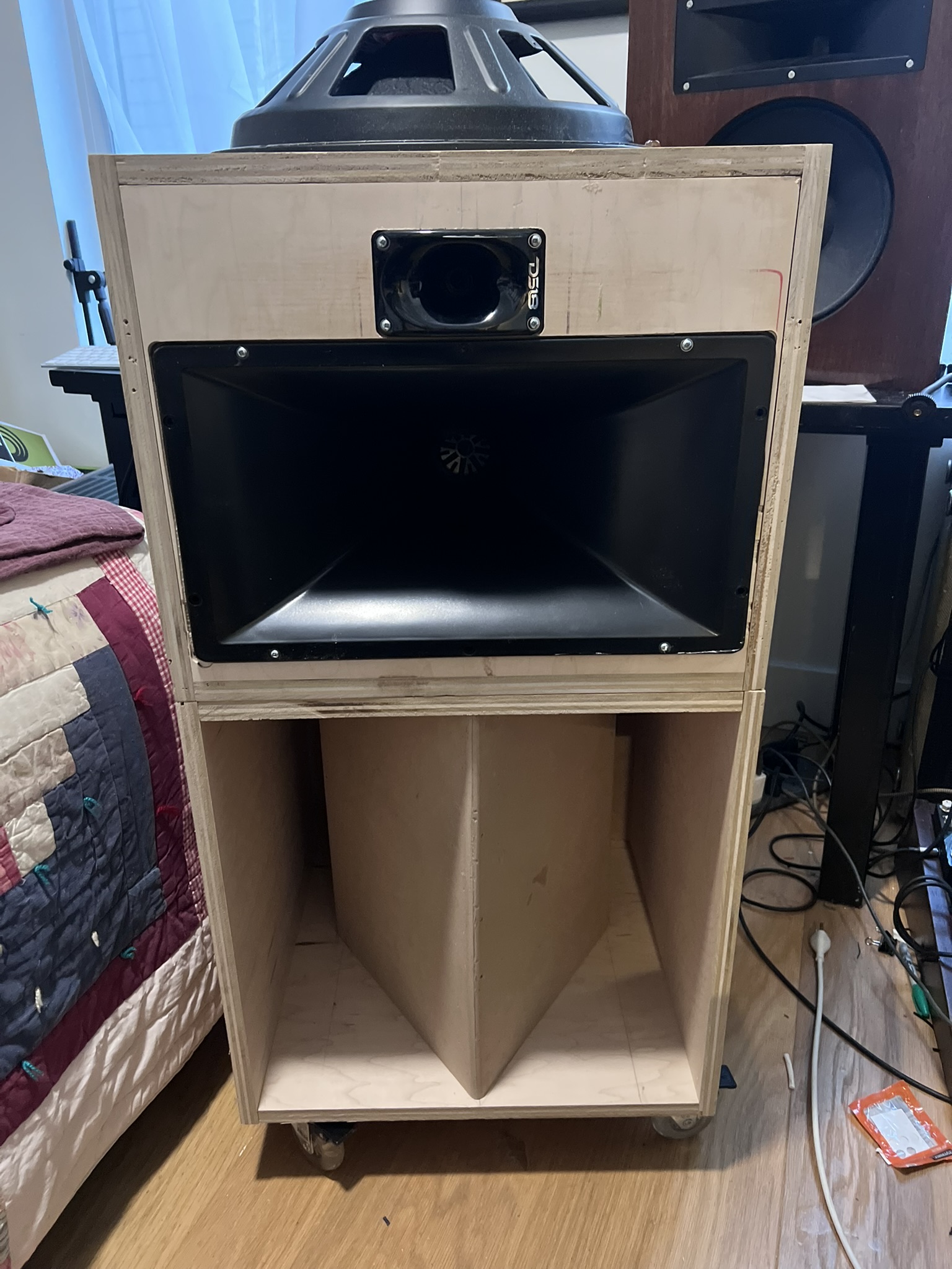

I've begun with the LF enclosure, starting with the doghouse:
the scaled down version will use a 12" 8Ω driver, as opposed to the 15" JBL2225H used in my large 3-way, with a cabinet volume between the doghouse woofer enclosure and the coupled upper enclosure going in at approximately 4.5 cu ft or 127L. I've made multiple motor boards for the upper enclosure, allowing for either a 2-way or 3-way alignment, with the PRV WG4550 mid horn and a P Audio/Lase BD-M750 for two-way, or the same wave guide and PRV's D2200Ph driver and an elliptical tweeter lens with a B&C DE-10 driver up top in 3-way configuration, both crossed over at 500Hz, as the large horn seems to lose directivity below 475Hz. and either a passive network, Dayton DSP-408 active crossover or a combination thereof:

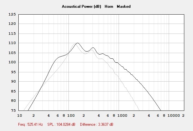

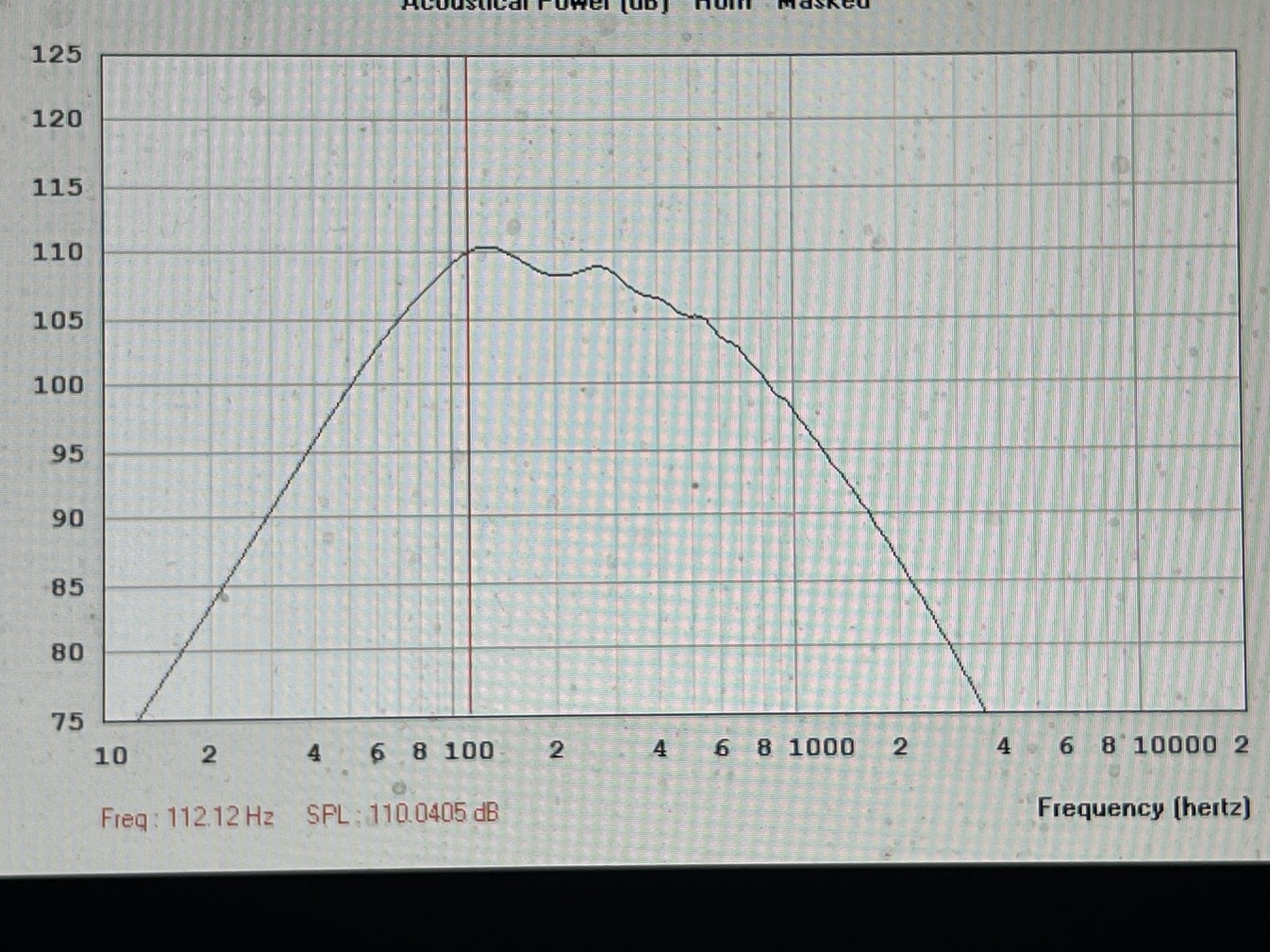

rough simulations in HornResp with a generic diver:
this leaves me with the challenge of a driver that will work well enough in a bass reflex enclosure with a 15 rear mounted passive to allow extension to 32Hz or so.

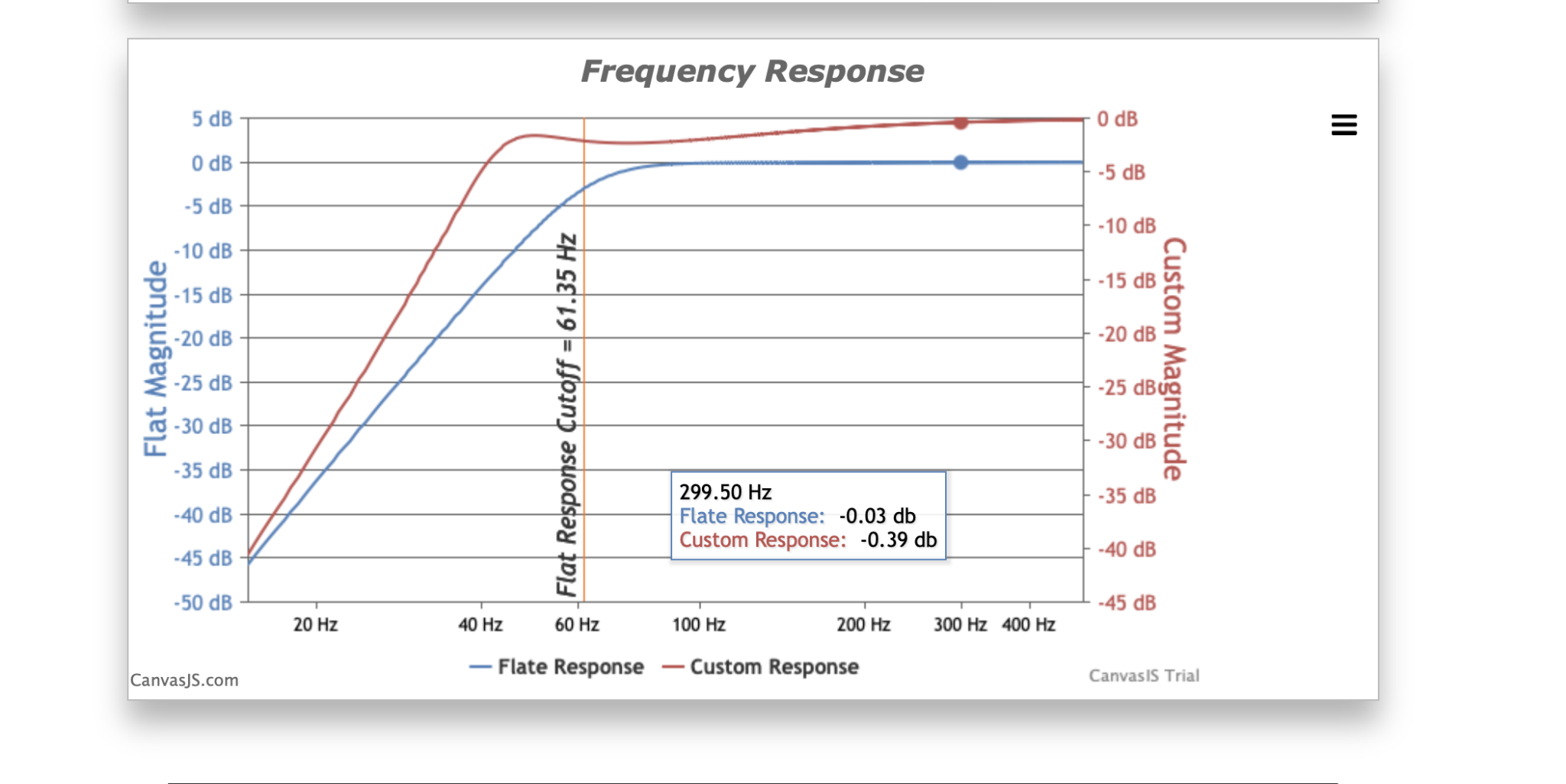

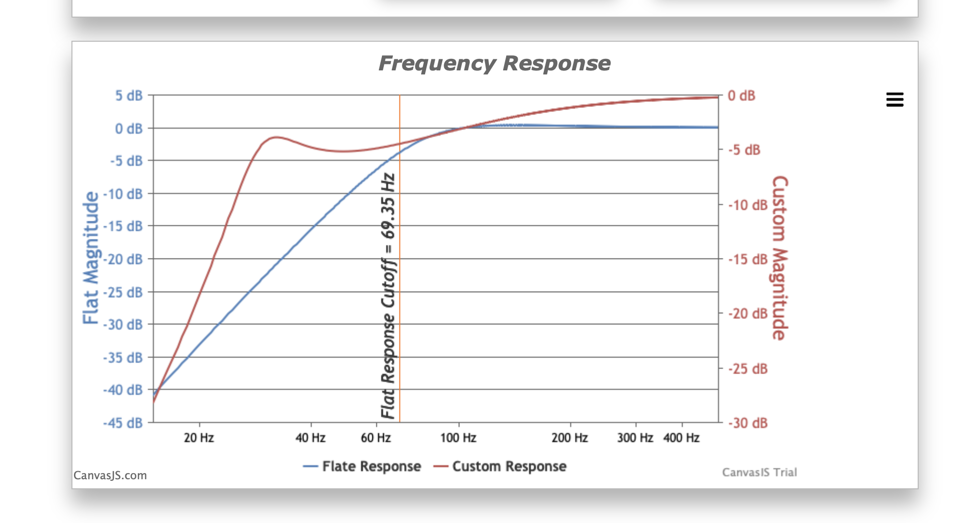

I began with my first driver sim, using the Eminence Delta Pro 12A, which I have on hand which is roughy equivalent to the Klipsch K28 and a 4" port in lieu of a passive:
with a roll-off at 40Hz, the performance isn't acceptable for my goals, but it forms a baseline for comparison.

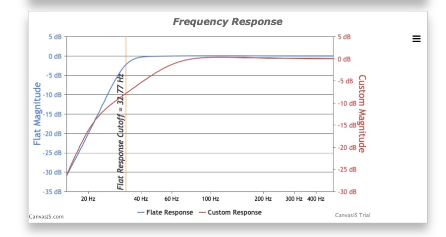

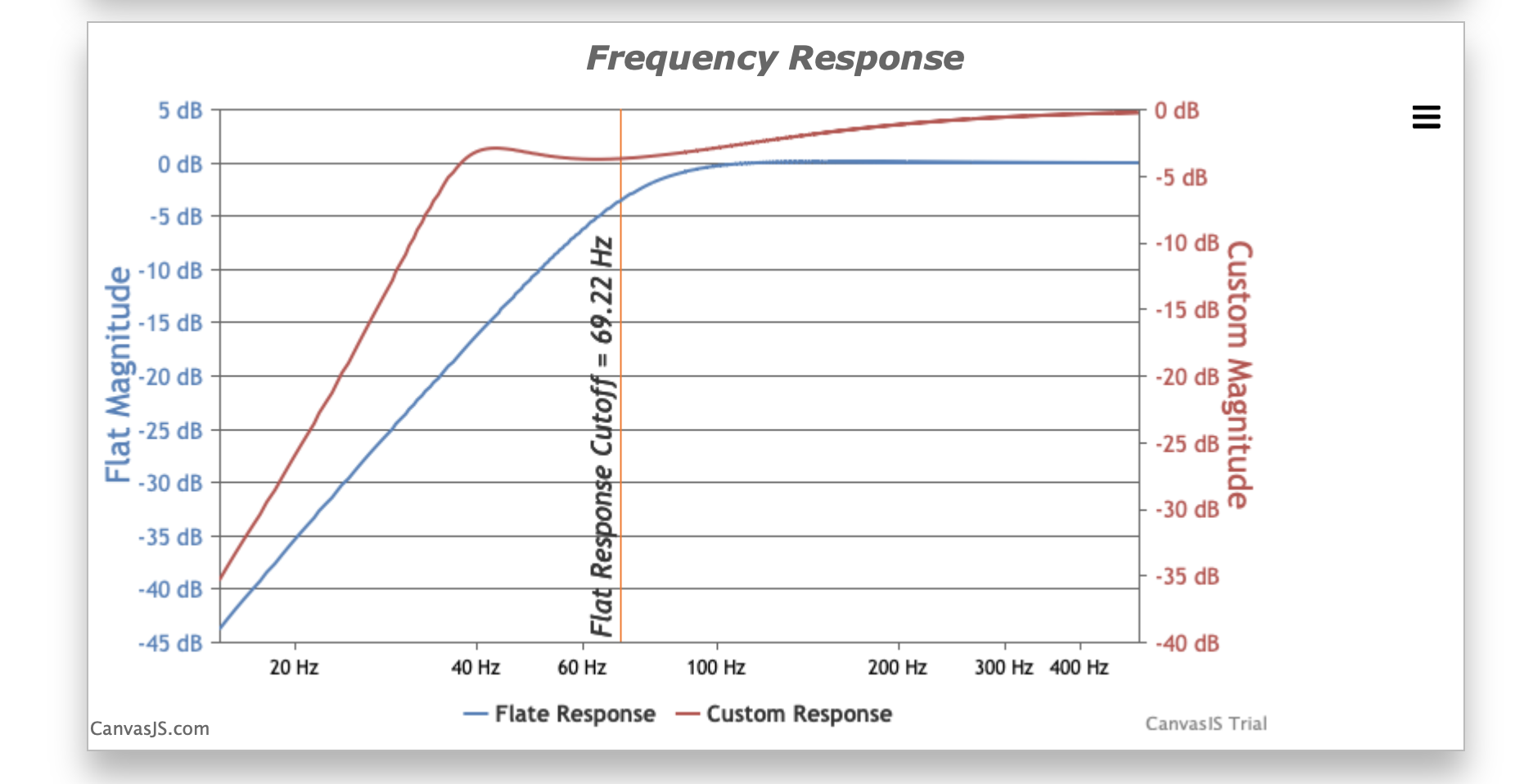

ext up is the Dayton Audio Odeon 12N, which I had been favoring:
LF rollout begins at 38Hz, which would put it at roughly equivalent to the Klipsch Forte, which is broadly acceptable, but short of our goal of 22Hz.

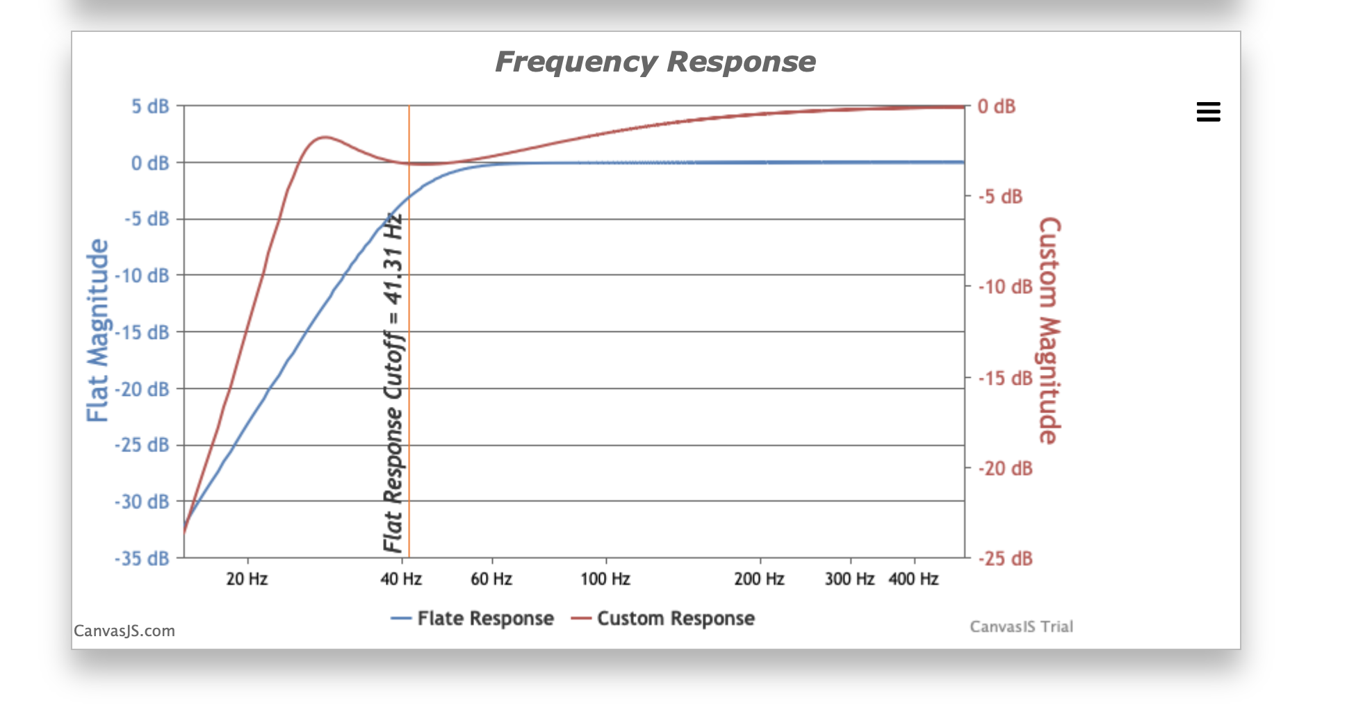

next on deck is the Dayton Audio Odeon 12LF:
LF extension goes to 30Hz, which is great, but it also has a dip between 69Hz and the low frequency cutoff, and a rising rate after about 120Hz and is down 4.5dB in sensitivity compared to the Delta Pro 12a and 2dB below the Odeon 12N, which is sub optimal.

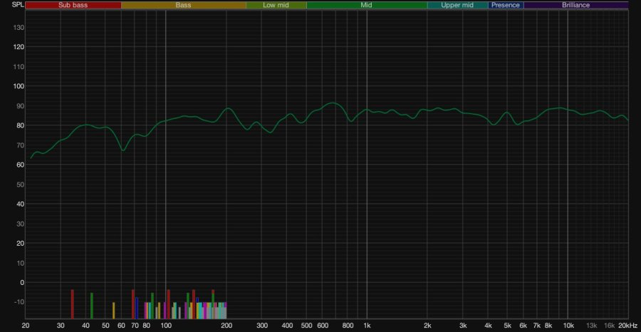

I brought the horn home yesterday for measurement:

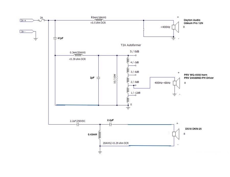

After wiring up the innards, I threw a very hastily improvised network together:
and ran a sweep:
The 60Hz standing wave in my 10'x11' spare bedroom not withstanding, I'm pleasantly shocked that it measured as well as it did on my first try with a network that I literally threw together at the last minute.
The low frequency rolled off at the bottom in the mid 30's, without the benefit of corner loading! I put on Bela Fleck and Flecktones and every bit of Victor Wooten's baseline were there. While the bass wasn't as authoritative as my big horns, which extend to 20Hz, it had considerable presence.
I'll put together a proper network, clear out a corner and get more measurements, soon.
