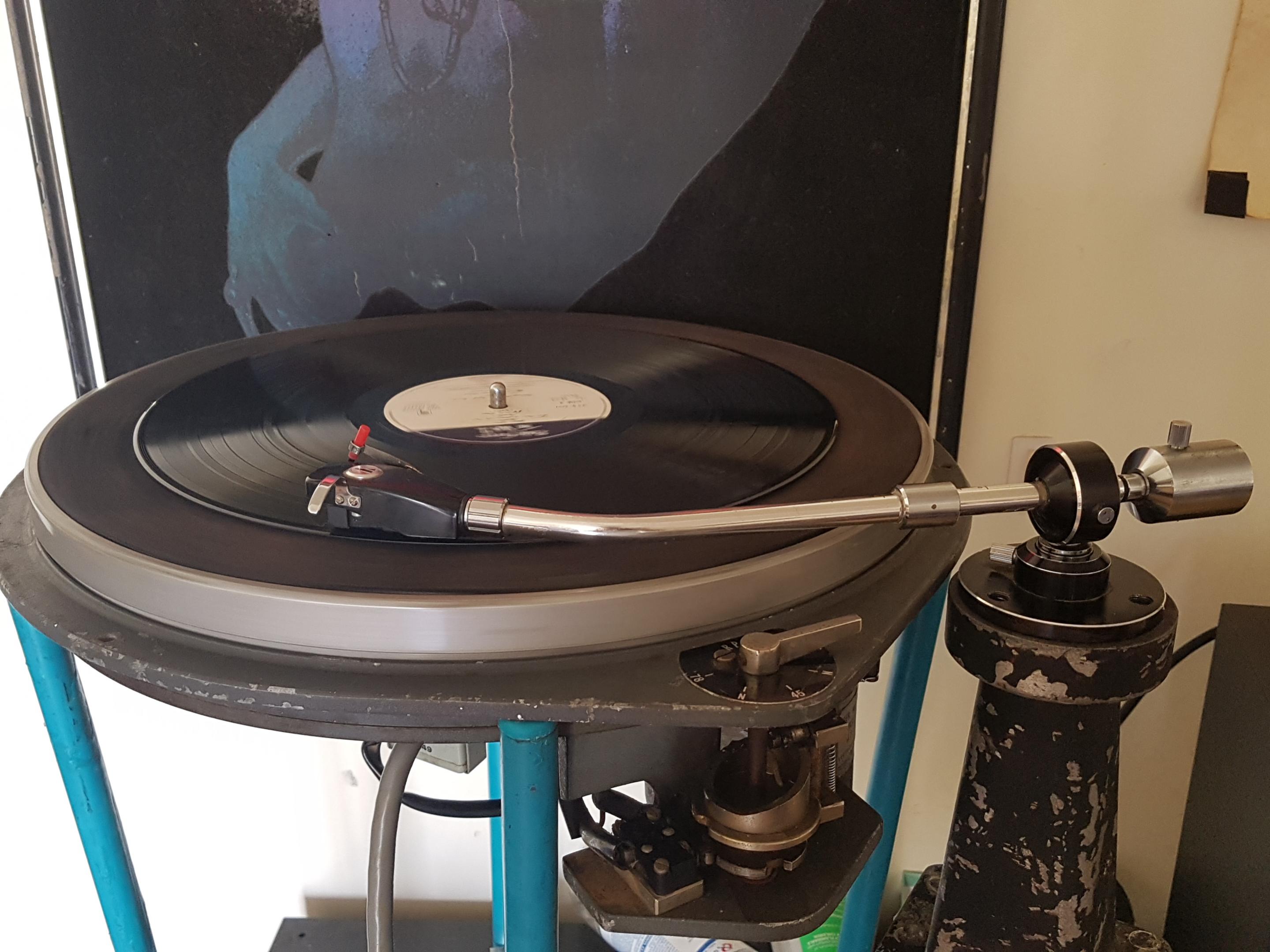

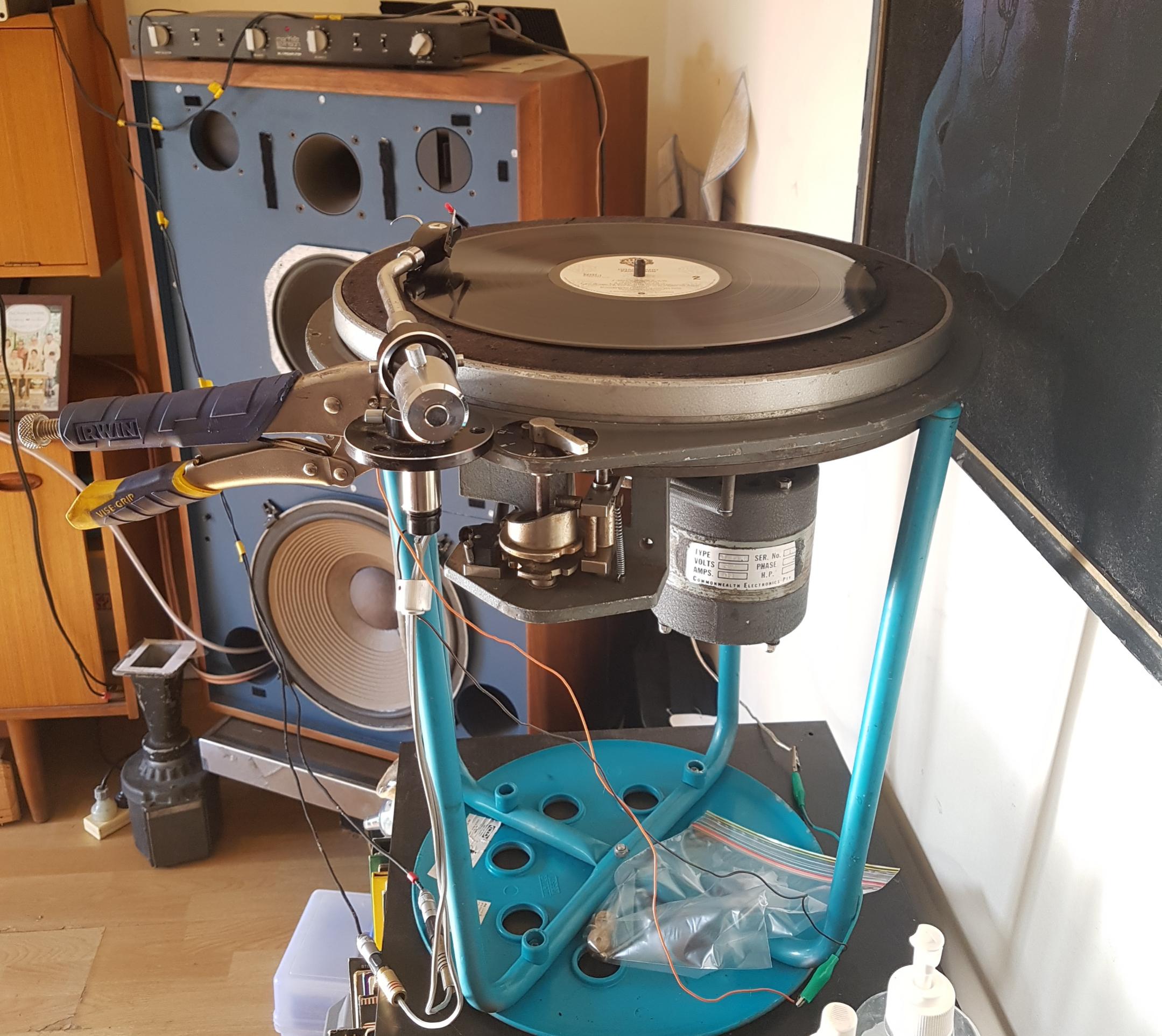

I recently got one of these. Have been spending the past few days bringing it back to life. It actually sounds superb. Better than my sondek. Only issue is some rumble. Just wondering if anyone has had experience tweaking out the rumble from this idle drive beast.
I think the source is the platter and the ball bearing it sits on. The rumble is getting transmitted into the needle from the platter as its not present when the arm is up. Are there any good mats that can reduce rumble?
Yes thats a vice grip holding the tonearm onto the rim of the turntable, yes thats un upside down ikea stool being used as a plinth. thats a 9" audio technica broadcast arm. My intent is to make a slate plinth and use an sme 3012 12" arm. This is just a quick and dirty rig to get it working. But to my suprise it sounds very very good.

I take you have cleaned and lubed the beatings etc.
Could it be due to the arm being mounted straight to the aluminium chassis?
I'd try something between armbase and chassis and between vice grip and chassis: wood, plastic, rubber?
regards
james
Hi James, nk I havent cleaned and lubed. There was some lube still the. Do you know what to use? Motor oil, machine grease?
Reason I don't think it's the chassis mounting is that its dead quiet when arm is up, and obviously still mounted to chassis. But I will try whay you suggest as well.

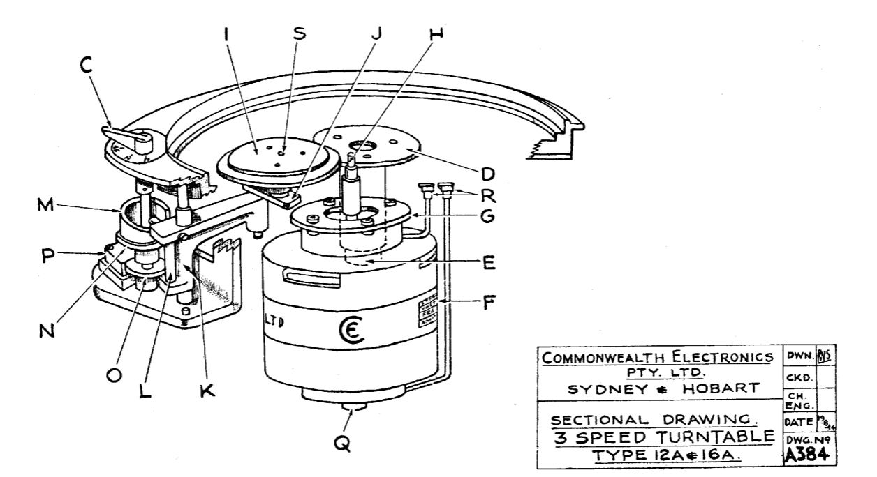

Ah thanks so much for the link to the manual for the 16A. That is a huge help. it seems my issues are more related to the Idler wheel. It's either the alignment of it (ie how parallel it is to the Chassis) or perhaps a flat spot on the tyre of the Idler wheel itself. So I'm going through a process of elimination starting with sorting out the alignment.
With the platter off it's possible to put my ear against the chassis. The noise I was hearing (ie a repeating faint beat) is apparent without the platter attached. So I now know it's not the platter bearing.
In order to adjust the idler wheel alignment, a small aluminium linkage (the manual refers to as the "Dural" Linkage, "J" in the attached image) must be bent. This issue of misalignment is refered to as "Scrubbing" in the manual. So I've just spent the past 45mins removing the Dural vice clamping to my balcony rail and carefully bending it, reinstalling it, then checling the alignment against the chassis with the edge of a 600mm steel ruler. A painstaking process that I haven't yet got right. The Dural is a rugged little metal part that's tricky bend accurately. I typically overshoot or undershoot the bend.
Once I've adressed the alignment issue as best I can, If the issue is still persisting I will need to progress to grinding the Tyre of the IDler Wheel. I fortunately have a precision lathe, and If anyone has done this job before I'd appreciate any tips. e.g. do you use sandpaper to grind the wheel?

These are very, very nice tables, great score. A high mass lossy plinth should reduce rumble significantly. (Plywood layered for example, or paperstone) They're rare here, but well regarded so I have seen a few.
As I recall the motor is mounted on bushings which may need replacement.
I would not do a whole lot of adjustment, etc. until it is properly plinthed - some of what you are proposing to do may be unnecessary.
I think you're absolutely right Kevinkr. I removed the arm from clamping it to the chassis rim and simply put it on a stand separate from the chassis. Big improvement already. Sounds great.

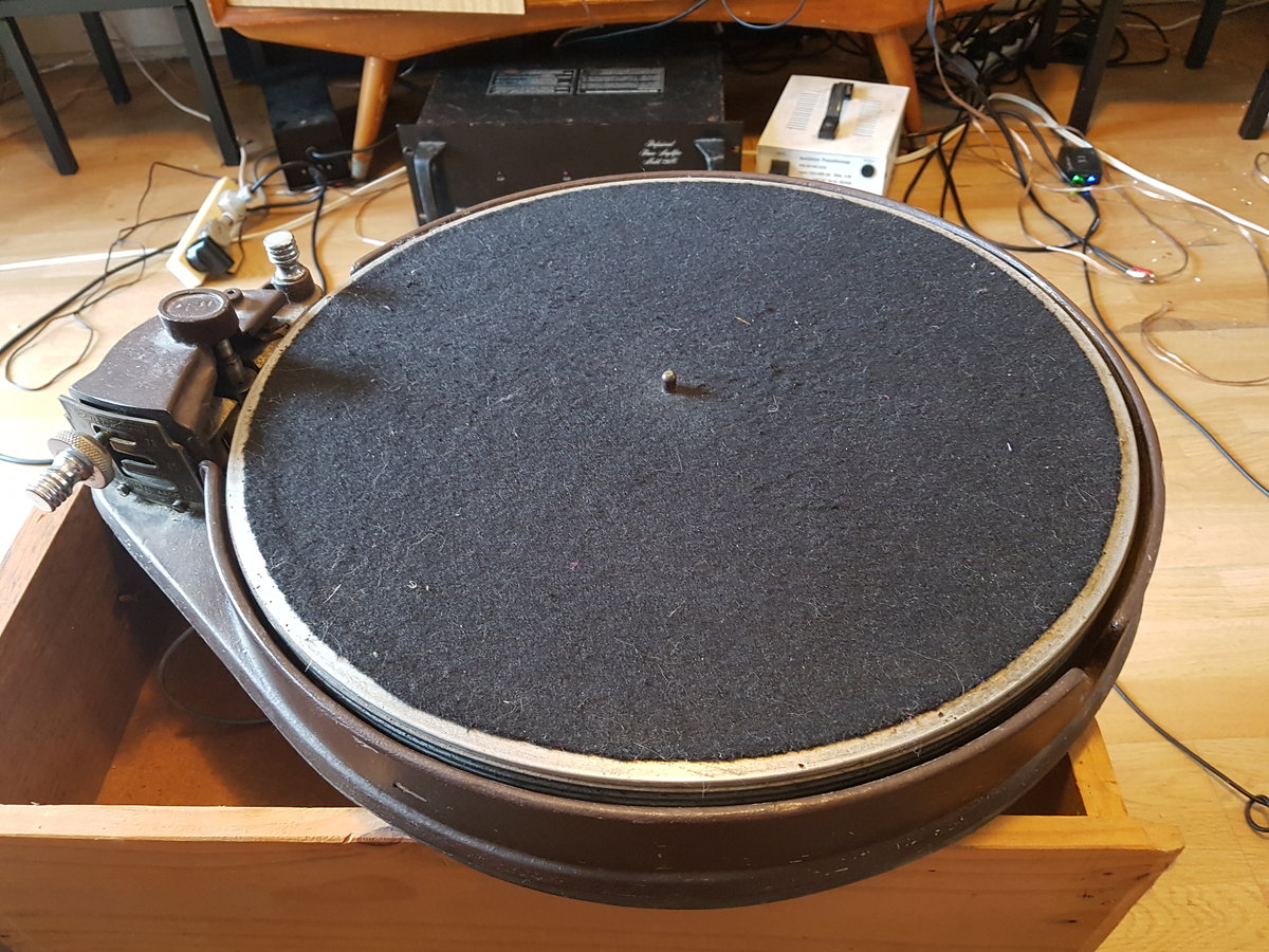

Cool sounds like you've got some great turntables running there. I also have 2 of these "Austral Argo" rim drive 16" tables. I've never seen another like them. These are also Aussie, but I think are essentially copies of a Presto design. Lots of fun these things.

goldjazz, nice table you have there. You say you have a precision lathe? Well you will need to mount the idler wheel and grind the face of it. I assume there is some sort of a bored hole or ball bearing in the center.
You need to have that center hole running dead true or max total indicated runout at 0.0005" or less. If the idler has a ball bearing, knock it out and chuck up a piece of aluminum and turn a diameter that will allow the idler to fit on with a snug fit. Tap a center hole and secure the idler with a bolt and washer. That will ensure that the idler is running dead true.
Sandpaper will only follow the contour of what is already there. You will need a toolpost grinder mounted into your tool post to grind the O.D. concentric to the bore. If need be, rig up a die grinder to fit into the tool post. Use the coarsest grinding stone you have. Take very light passes and allow the rubber to cool or it will expand with the heat and push into the wheel.
Just take your time and it should clean up like new. Take some pictures as you go along and share them with us. Yea, I used to be a tool maker in another life......
