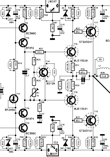

Elektor amp 5/97 output stage
Have you seen this kind of output stage and how do you feel about this? (think IGBT into bjt or MOSFET)
I think there are several plusses here. One can set the output stage for 2X or 4X voltage amplification for example. This in turn means that voltage amp stage does not have to have as much voltage swing and can be cascoded or have a stabilised supplies taken from primary supply....
And then think if there would only be the final and driver stage which would form a power amp with 14-20X voltage gain..... A friend of mine came up with such circuit and it's in my next four months or so todo list 🙂

I've no seen anything quite the same as this before but it looks like a variation of the Class A+B topology. T15 and 16 look to be a fairly standard output stage (probably class AB) whilst T16 and 17 presumably provide additional (Class B?) power. I note the somewhat unusual inclusion of R30 though, which I assume allows T16 and T17 to provide voltage gain too. It is this aspect that I regard as the most novel.
Note that the driver is already cascoded by T12 and 13.
Ian.

Output stage voltage gain is approx (R30+R29)/R29. Snip out R29 and s/c R30 and the gain drops back to unity. The ETI-480 amp used such a configuration but with bipolar outputs. I would expect the higher the gain the more critical the bias setting, i.e. you wind the pot to get some current and when it does start you would only have to *look* at the pot and it would alter the current a fair bit, depending on the gain.

Another advantage of the gain in the power stage is that the signal swing in the voltage amplifier stage is reduced. In this amp, it allows them to feed the Vas with an LM317/337. This makes for very cheap and simple stabilised supply for the pre-stages, rather than a more complex 40 or 50V stabilised supply if the output stage didn't have gain. Could that be actually the reason they put in the output stage gain?
