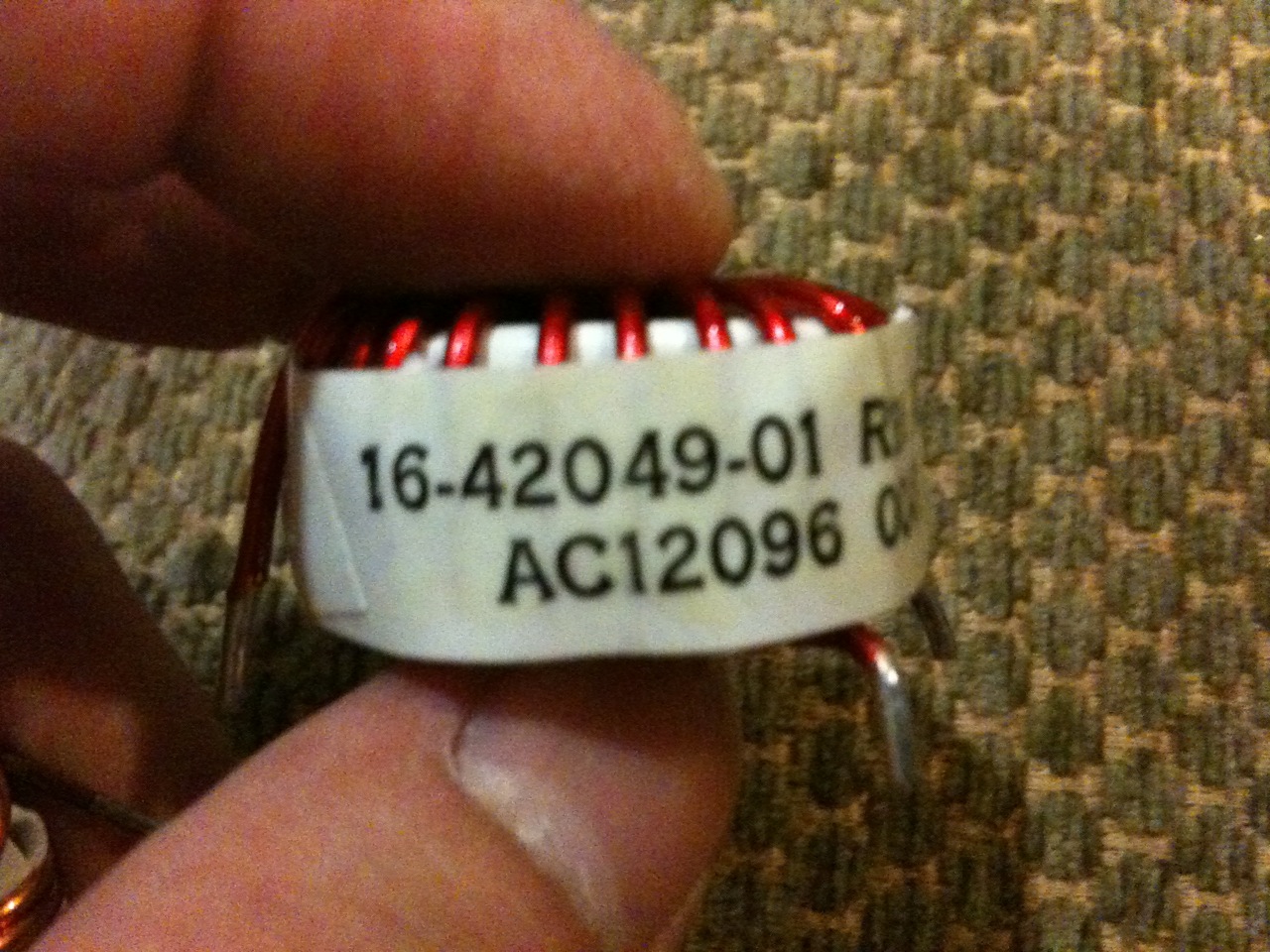

can someone help me make an intelligent guess on how much current can this common mode choke passes?
outer diameter is: 30mm
height is: 20mm
wire diameter is: 1.5mm
i saw in ebay the one thats almost the same with this has 0.5mH 20A
i wanna use this choke for less than 5A of +-35vdc. is this good for it?

Your core needs to be a low permeability core that will not saturate under DC current.
As Elvee points out, saturation isn't an issue for CMCs because they're designed to run with very low net flux. The magnetization of the two windings cancels out leaving a very low differential-mode inductance and a much higher common-mode one. Saturation only becomes an issue if the two currents become unbalanced. Low permeability cores though are very useful for filtering out higher frequencies (say above a few MHz) where the higher mu cores give up.

i can conclude that i can use these choke for the 5A circuit. thanks

F.ex. D-K has a Triad Magnetics 2mH 7.5A CMC for under $5: 237-1230-ND
I think what you'll find is that the 2mH is either a single coil's inductance or perhaps the common-mode inductance. It won't give you 2mH at 7.5A because as DF96 says its designed to work with the two coils in opposition. Try to use it as a normal choke (either with just one winding or with both windings in parallel) and it'll saturate long before you get anywhere near 7.5A. That explains why its so much cheaper than an air-cored choke. If you want to do CLC filtering I suggest looking for powdered iron cores - they have a useful increase in permeability over air and saturate at fairly high currents. Ferrites aren't a good choice unless the currents are fairly low.
