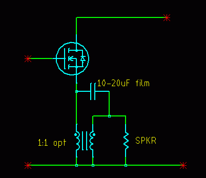

I tested IRFP240 as a source follower and it works well untill I have made it work into capacitive load i.e.8ohms+1uF. It exibited a lot of ringing (overshoot).
Just for fun I tryed output trasnsformer coupling with simple 1:1 bifilar prim/sec over ordinary iron for mains transformers.
Surprised I was! Almost no ringing, about the same as with best SE300B with high price output trafo!
7Hz...55 kHz, -3dB bandwidth with simple trafo! Distorsion is 0.1% up to 10W, second harmonics with traces of third.
I am building second channel to do some listening tests.
Will be back as soon I get some results...
This is interesting! Did you have the primary of the transformer as the only thing in the source lead and therefore have DC flowing in the primary? If you did, was there an airgap in the iron core? What power level did you measure the frequency at? Was it an EI or toroid transformer. Have I asked one too many questions? 😉

EI core 96x82x33mm outer dimensions, approx 9 cm sq,

If the transformer was from mosfet source to ground and the bottom end of the secondary was grounded and *only* if the transformer has 1:1 turns ratio then you could put a 10uF to 20uF film cap from the top of the primary winding to the top of the secondary winding to make the coupling virtually perfect. some peple may think that is not necessary, but if you are only making one for yourself then every little bit helps toward making it perfect.

Hi Cyclotron,
Yes, can do, but see what happens with ringing on capacitive load as this was the reason for transformer in the first trials with inductor + capacitor combination!
On the second thought I would suspect complex phase behaviour in this combination...
