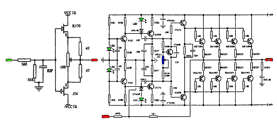

the input stage common-base allows to unify the gains of the two rails :D

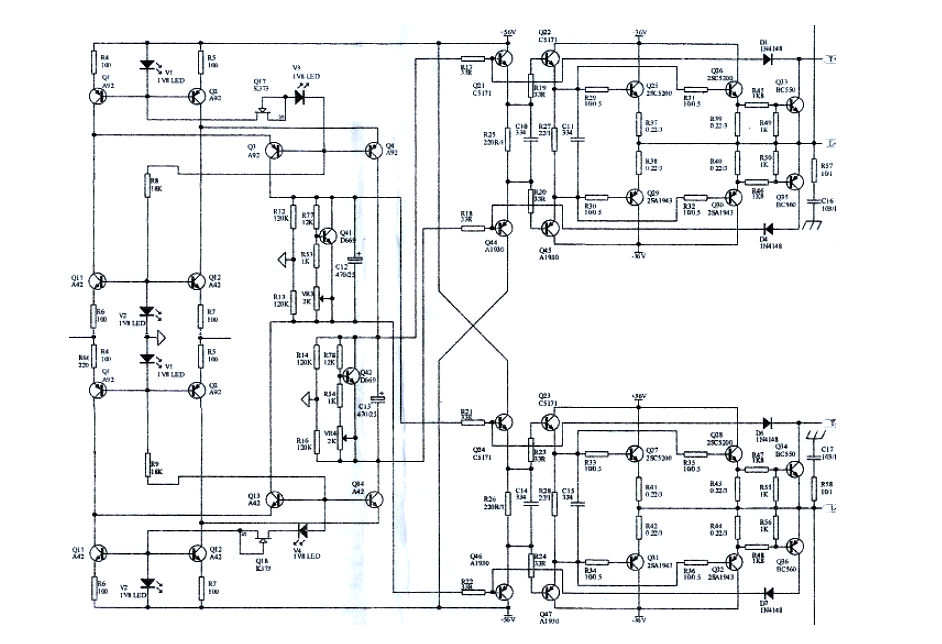

Stee Member Joined 2005 esafono.it 2013-03-11 6:22 pm #1 2013-03-11 6:22 pm #1 the input stage common-base allows to unify the gains of the two rails Attachments a700modFET.PNG 95.8 KB · Views: 158 ••• More options Share Stee Member Joined 2005 esafono.it 2013-03-14 5:03 pm #2 2013-03-14 5:03 pm #2 same for VAS common-base VAS allows to unify the gains of the two rails see this balanced project Attachments a680modCOMMON BASE.PNG 234 KB · Views: 116 ••• More options Share Show hidden low quality content Status This old topic is closed. If you want to reopen this topic, contact a moderator using the "Report Post" button.
