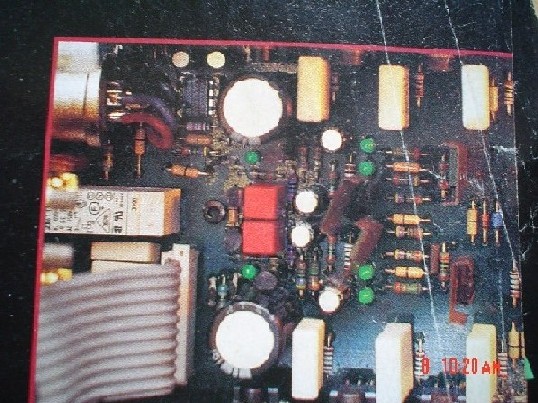

Added a picture of the German AVM Evo M3 pcb.
(OPA627 near the Neutrik, the man loved trace bridges)
The original, the M1, started as a diy design, from an article series in the German magazine Stereoplay in 1987-1988.
With a 160VA toroid the amplifier was tested at 100/180/260 in 8/4/2 Ohm.
Admitted, the PS was layed out for 0.25V ripple at 150 watts in 4 Ohm.
I can not imagine a single M1 owner complaining over lack of dynamic headroom.
The original design employed an 5534, 4 RCA Mosfets in the output stage.
(BC414/416-BC546/556-BD139/140-Drivers: BD139/140 inbetween)
The commercial units later received the OPA627 in late 92, the output changed over to 6 IRF Mosfets.
I switched the ones i built to OPA627's in April 1991, paid $60 for an OPA627 and minimum order was 10 pieces.
Reading the article on the M3 with OPA627's a few years later was no surprise.
