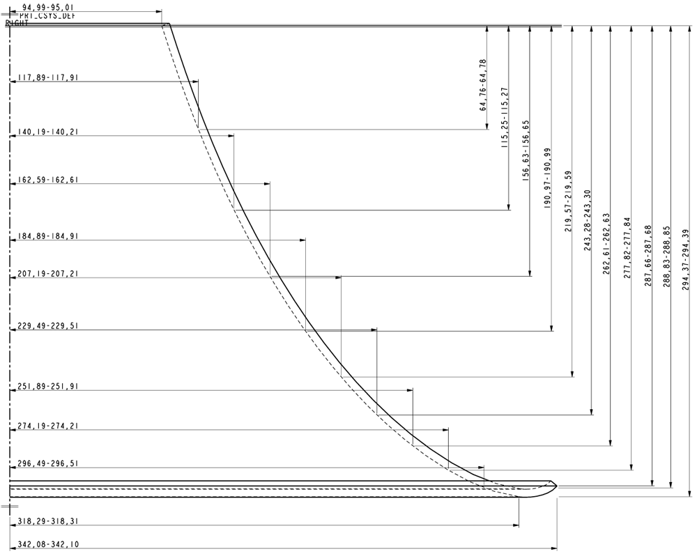

Hi everyone, and thanks again for all the comments left before.
I've spent some time researching the best way to make a front horn for what I want. I found the spreadsheet for Round tractrix horns from http://www.volvotreter.de particularly useful, hornresp also seems to agree with the figures generated by the spreadsheet.
Anyway I want a front horn to work to around 200Hz with a Fostex FE206e, and maybe later a Lowther. I've attached an engineering drawing of the horn (dimensions in mm), and as I'm new to this I wouldnt be suprised if I've overlooked something! So please let me know if what I've come up with looks like a disaster waiting to happen, or if it has some potential!
(one thing i'm slightly concerned with is the depth as I've read that deeper=warmer, and as an Oris 150 is around 40cm deep (I dont know how deep an Oris 200 is) is my depth of 29.4cm going to mean overly bright, especially with a stronger driver?)
Thanks, Richard.

the 206 will be loaded from 280 to 800 cycles. It will not be bright at all. It will be rolled off --- The best single driver I've heard in that size horn with a 1:1 throat is the 6.5" Tannoy DC - with no back chamber they go from 250 to 20k and sound excellent. Not too sensitive and not capable of very high output but very, very good sounding
Thanks for your reply. Rolled off is what I was expecting, but I intend to use a seperate bass enclosure. I would've liked to get to 200Hz, or at least near to that. Is 280 cycles where you think useful output stops? My Horn is larger than an Oris 200 I think...
The 206 in my 180 Hz round tractrix horns 1:1 throat went to just under 300 Hz. Rolled off meaning above 800 Hz. The driver is way too weak to drive the front horn in the upper midrange and treble . I used many different size back chambers and the smaller the better but still too weak - "mass rolloff" - a Lowther wou be better suited.
Hmmm, were you dissapointed with your results then? How rolled off, do you use a seperate tweeter? How do people get away with using a 206 in an Oris horn then, surely they have no treble aswell? How steep is the roll off at the bottom end?
I guess some people just like that kind of sound - I gave the drivers to my brother-in-law. He uses them with no horn and a sub.

I must add I used no phase plug - surely that would make a big difference in the highs. PS- I''m still a seperate 'tweeter' type of guy - whizzers either sound rolled off or 'fake' to me. I've found a good horn loaded dual concentric is much more to my taste
