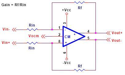

Hi Doug
See this so u can get familiar with feedback
After this we will have something for u.
hope that it helps
