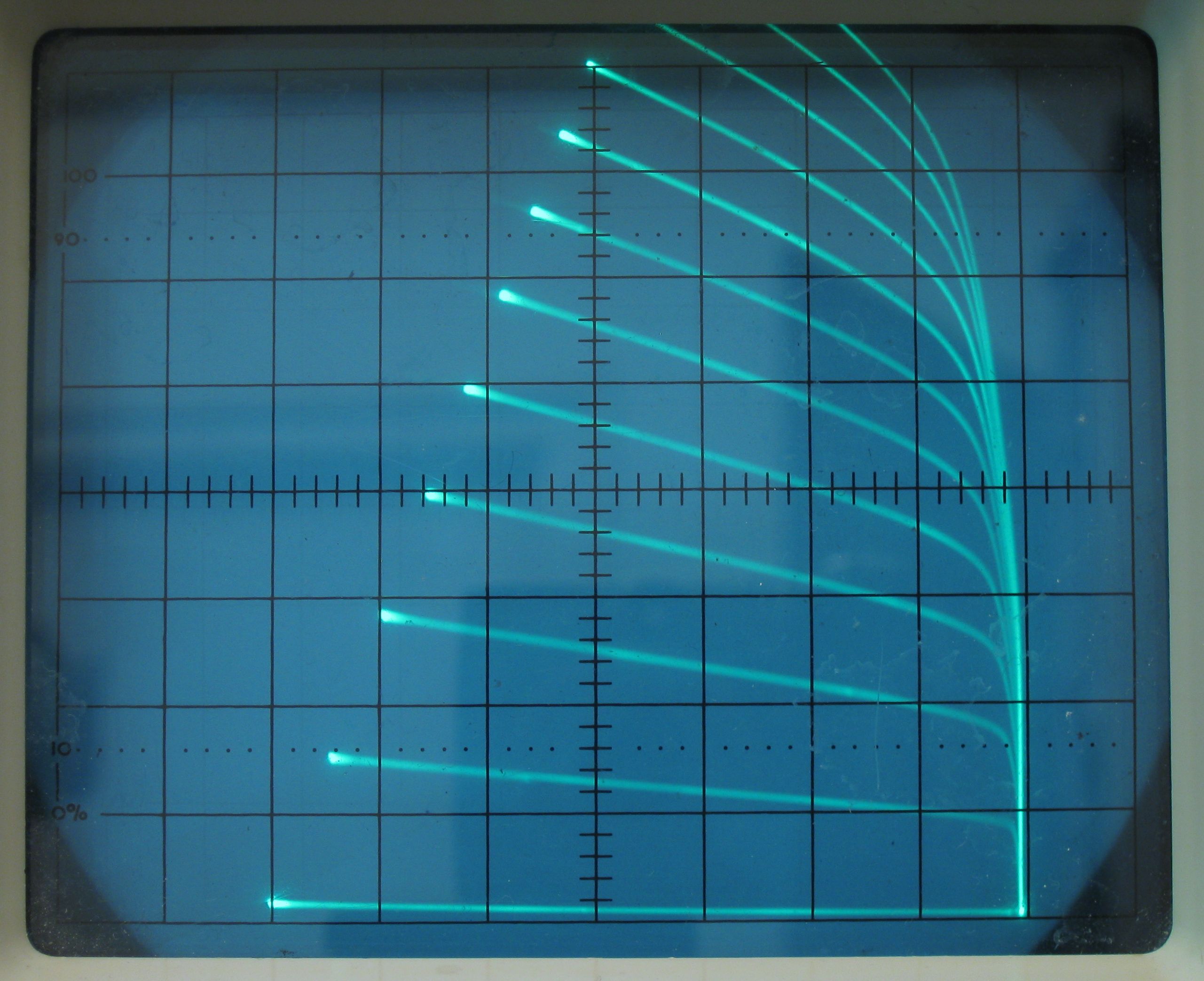

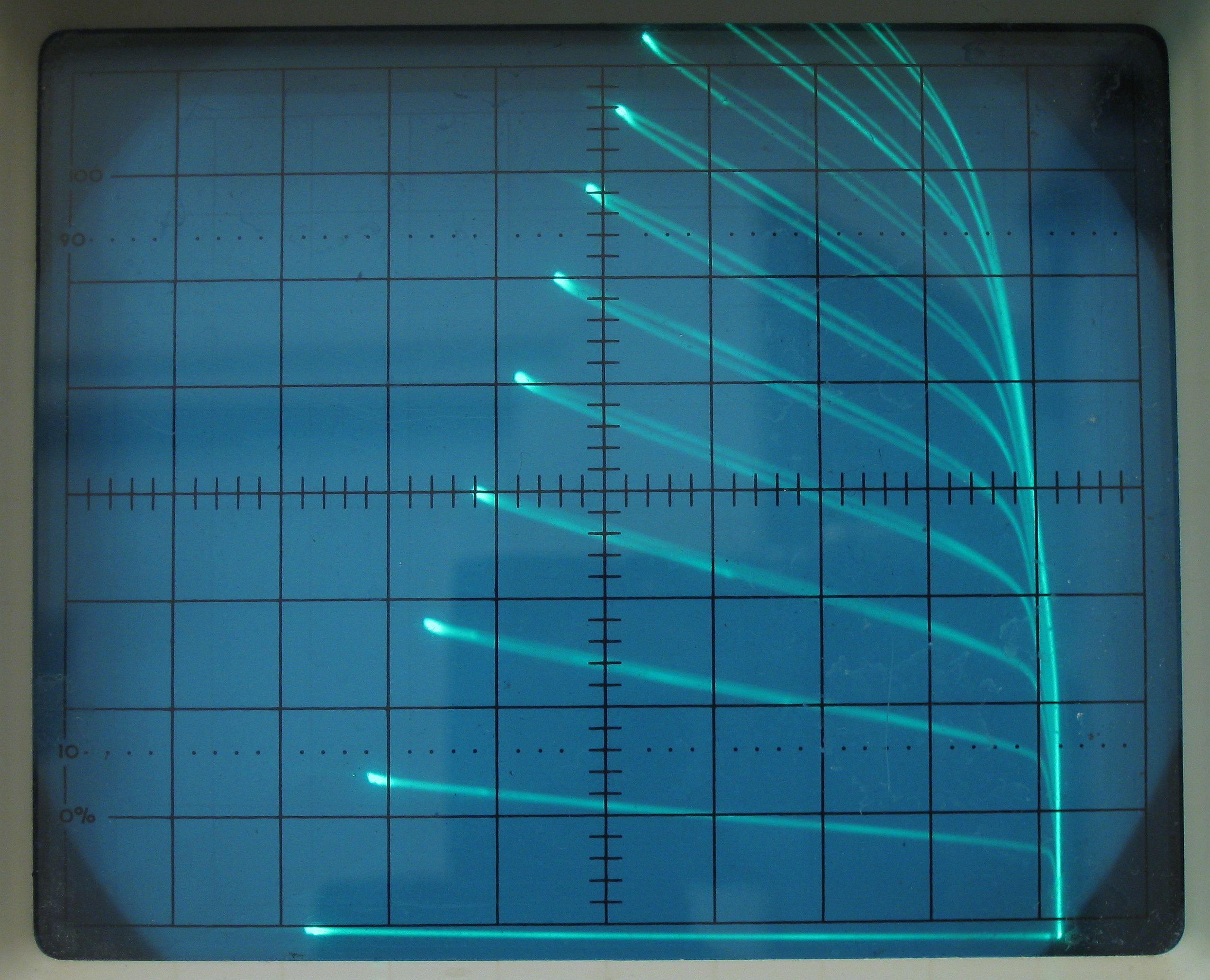

A simple solitary BJT shows thermal effects when examining in a curve tracer. See attached On-Semi BC560C and original non-fake(!) Hitachi 2SA1081 BJT photos that I've taken about a decade ago. You should see a straight line, but a loop is visible on BC560C. Same setup, same load but no loop on 2SA1081.
Thermal coupling is inherent in BJTs, FETs even in tubes. The 2SA1081 is far better here.

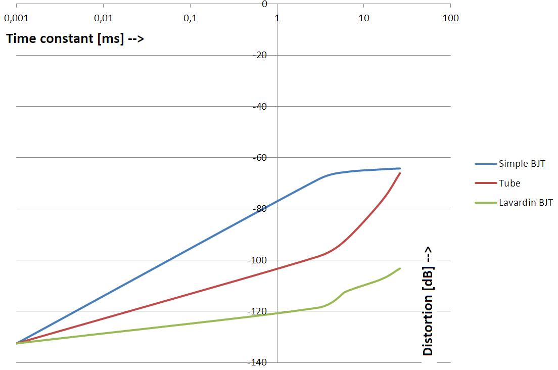

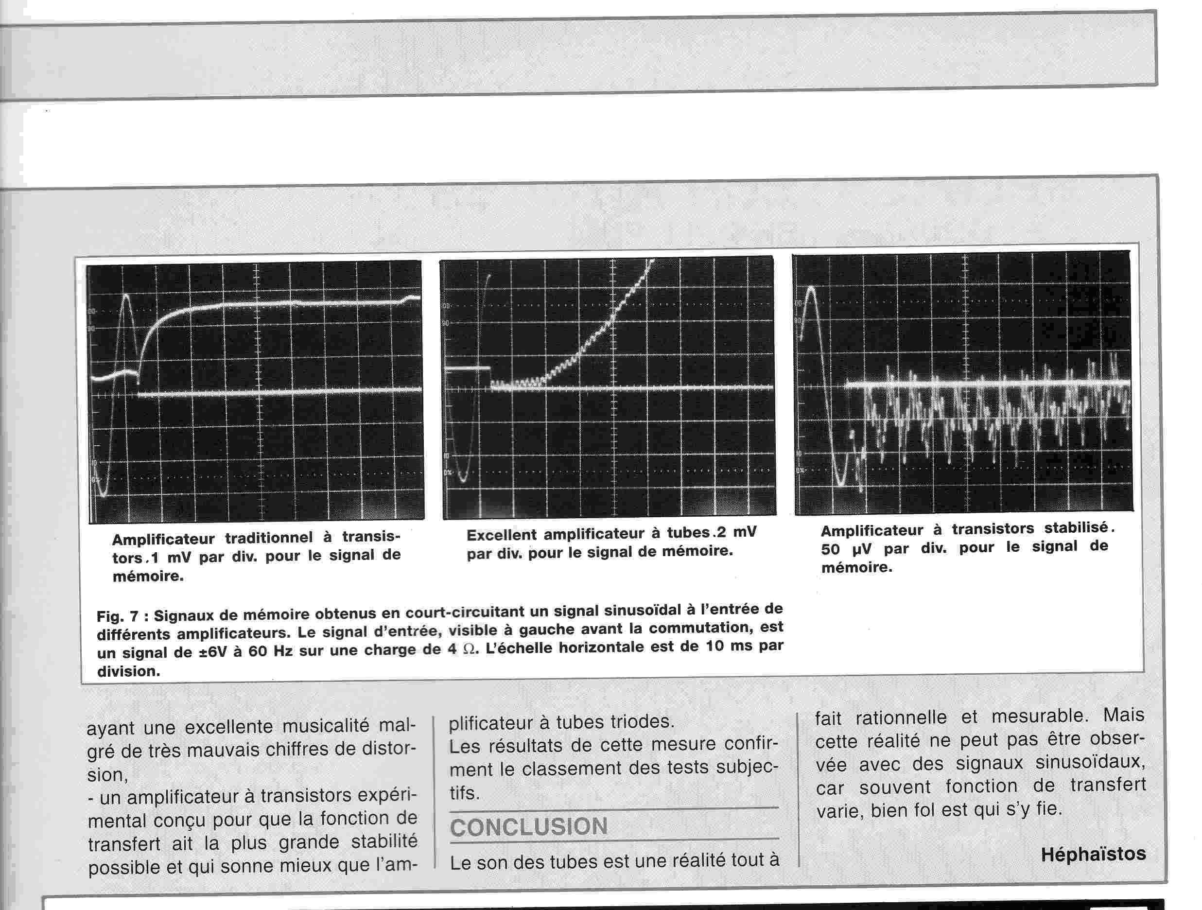

What it has not been stated above about Perrot is that, at the end of his famous writings in "L'Audiophile", he proved to be unable to show that a standard amplifier with NFB suffers from thermal distorsion.
Attached Perrot's measurements results that shows that a standard amplifier with NFB suffers from thermal distorsion: Comparing a simple BJT, a tube and a low thermal BJT amplifier.
Please note: vertical sensitivities are 1mV/div, 2mV/div and 50µV/div.
Included an own made time constant vs distortion diagram to understand more easily the measurement results.
"Conclusion - The sound of the tubes is a completely rational and measurable reality. But this reality cannot be observed with sinusoidal signals, because often transfer function varies, well crazy is who relies on it." ... who relies on non interrupted constant sinusoidal signals like THD, IMD, TIM and DIM measurements. These signals are series of sinus signals and not shows the thermal distortion of amplifiers. With these signals the amplifier is in a non-changing state after a few seconds from a thermal point of view.
