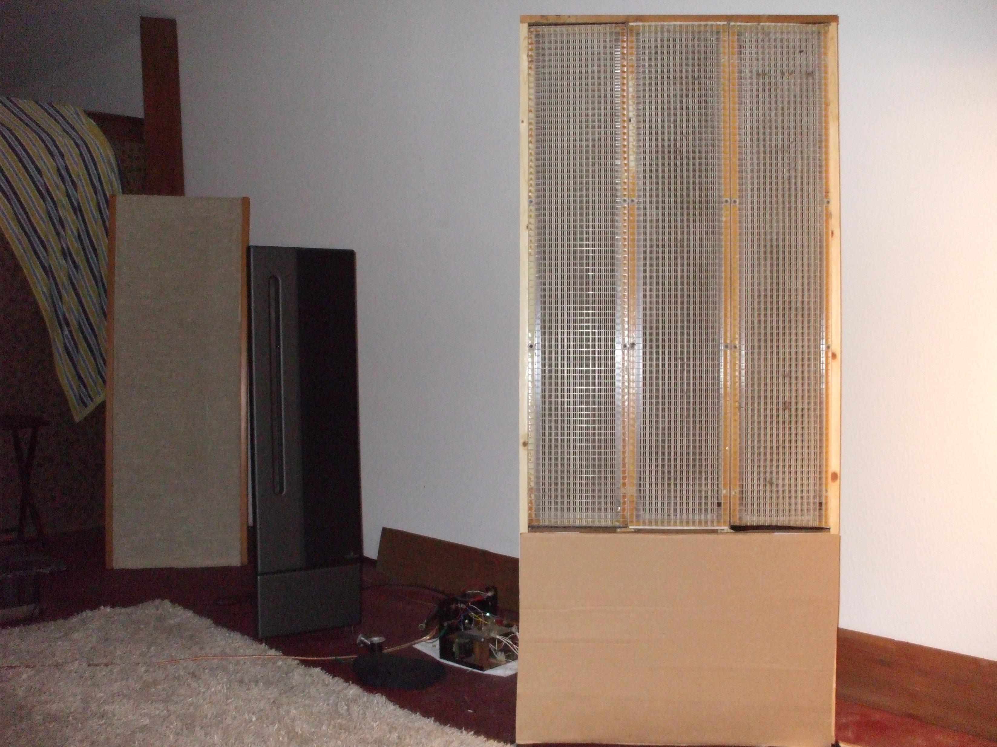

After 30 years of With Acoustats an any other ESL i could get my hands on.....My Acoustat setup to day is 3ea 9" panels Flat 15" off the floor...an yes the sound is the best i have had yet....
Sure i have ML an the 9" an 12" wide panels are Fun but...It like surround sround all the time....hehe... i can see were some think this is a good thing...
Till thay hear a good flat speaker .....like old quad 57s... Apogee ribbons...even Magenpans....All flat....down side a 1/2 movement can make these flat panels sound diff.....got get them setup right...in a good room...
Acoustats...most say that there best speaker... is the 1+1...
But the wider ones have better mids an bass....Thats why i went with a 3panel wide Flat....so i dont get the small sweet spot .... Roger Sanders has go it right..
Hell any bose speaker an a $100. Surround recever well give big unreal sound... that i have even heard out of Soundlab ESLs....thats is if you can get a Amp to drive them hehe.............
